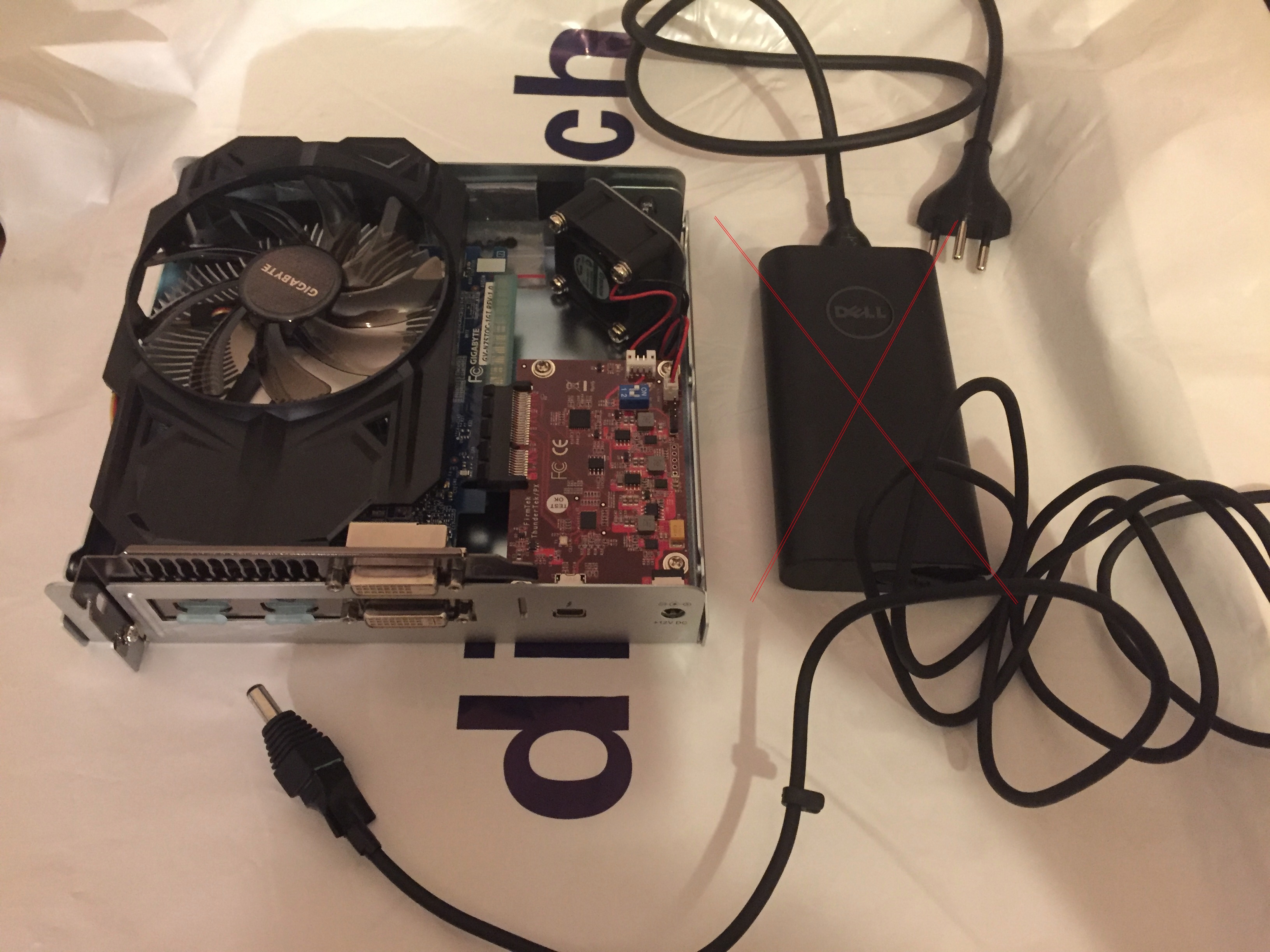

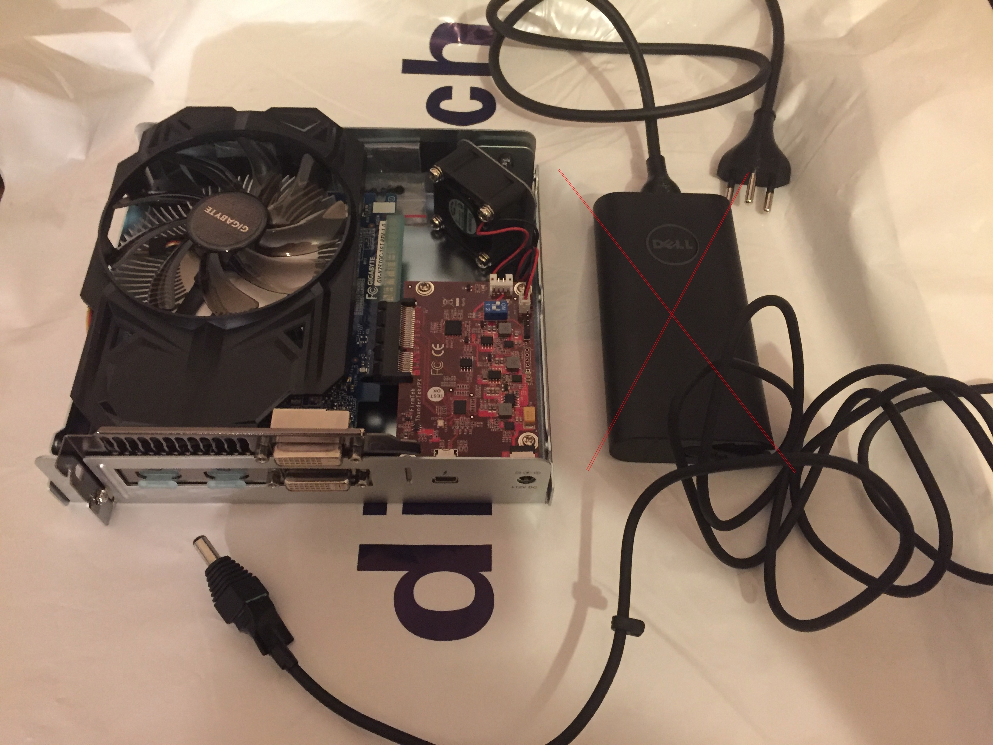

Presenting a small and portable eGPU. GTX 750 Ti in a Thundertek/PX with a 90 Watt Dell laptop PSU.
Update 2016.06.10: Ok, I fried the Thundertek/PX board and a GT 630 card, both broken. Definitively do not use the Thundertek/PX with a external Laptop PSU. Use instead the workaround with a powered riser cable as shown on the first page on this thread!
I bought the Thundertek/PX two years ago because I own only Thunderbolt 1 Macs. Until now (Macbook Pro 2012 and Mac Mini 2012).

I considered buying an Akitio, nice case. But I already have the Thundertek/PX. And as it appears, in the long term, I will skip Thunderbolt 2 and go directly to Thunderbolt 3 when it's time, e.g. Razer core if it's compatible with future Macs.

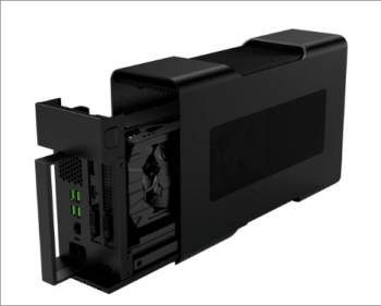

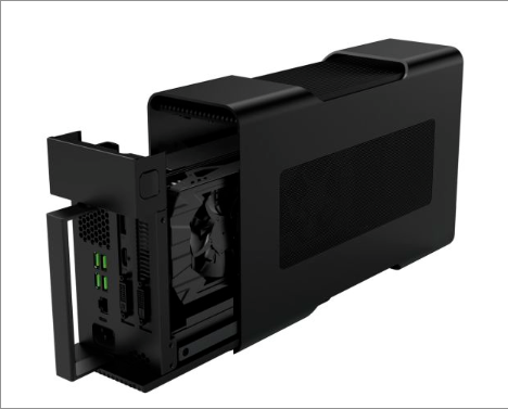

Update 11.11.2016: The Razer Core does NOT work with the new Macbook Pro 2016! http://forum.netkas.org/index.php/topic,11654.0.html
