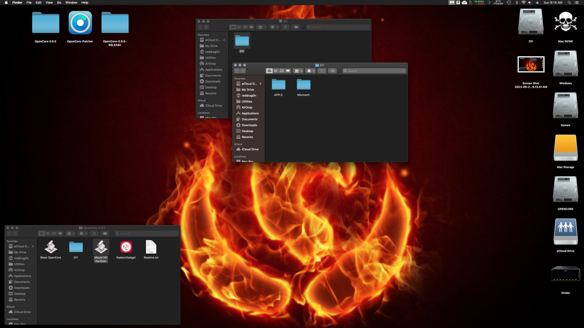

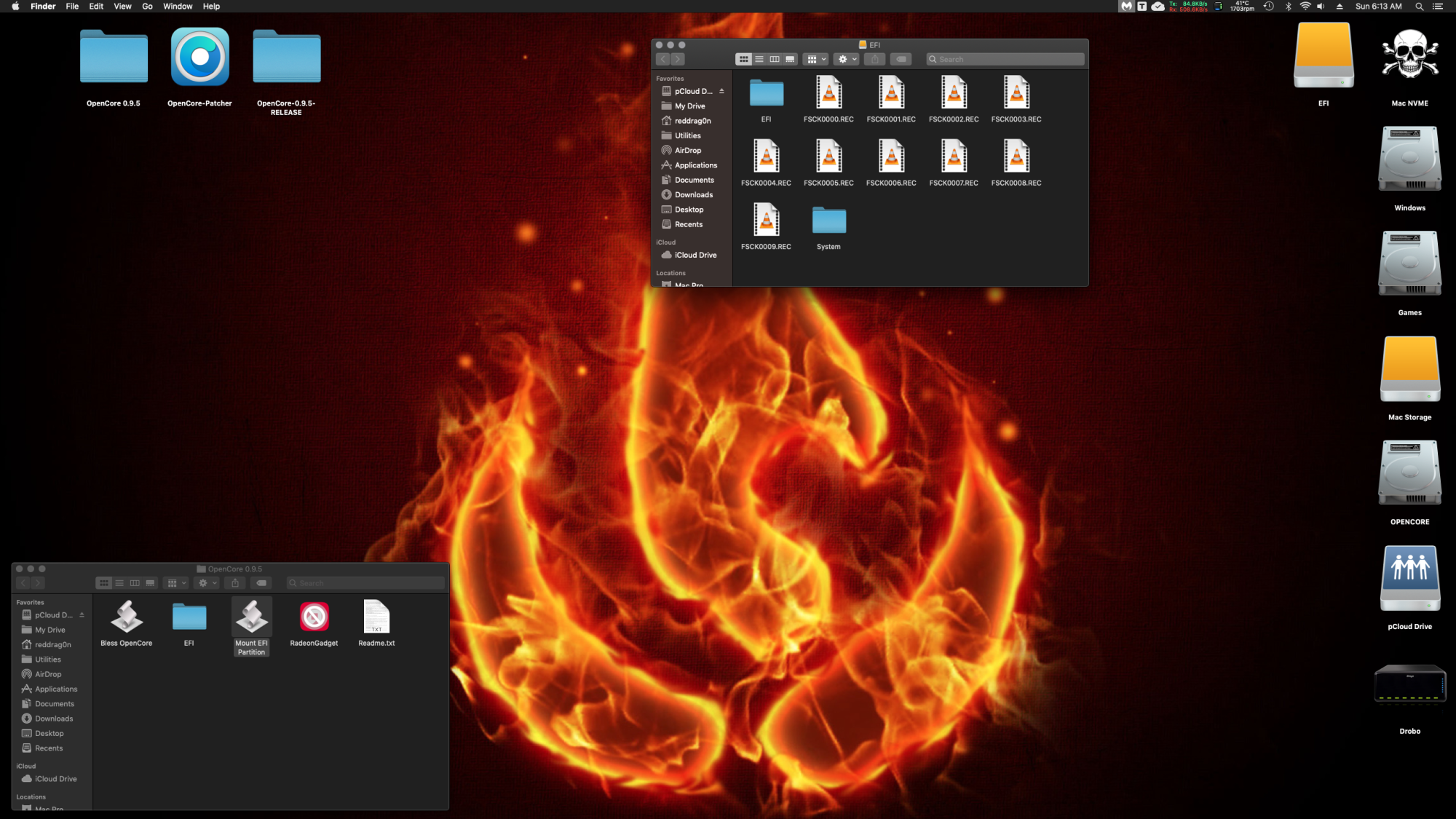

here are some screencaps of what the drives were originally. first one is mac efi, second one is windows, it says efi which throws me off
as for the opencore drive itself on the desktop, that's the 128gb ssd i just installed less than an hour ago to see if i can fix whatever the hell i didi

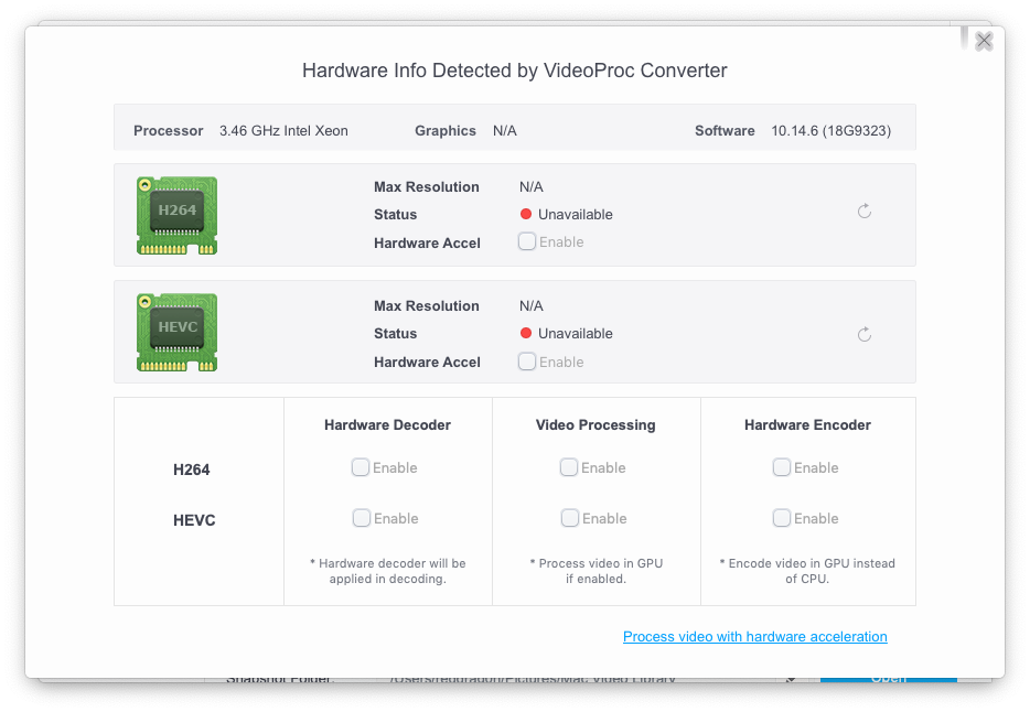

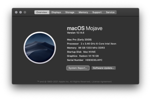

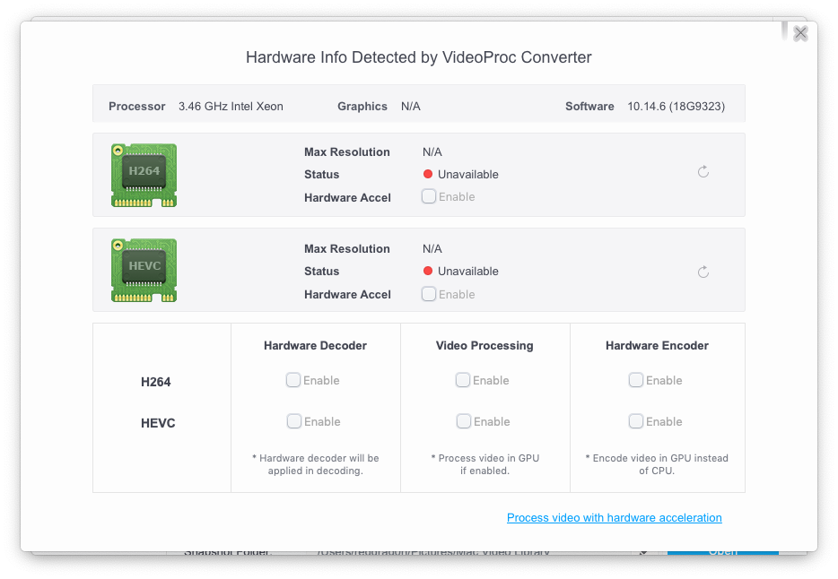

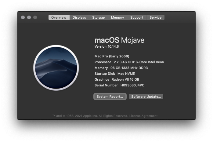

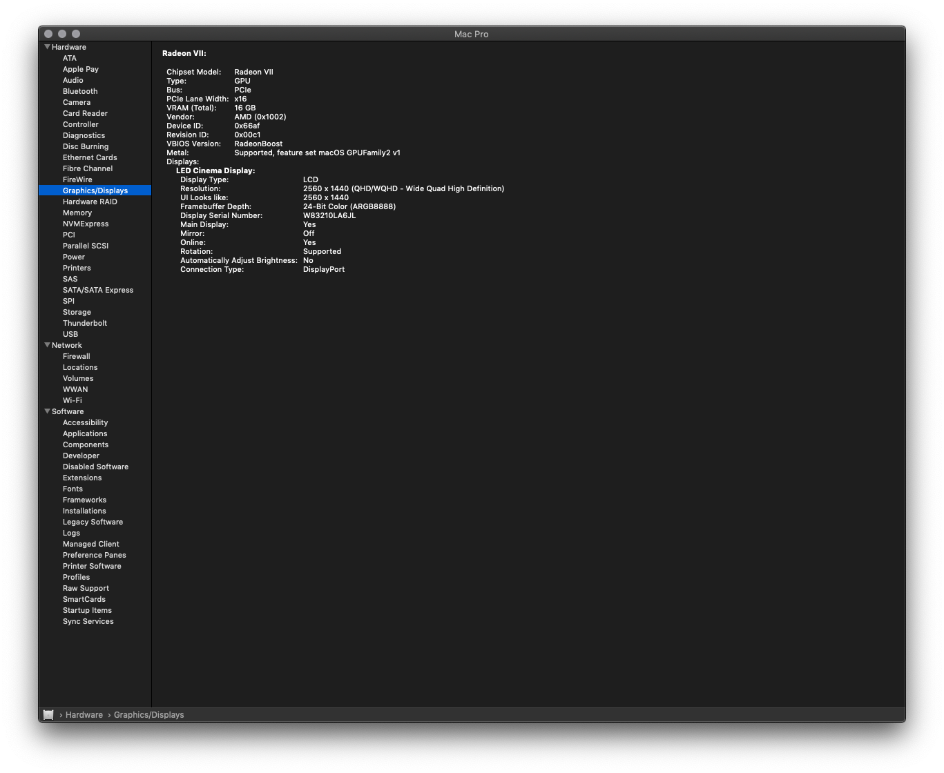

so i ran the videoprog program and it doesn't see my video card at all. osx does but nothing elseScreen Shot 2023-09-24 at 7.16.38 AM.pngScreen Shot 2023-09-24 at 7.16.48 AM.pngScreen Shot 2023-09-24 at 7.16.55 AM.png
after playing around with the hevc update given in the thread, found out those files were old and killed my system yet again. reinstalled opencore, blessed the crap out of it and checked the versions of the lilu and whatevergreen files and found out opencore 0.9.5 has more updated versions of them already installed.
so i ran the videoprog program and it doesn't see my video card at all. osx does but nothing elseView attachment 2279354View attachment 2279355View attachment 2279356
