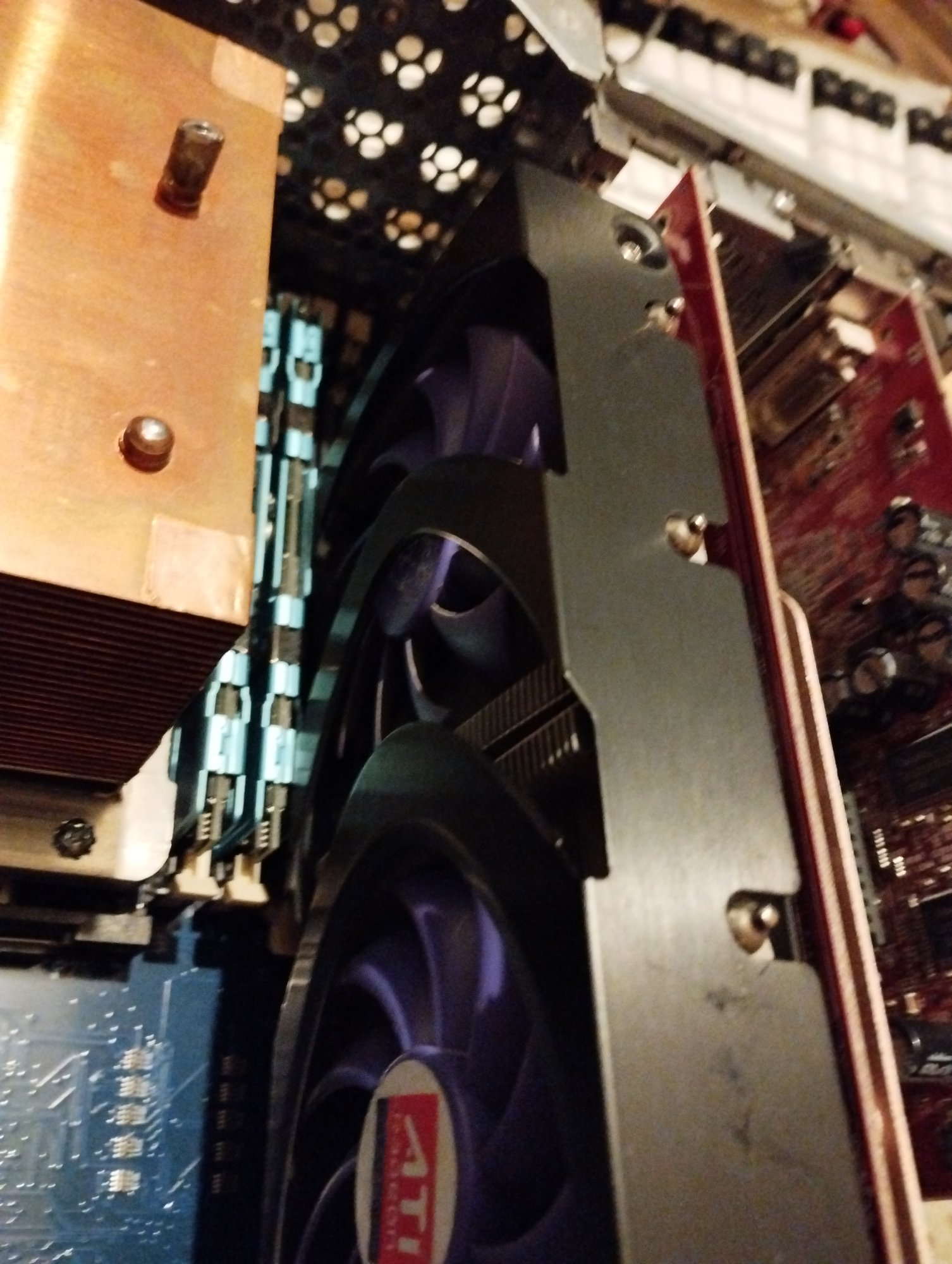

Well, the card arrived today and I have verified it works fine and cool in a regular PC: very very strange card with a Peltier cell between the GPU and the heatsink. The side thickness, as can be seen in the attached photo, interfere with the first two RAM sockets but putting the 1Gb RAM sticks closer to the CPU allows the Radeon and the RAM to take their own place even if they are almost in touch each other.

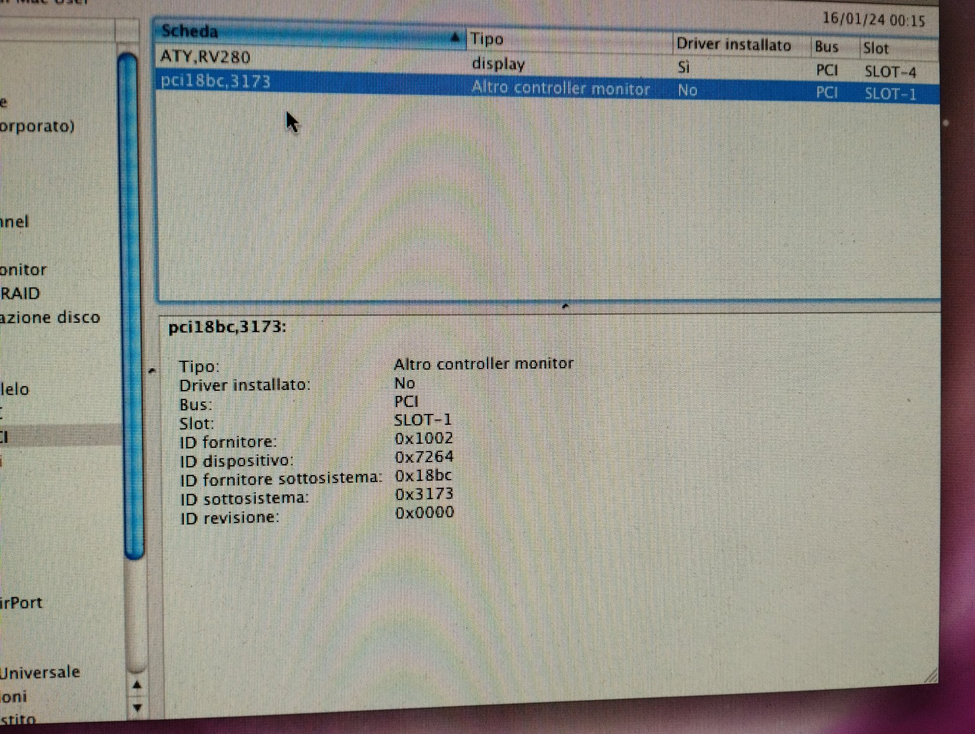

After taping the usual pins 3 & 11 on the AGP connector with a Kapton foil I have plugged it in my MDD along a Mac Edition 9200 PCI and this is what the system (10.5.8) is seeing (still the PC firmware inside):
At this point I am open to any suggestion about the ROM editing, I confirm that this particular card is equipped with an R580 GPU just like the X1900GT Mac Edition (GPU-Z info).

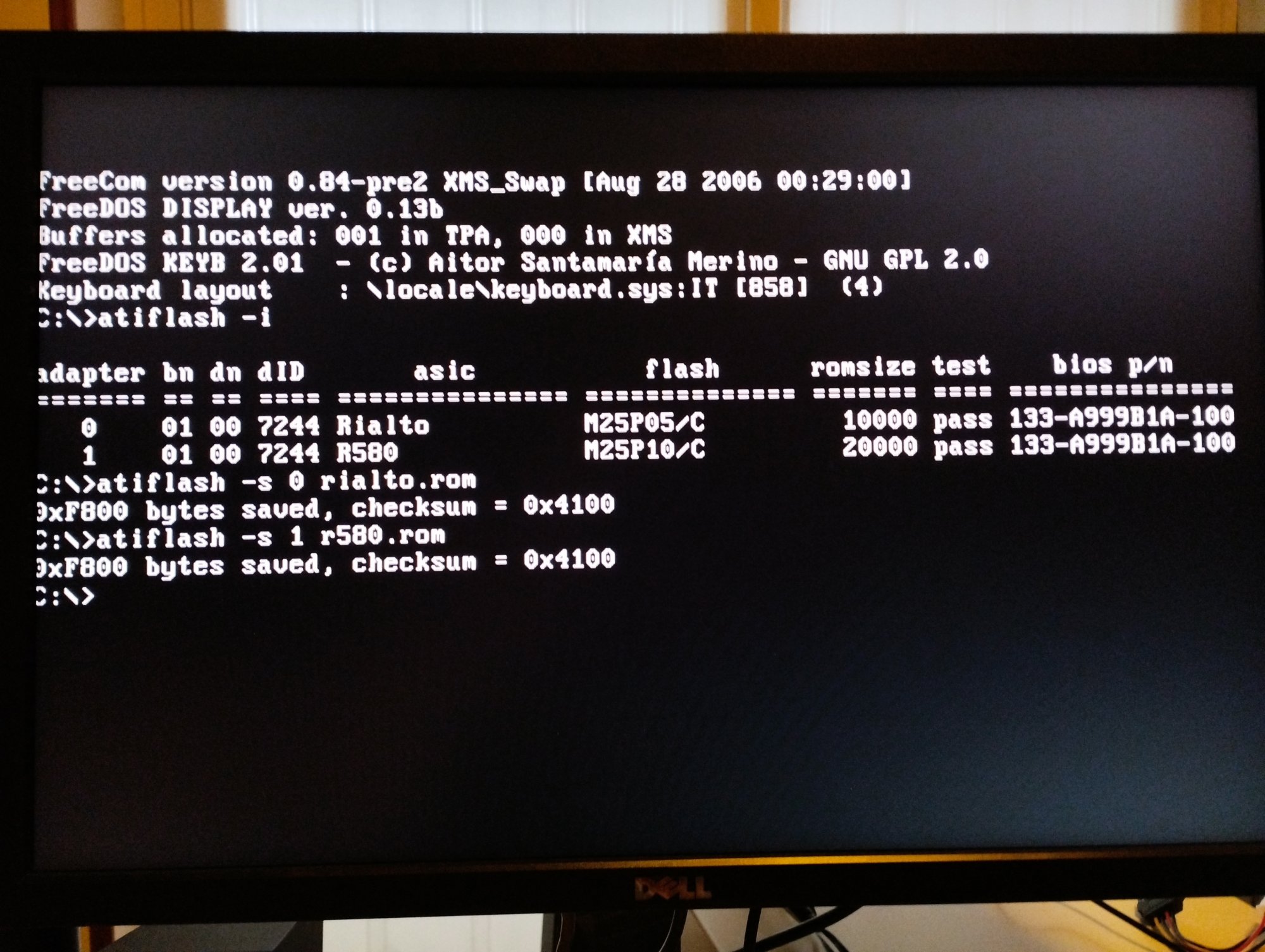

Well, this was a bit unexpected: Atiflash reports TWO eeproms on this card, different in size. I have dumped both of them and comparing the two files with HexFiend the content is identical, 64 kb size. Should I proceed in flashing both?
It is, indeed, and it make sense since the R580 was targeted to PCIe only however I've never seen a specific firmware for a bridge. My dumb guess is that device "0" is the one the system use in reality while the "1" in list is there for backup purposes only.

No luck, sadly. I have either flashed the card with the stock X1900GT Mac firmware (0210 4072) or with the one modified to match the card Device ID (0210 4472) and no bootscreen at all, also connecting the monitor to the 9200 PCI the System Info show no more cards on slot 0, like it is disappeared. In the end I reflashed back the card to its original PC firmware and for now I will keep it as is, clearly the conversion method MacElite explain for the nVidia cards does not apply to the ATI ones.
