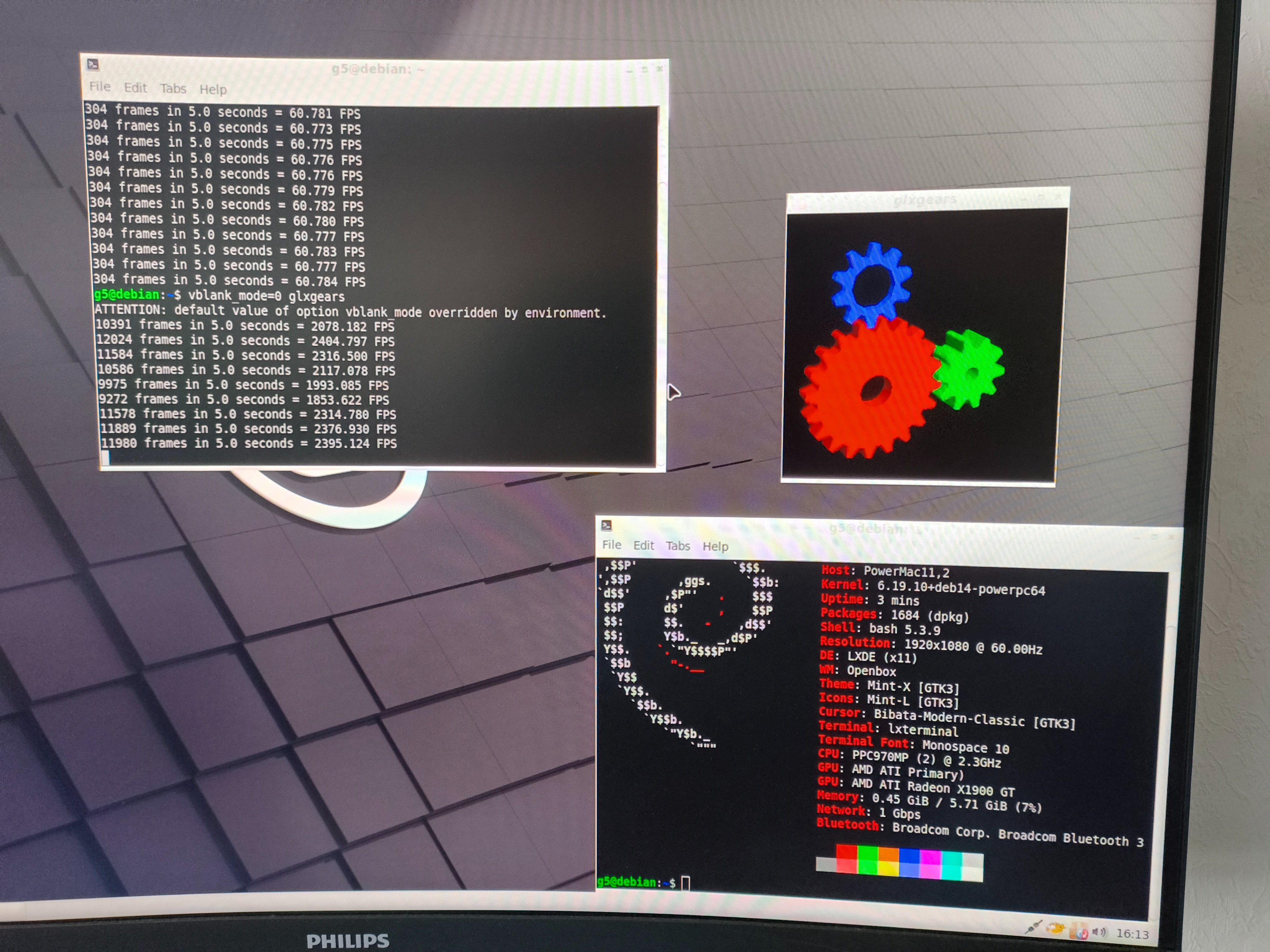

Here's a ROM dump from an original PC x1900GT. This card is the original rev 1 version that physically looks just like the retail Mac Edition card, not the rev 2 version of the card that seems to be pretty common on the used market. It has a 64KB ROM chip. When flashed with the Mac Edition ROM, the card works properly in my G5. Quiet fans and all.
Reactions: Matias_
The AtomBIOS is nearly 64K by itself. The fcode is over 32K. The fcode does not contain a classic Mac OS driver or a Mac OS X driver. Compression can only reduce the fcode to ≈54%. There's no way to compress the fcode to fit in the unused 2K of the 64K ROM chip.
You need a 128K ROM chip to fit both the AtomBIOS and the fcode.
If someone has a flashable 128K ROM chip, then I can make the combined ROM image.
Reactions: Matias_ and eastone
I'd be willing to swap in a larger (128K) flash ROM onto my card for testing. I'm pretty comfortable doing that sort of rework.
Will the Radeon X1900 GT recognize a new flash ROM and detect the new size?
The attached contains a new rom, "Radeon X1900 GT PC & Mac.rom" (97 KiB), which combines the PC ROM you gave me, "Sapphire_x1900_PC.rom", with the Mac ROM, "Radeon X1900 GT rev 109.rom", which I hope is the Mac ROM that works for you (is there more than one Mac ROM?).
If this doesn't work in PC, then maybe I need to fix the checksum of the BIOS image.

Thanks for piecing that together. I have a larger flashrom chip on order. I can try this in a few days.
I fixed the checksum for completeness, and just in case.
I flashed the x1900gt card with your double rom. The card works in the PC, but in the G5 it gives a black screen.
PS
Of course it works under MintPPC in G5 🙂
Does your x1900gt have a 128K ROM chip?
Can you read the flashed ROM and compare with the source ROM to make sure it was all written?
In the G5, does the GPU appear in the Open Firmware device tree? Properties?
OK,
The EEPROM on my card is an M25P10 (128 KB).
Both ROMs—the one source rom and the backup from flashed—contain the same data, except for the empty padding up to the full 128 KB ROM size.
I am attaching both ROM files for verification.
The X1900 is visible in Open Firmware (I’ve attached a photo).

OK,
Can you connect with telnet and get result of dump-device-tree?
https://forums.macrumors.com/thread...l-work-in-a-beige-power-macintosh-g3.2303689/
Do you have a PC or Mac x1900GT?
Can you post the backup of the original PC BIOS?
Did you flash the card with Mac firmware previously? Can you post a copy of Mac firmware that you used?
I'm at work right now, I will use telnet connection today after work. I have 2 different models of PC x1900GT cards. Unfortunately I don't have an original PC ROM files anymore. Mac ROM was taken from themacelite downloads and card with mac rom is working well.
Connect your second PC x1900GT card and get dump-device-tree from that. It might be a more suitable match with the Apple firmware?
The problem with the your first PC X1900GT or with the PC & Mac ROM that you applied to your card is that the PC firmware has device IDs that don't match the Mac firmware.
Mac firmware has device ID 7240.
PC firmware has device ID 724B and a secondary function with device ID 726B.
I've attach a new combined firmware where the Mac firmware comes first.
dump-device-tree with this new ROM.
Does it allow the card to work in Mac OS X?
Does the card still work in MintPPC?
If it doesn't work in the latter, then we can try changing device IDs in one of the firmwares to match the device IDs in the other firmware.
