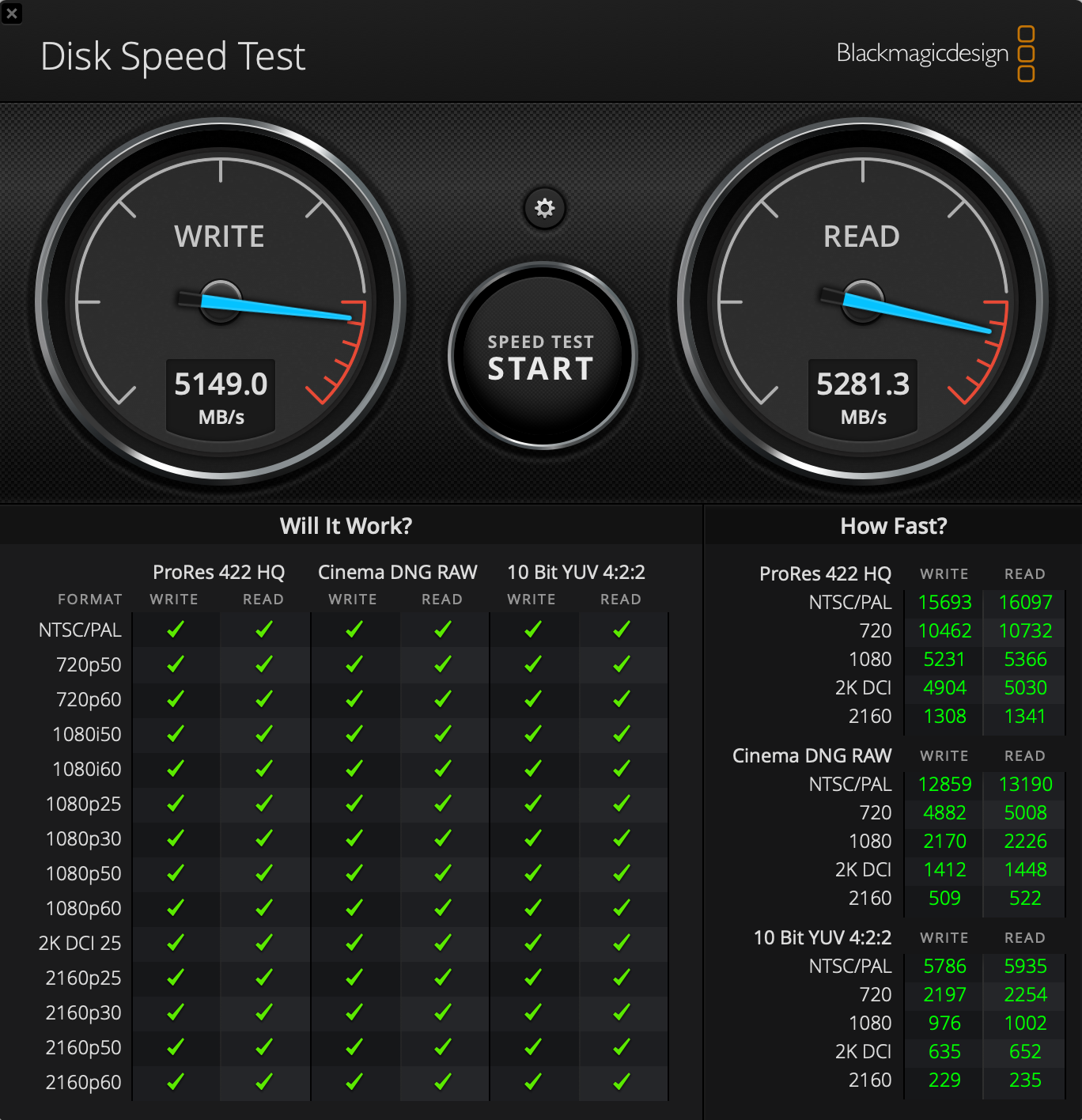

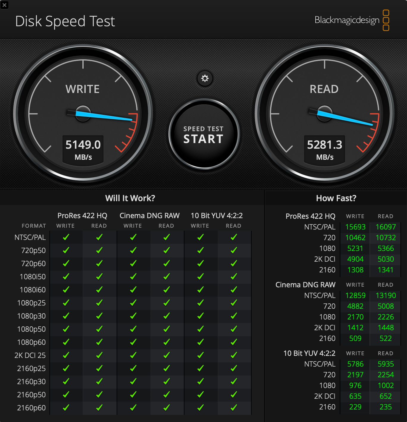

I just installed this PCI Card last night in PCI Slot #4 of my 2019 Mac Pro:
I mounted (4) Samsung 1TB 970 EVO Plus NVMe M.2 modules to it.

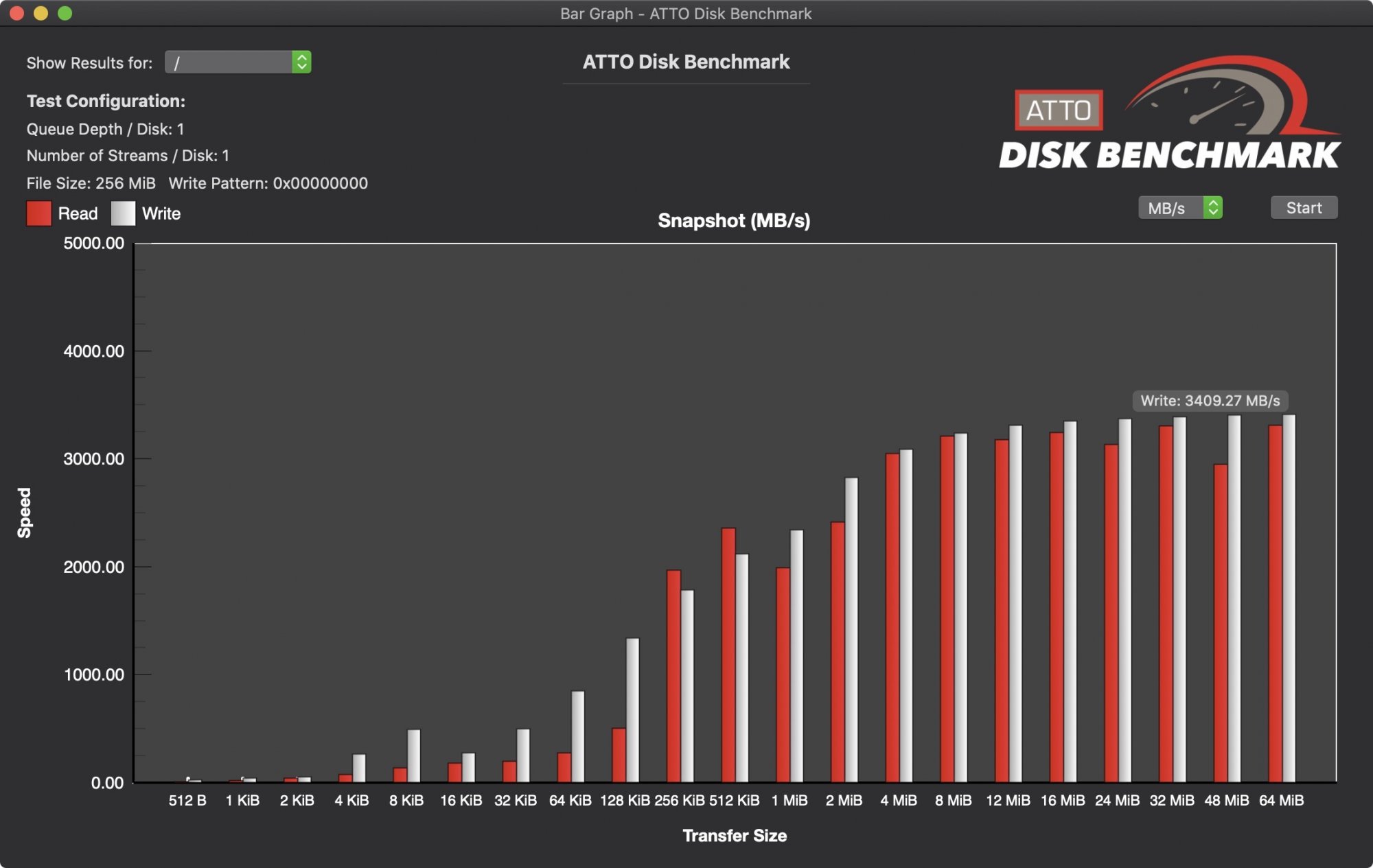

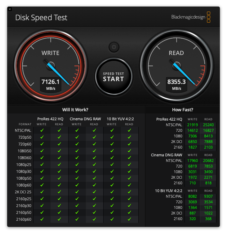

Here is a Black Magic Speed Test on one of the NVMe sticks before I configured them together as RAID 0 with Disk Utility (all four modules performed equally well):

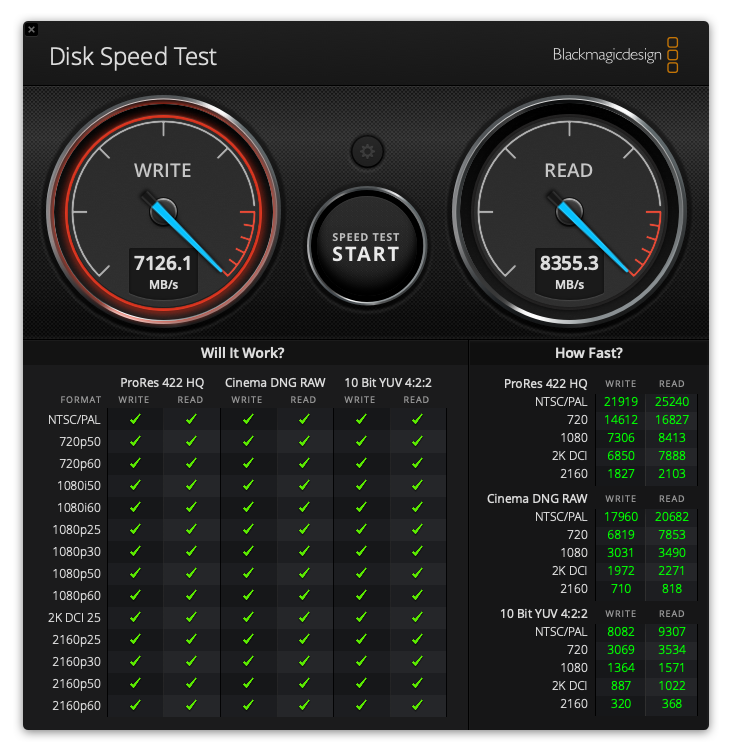

After configuring all 4 as RAID 0 - this is what I am getting:
Sonnet advertises that I should be getting about 11,700 (theoretical read/write). Any idea why I would be getting substantially less?

I believe Sonnet advertises an aggregate 11,700 on all 4 blades, but not in RAID0. As far as I know Highpoint is faster and may, or may not, have possible upside and downside. I just purchased the Sonnet because I've been using their hardware for All Eternity and haven't ever had any problems with it. It's always extremely stable and works as expected.
Also my use case often involves many small files, at which point the Amazing Speed Advantage of all SSDs kinda grinds to a halt as there really isn't a perceptible subjective difference between Apple's SSDs and Sonnet going 2-3x faster. The only thing that's winning in this space I'm aware of at the moment is Intel Optane.
The knowledge-base of @tsialex and what's inside his brain, could probably provide much better insights 🙂
Reactions: choreo
Thanks for the replies... looks like I am in the ballpark!
If you were to take the card and drop it into a Hackintosh with a true x16 slot, one would expect to see around 12k MB/s. The Sonnet and Highpoint cards use the same PCIe switch. Unfortunately it looks like the Mac Pro / Apple Tax is hitting NVMe raid performance.

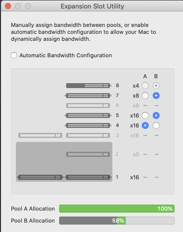

By design.. The 7,1 has 2 Pools of only 16 PCIe3 lanes. Pool A and B.
With a GPU in Pool A. Only 8 PCIe lanes are available if the GPU is dropped down to x8.
In Pool B, the thunderbolt I/O card uses 4 PCIe lanes and cannot be moved to Pool A.
If your Sonnet card is in Pool B. It's likely running at an x8 electrical connection. :-( Interrogating the PCIe bus with PCI tools should provide insight as to why a $6000+ 7,1 Mac Pro is running the NVMe Raid at the same speed as a 10 year old 5,1 Mac Pro.

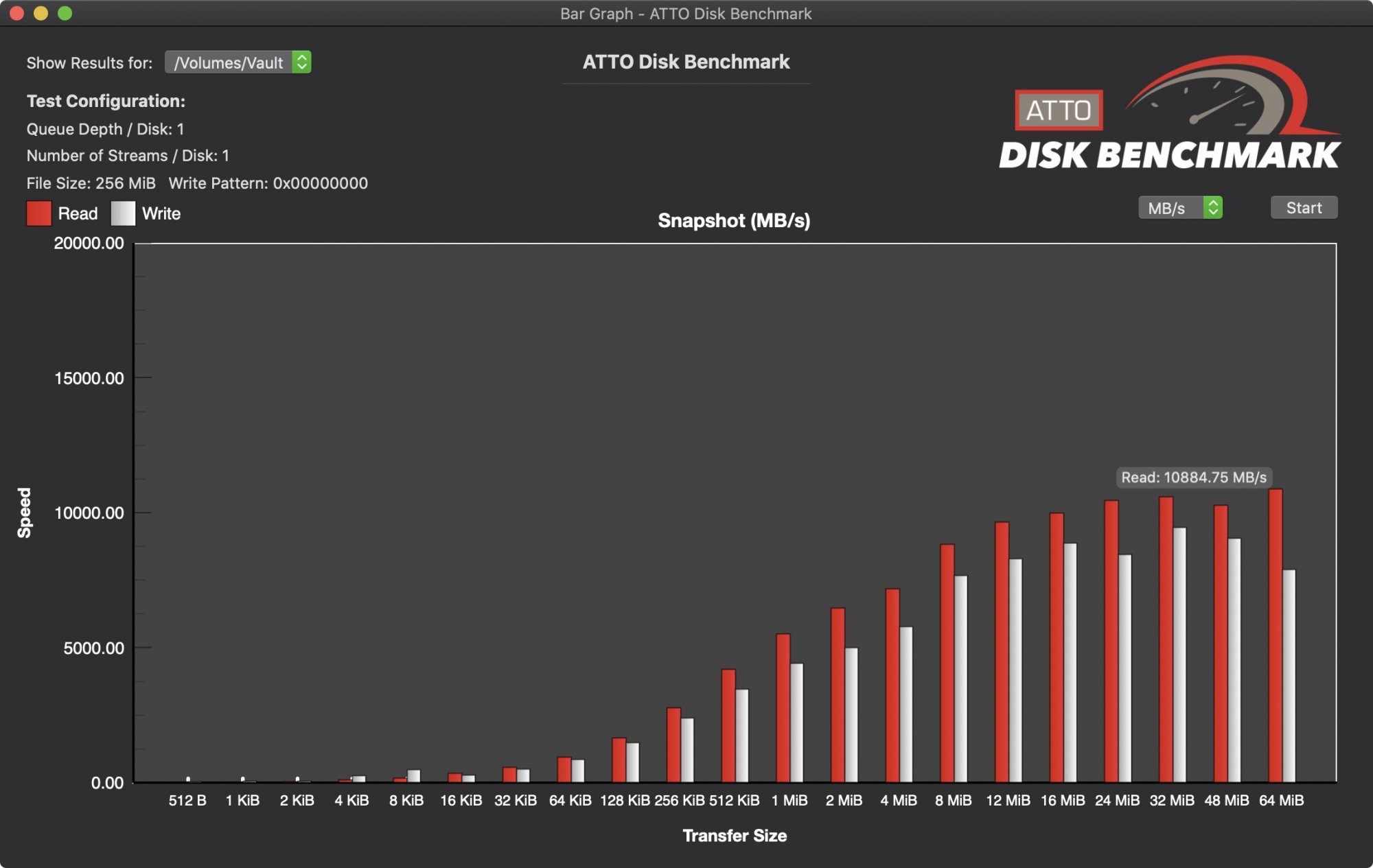

screenshot-2020-01-13-at-16-36-25-png.888327
Although my math aligns with the reported performance, hopefully I'm wrong the 7,1 architecture is not that limited.
Reactions: choreo
Your speeds seem much faster than Choreo reported....
Is there a reason?

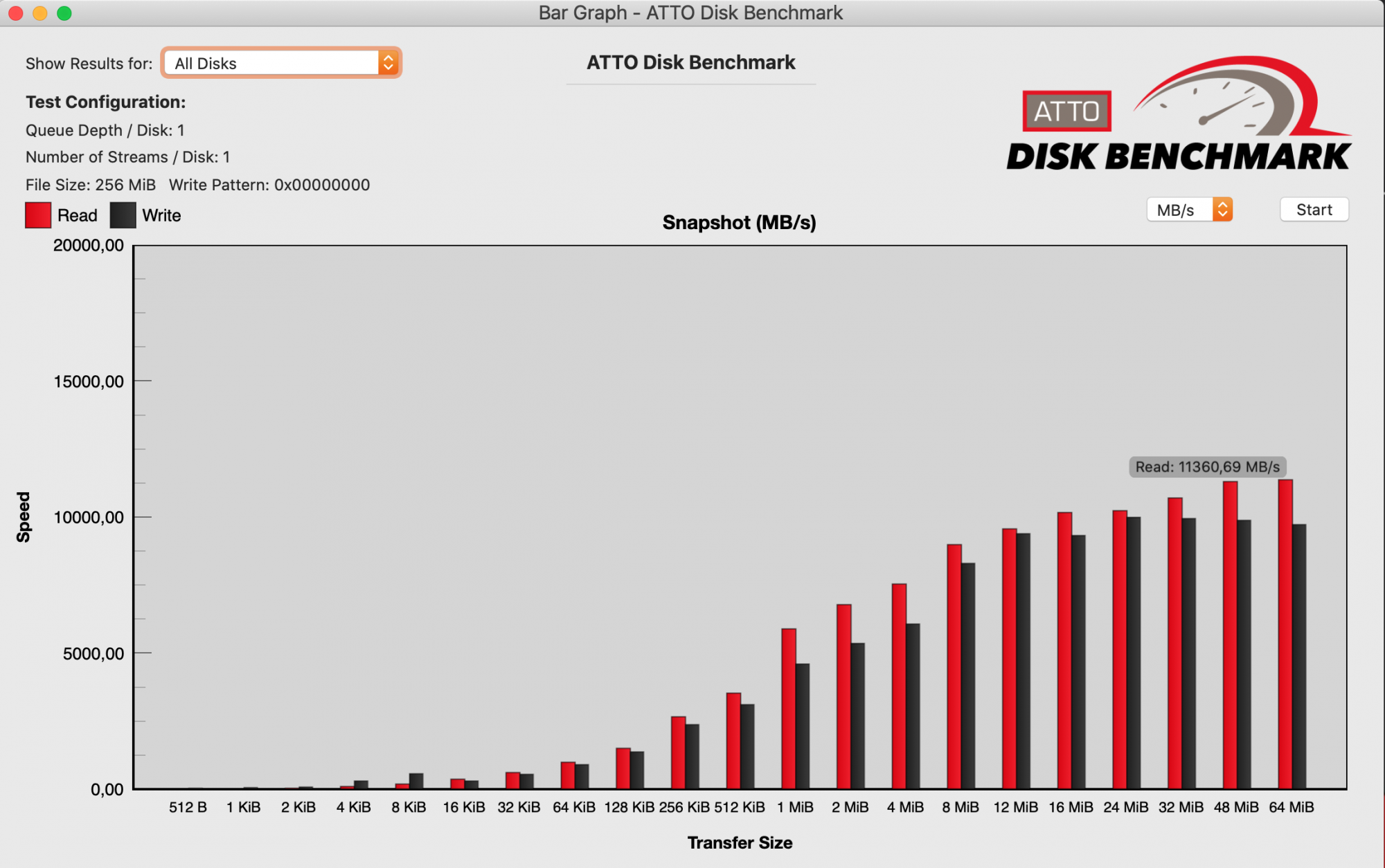

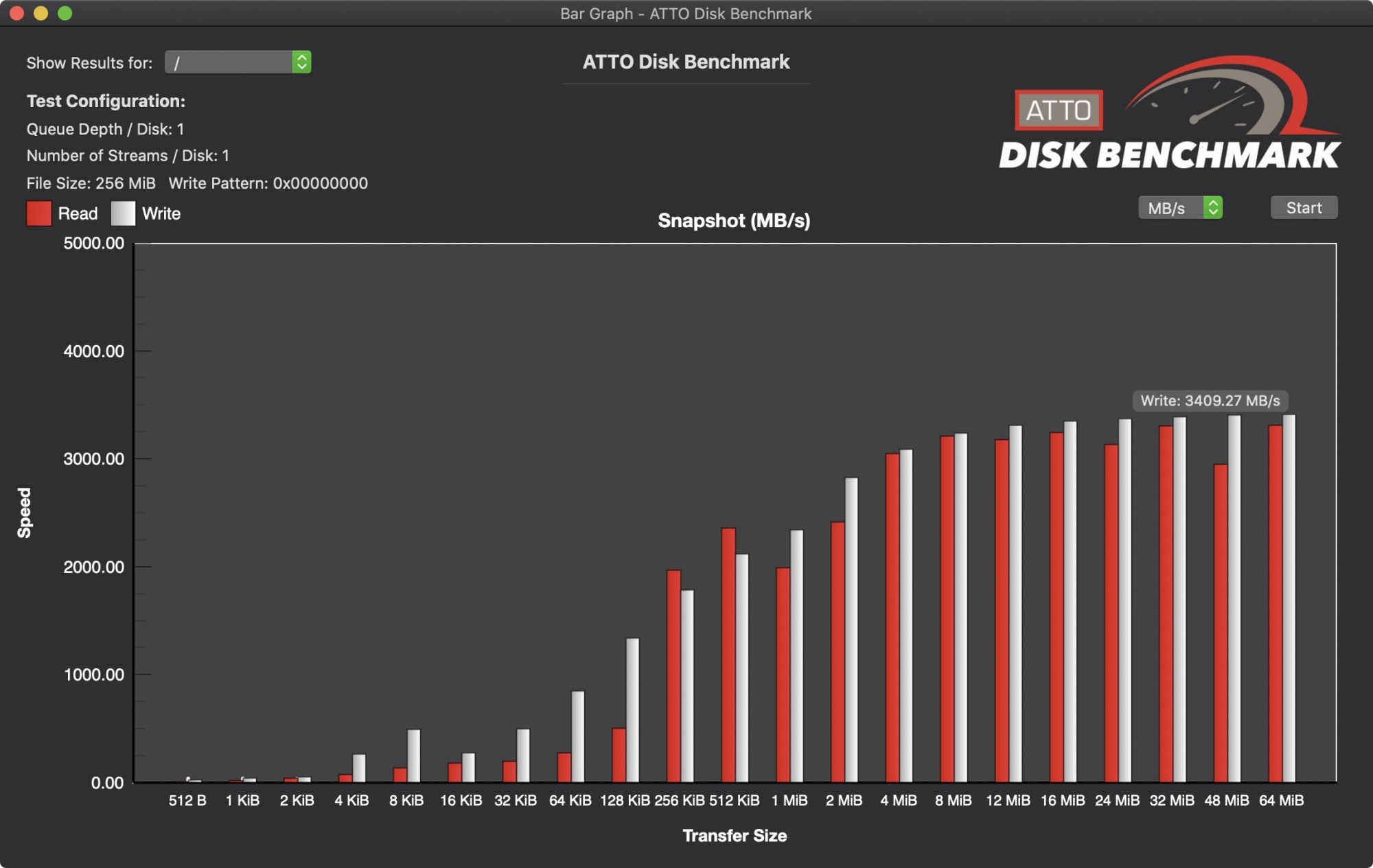

Yes, I'm running ATTO benchmark across spectrum of multiple filesizes showing R/W speeds, vs. Hitting the Big Button on default test for BlackMagic (for which my results are pretty much same as everybody else in this thread, above).
For large files it's hitting about 11k MB/s read. If planets aligned, ideal situation occurs, and everything is perfect, RAID0 is coming very close to claimed 11.7K theoretical max for Sonnet.

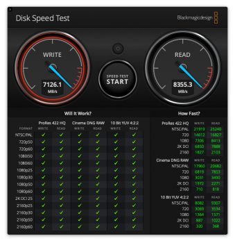

FYI my result with the Sonnet Silent and 4x 970evo 1TB RAID0. Max read speed is close the max as advertised.
BTW the card doesn't include a license for SoftRAID.

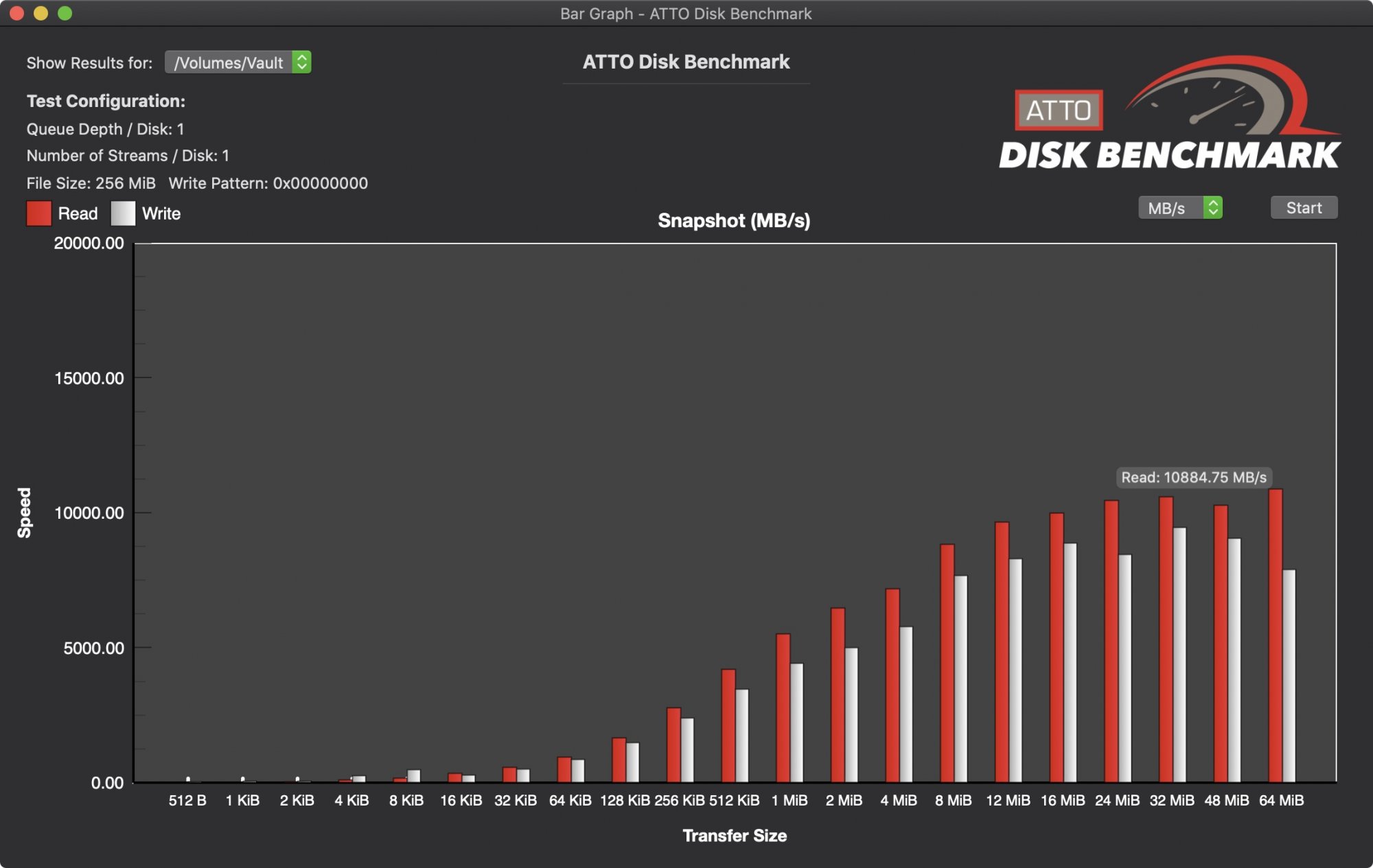

I guess mine seems about right, since I'm running RAID 0 on only 2 x 2GB sticks. The other 2 x 2GB sticks is the mirror backup.
This is using 5GB files.

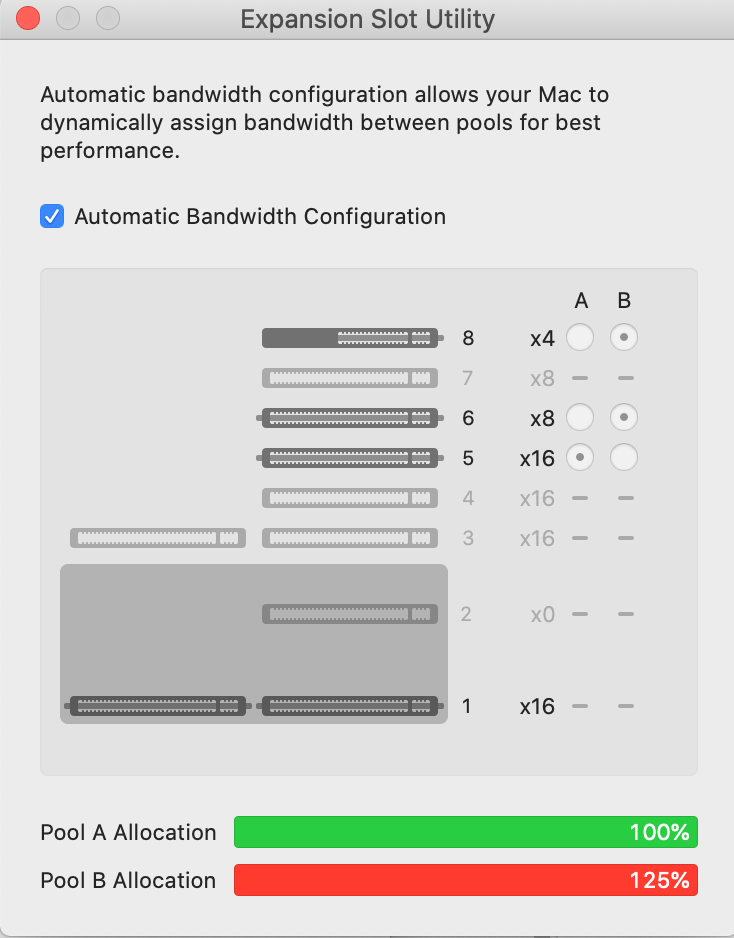

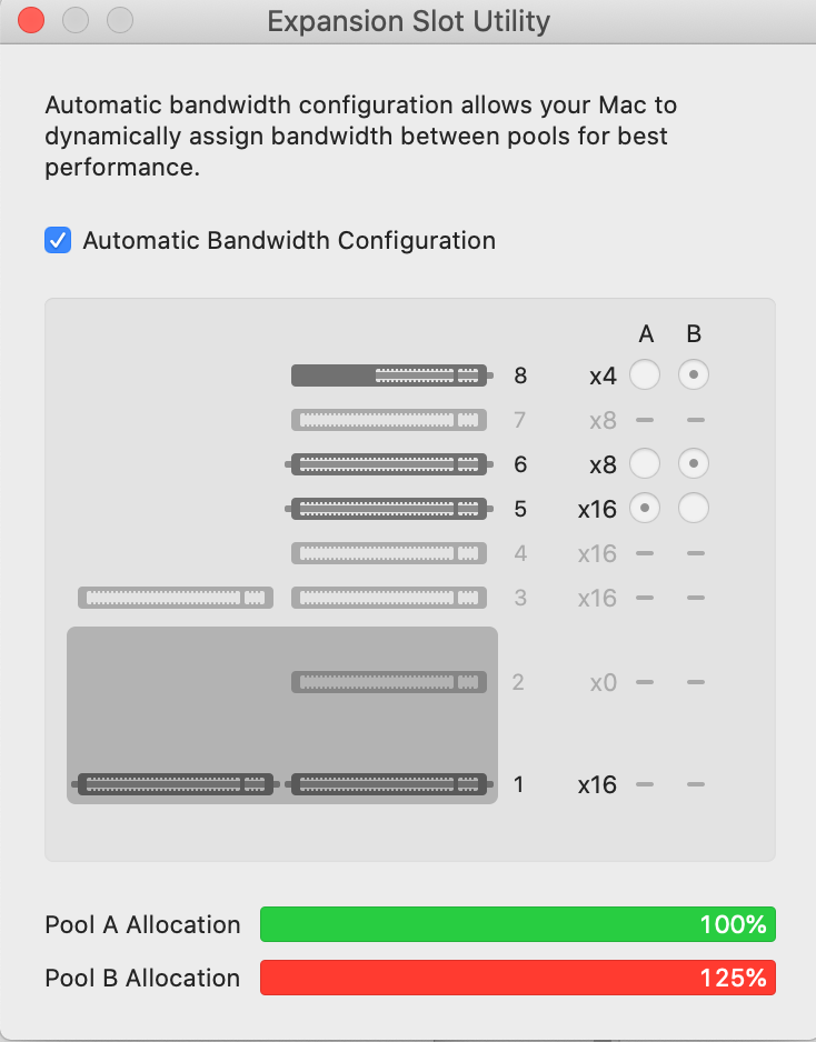

I know this was asked previously, but can't find the thread. What are you seeing with the PCI allocation? When I installed this card, I am getting 125% over limit as a result in one pool and 100% in the other.
And to think the slots aren't even occupied fully. How does this work if it's over the limit then?
This is what I ended up with by manually configuring...
Leon,
Interesting!
I have two of the Sonnet Silent m.2 cards installed, only in slots 4 & 5 since each is x16, and my POOL A/B Allocations are identical to yours.
I have the feeling this is not a problem - at least I hope not! I think I recall seeing a comment on the site to the effect that this kind of pool allocation is OK, but can't find it now...
Tom
Yeah, I think I read somewhere this should be okay but hoping someone can technically confirm why.
In any case, I did play around with the manual configuration and didn't result to anything better:
- 100% and 125% just switched around in either pool
- 200% and 0% in each pool
I also read somewhere that you can utilized slot 3 to avoid this issue but I'm reserving slot 3 for an add-on GPU in the near future.
Reactions: OkiRun
