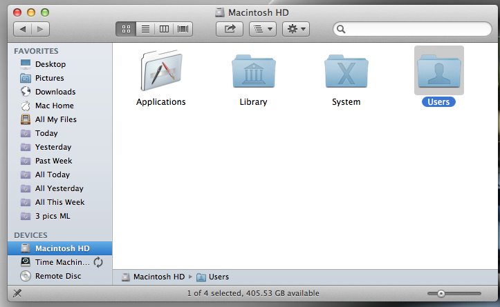

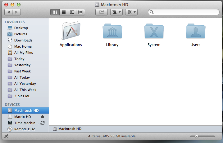

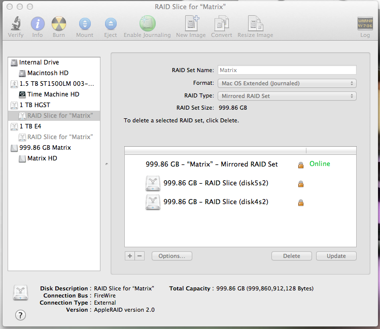

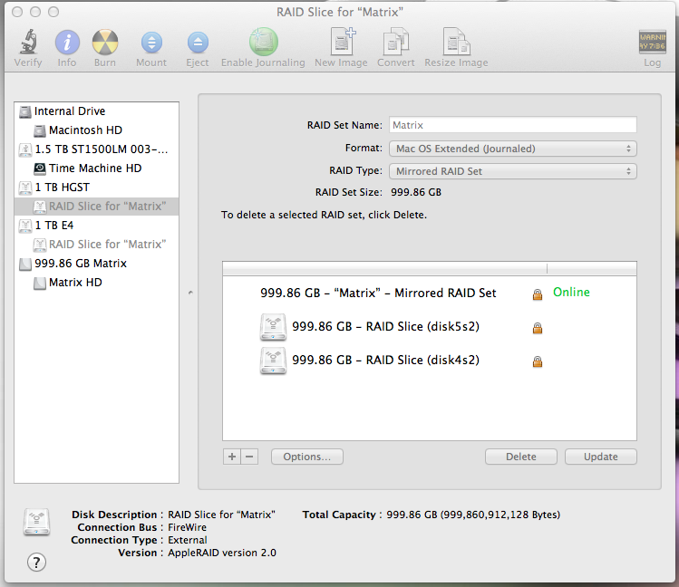

I have 2x G-Drives Firewire 800 drives in Raid 1 (daisy-chained), as you can see in Disk Utility, Pic 1. Then, Pic 2 shows the drive in the Finder, I named it Matrix HD, homage to Intel matrix storage. Now, I am told by the internet that this offers some kind of security in case of drive failure. Well, today I disconected one of the Raid drives, and I was hoping my data would still be acessible and perhaps get some warning at disk utility. But instead, EVERYTHING WENT MISSING. Even tough I had one of the Raid 1 drives conected to the Mac, there was nothing to see in the Finder or Disk Utility. So how the hell this offers security? The array got broken. In case of a real drive failure, Im gonna lose all my data.

If the drive is connected directly to the Mac, powered, but not showing anything in Disk Utility, (i.e. not even the hardware drive, as opposed to the partitioned volume on that hardware) then that might point to a hardware failure of the drive itself.
This might be coincidental to splitting the RAID, or possibly a consequence.
Does the drive show up in System Report > Firewire?
What happens if you connect only the other drive from the RAID? Do you get the same result?
And if you re-unite the pair? Is it all working again?
You're sure that the drive was connected directly and powered up? It's very odd that Disk Utility did not even show the hardware drive, in order to allow erasing/re-partitioning.
I'm no expert on RAID, but perhaps a RAID-ed volume always expects to be one of a pair? Perhaps you need to add another new mirror to the RAID set before things will work as normal. This is nothing more than a pure hunch.

I did another test today, and it appeared.
The first time, I disconected the cable of the 2n hard drive, but let it connected to the first (the drives are daisy chained), and of course, the first drive was connected to the Mac
This time I disconnected the cable from the first drive instead, while letting the first drive connected to the Mac. This way, itshows fine in the Finder and I can acess my files.

The reason this isn't working as you think it should is because you are disconnecting the enclosure and the HDD within. In a HDD failure situation the enclosure is still attached but can't read the drive. Place a new HDD in the enclosure and it should rebuild the array. However, when you disconnect the enclosure you are removing hardware that has no redundancy. Thus the broken array as it can't detect the missing/failed HDD.
