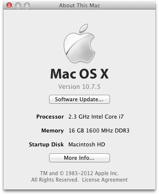

I just installed a 16GB 1600MHz Corsair Vengeance RAM kit in my early 2011 MacBook Pro. It works great. And it was only $110.
I see you put in (and your computer recognized) the 1600 MHz RAM. Is there a significant difference in performance in the Early 2011 MBP with the 1600 MHz vs 1333 MHz RAM? All of the sites I have used have always suggested 1333 MHz, just as the computer ships with.
Nope, no significant difference. However, there really wasn't a difference in price either (maybe a buck or two) and Sandy Bridge supports the faster RAM (well, at least the i7-2720QM and i7-2820QM do) so I figured what the heck.
In my case it's really a moot point, though -- I just ordered a 2012 cMBP and I'm going to put this memory in that computer and restore this computer to 8GB of 1333MHz RAM before I sell it.
