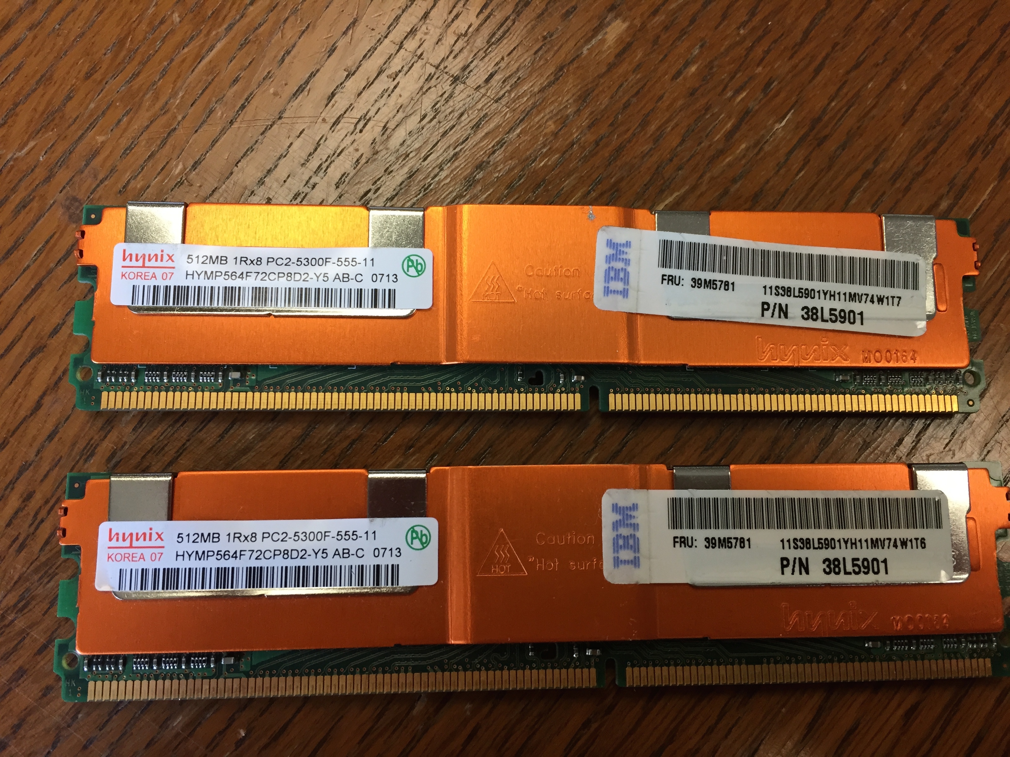

I know that this has been beaten to death and that one should use "Apple Certified" RAM in the 1,1.
With that said, I have a LOT of DDR-2 ECC Registered RAM with heatsinks. I also picked up a 1,1 cheap, and of course would like to stuff it full of RAM.
I'm digging out some RAM(I do have some IBM SystemX rackmounts that are parts-only and I can also pull RAM from), but am wonder if-for the time belng-the below pictured will work.
It'll probably work fine as long as it's FB-DIMMS.
I ran 16GB pulled from a server in my 2008 for a while. Lots of work done and zero issues.
Thanks-it's labeled PC-2-5300F where I'm assuming that the F is for FB.
It's also keyed differently from regular DDR-2(it's keyed as DDR), which is consistent with all the DDR-2 "server" RAM I've encountered.
I'm happy to report that the two Hynix modules above are installed and working perfectly.
I guess that when folks talked about heatsinks on these, I didn't really appreciate how big the stock MP heatsinks are.
The computer currently has 2x2gb and 6x512mb. I think I have enough registered ECC to load it up with 1gb modules-I guess maybe I should transplant the stock heatsinks. Either that, or just be content with 7gb of RAM 🙂

The 512's tend to be older, run much warmer and use what seems like a lot watts for DIMM - and you do not from what I have seen using FBDIMMs over the last (nearly) 9 years, to get above 70-72*C. All the newest ones I buoght (2x2GB $23) on Amazon and have the large heat sink, run at 59*C. I use to boost fans to help get airflow into the chamber with Risers to keep them just to keep from getting above 72. Below what the original Apple Dev Doc called for.
People around the forum talk of using 667MHz in a 2008 because they run cooler, still work.
The ideal configuration, because of the way DIMM slots are shared and increase latency was to not use slots 3&4 if possible, or to use all 8 slots.

Thanks-I'll probably stick in two 1gbs where I have the 512mbs now, and leave it be at 8gb. Honestly, I can't imagine doing anything where I need that much RAM(although admittedly my main MBP has 16gb and my main G5 has 10gb).

I'm rolling now with a fresh Snow Leopard install(currently downloading updates). I also swapped out the two 512s I installed earlier for two 1gb modules.

That pair of RAM will work. However, RAM for the model 1,1 so very low priced these days. You can get 16GB for $75 and 32GB for $150. You might as well pick up an entire matching set.
