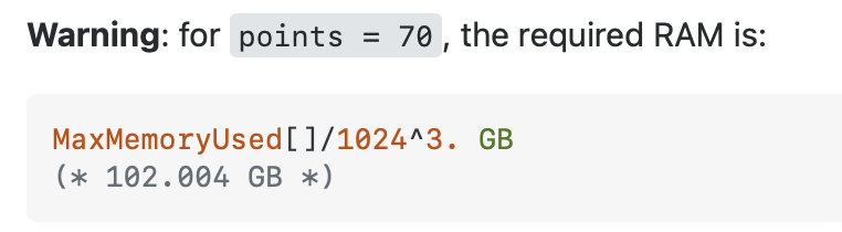

... I'm happy to show you an example from the Mathematica Stack Exchange (https://mathematica.stackexchange.com/questions/230282/3d-fem-vector-potential). See the solution posted by xzczd, where they note:
It looks like practical issues get in the way of Theory. Clearly, FE can be done with parallel code but you can't rewrite all those Mathematica functions.
About all you can do is reduce the resolution from 1024 cubed to (say?) 500 cubed or whatever fits.

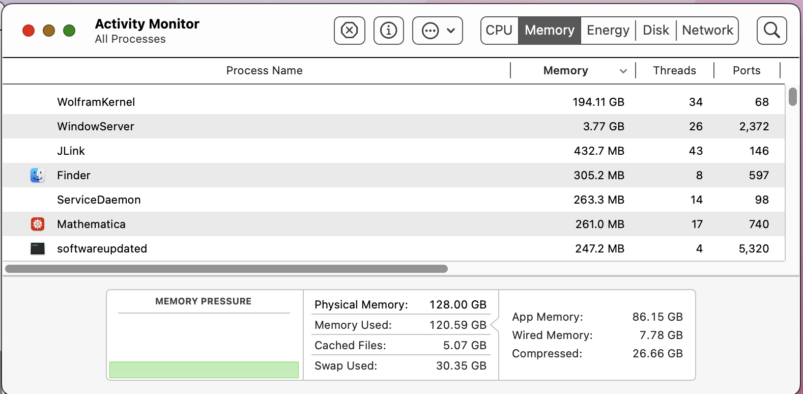

As another illustration of high memory use with Mathematica (MMA), here's a toy example using Reduce, which is MMA's generalized equation solver: Suppose you want all sets of four positive integers whose sum is 128,705, and whose product is 46,671,065 x 10^8. You'd solve this in Reduce using:
Reduce[a + b + c + d == 128705 && a*b*c*d == 46671065*10^8, {a, b, c, d}, PositiveIntegers]
On my 2019 i9 iMac with 128 GB RAM, this calculation takes 9.0 hours, and MMA reports MaxMemoryUsed[] = 210.45 GB.
Here is a corresponding snapshot from Activity Monitor taken during the calculation.

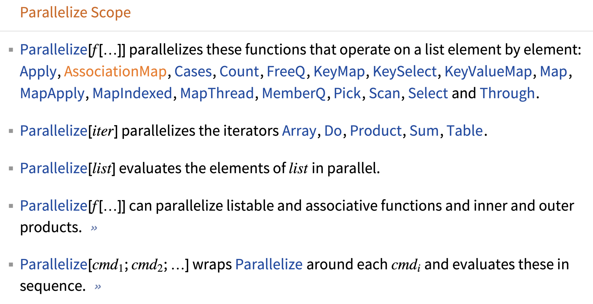

Indeed, to the extent most MMA users wish the program were written to better use computer resources, it wouldn't be for lower memory usage. Instead, they'd want more operations to be multi-core. Currently, most of its functions are single-threaded only, and many operations have a noticeable wait time for completion—not typically 9 hours, but then MMA is most commonly used interactively, so even several seconds' wait time becomes significant. And of course that leaves most machines with multiple cores sitting idle.

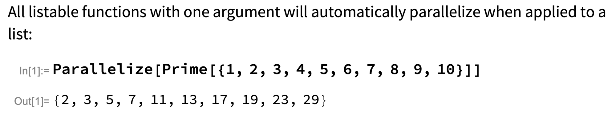

Wolfram does automatically parallelize, or allows to be parallelized, all the obvious candidates for parallelization. Here's an example of the former (screenshot taken from MMA's documentation). It returns the 1st, 2nd, 3rd, etc. prime numbers. As each of these can be calculated independently, this is an embarassingly parallel problem:
[Yes the documentation here is a bit confusing, since automatic parallelization should mean you don't need to explicitly call the Parallelize function and, indeed, you don't need to do this to get it to use all the cores (up to the max your license allows, which in my case is eight).]
Here's a more general list (also from MMA's documentation):
However, this is only a tiny fraction of the ~5,000 functions offered by MMA, and notably leaves out most of its "bread-and-butter" functions, such as those for doing integrations, differentiations, differential equations, equation solving (e.g., Reduce*), and expression simplification. So it would be great if all of these could be parallelized. Yet, in spite of the obvious benefit of parallelizing functions, and their interest in doing so, Wolfram has not done this. That leads me to conclude these functions are likely extremely difficult to parallelize.

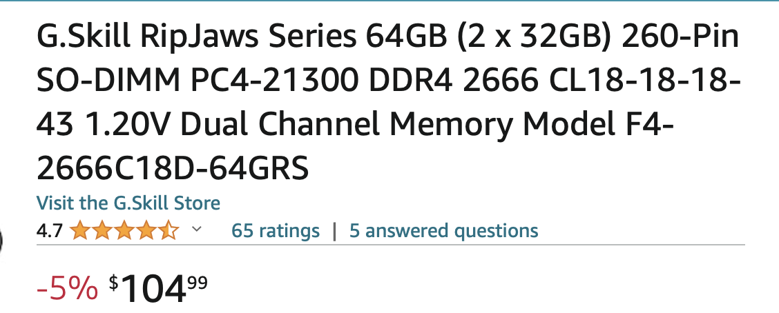

I'll second that. 128 GB RAM for the 2019 and 2020 iMacs is currently only 2 x $105 = $210 on Amazon (it wasn't so long ago that a 128 GB SSD cost more than that!):

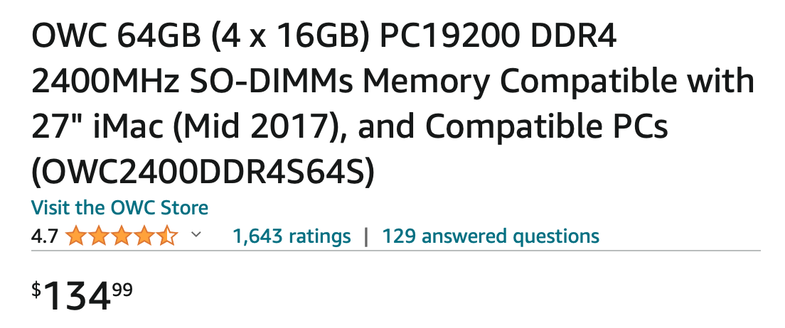

If you can get by with 64 GB, then a 2017 iMac will work, and the RAM will run you ~$135:
