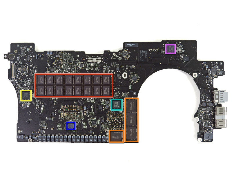

If you look at the picture of the rMBP Motherboard, the second row of memory chips are about the same distance from the CPU as the pluggable dimms on the Regular MBP.

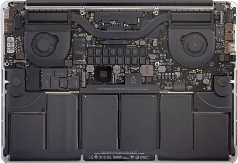

The rMBP has 32 Hynix H5TC2G83CFR 2Gbit DDR3 RAM chips on the 8GB model. There are 16 chips on the top side of the motherboard and another 16 chips soldered to the back side. You would have to unsolder and remove all 32 chips and replace them with 32 x 4Gbit chips to upgrade memory to 16GB. Mission (nearly) Impossible.....
iFixit.com has a nicely documented teardown. I can't see anyone offering to replace RAM on one of these for all the aforementioned reasons. Just the teardown to get to it is iffy. Crikey, it's hard to even get someone to replace a hard drive in an iMac.

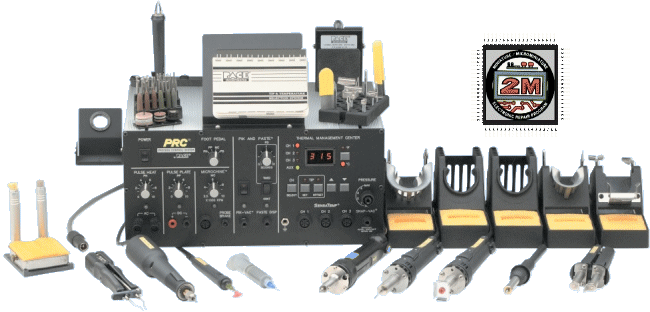

Unless of course you are trained in Micro/Miniature Solder Repair (which I am) and have access to one of these (which I do) and use it daily.
How long do you think it would take you and how much would you charge? (Not that I'm interested in having this done now, just wondering if it is something that could be doable down the road for $200 or less)
Exactly! With an smd rework station like that, it's very possible. I have a system similar to that as I also work on micro circuit boards. There is no way that you would ever be able to remove the ram if you did not have a rework setup. A good soldering station makes a world of difference.
Great! So it IS possible to upgrade the ram on a rMBP, provided you:
1) Are certified in micro/mini solder repair and already own the specialized equipment
2) Know somebody local who is certified, has the equipment, and is willing to work for free
