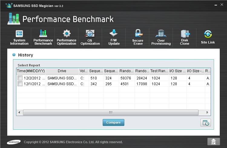

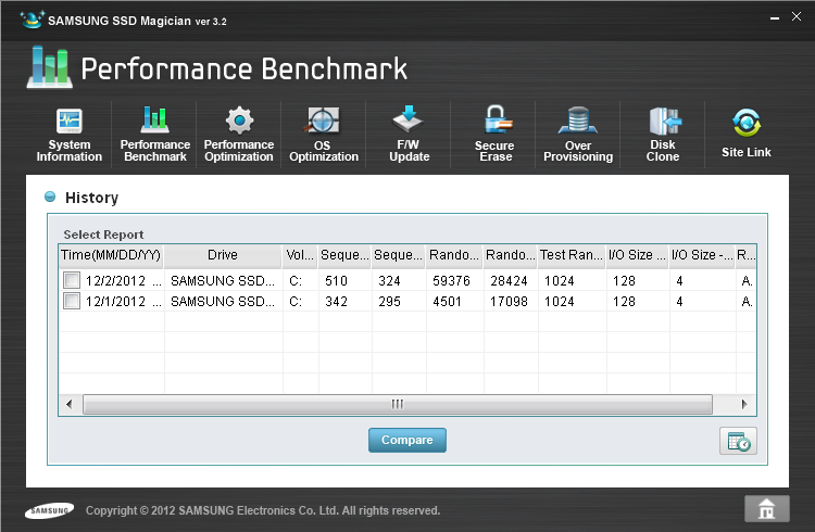

Had no problems with an Intel X25M-G2 or a Apple Toshiba SSD (different Mac mini's) but then a Samsung 830 caused reproducible lockups under Windows 7 while copying from firewire backup to Samsung SSD.
Investigated these lockups and switched to AHCI mode and can no longer reproduce the problem. Performance improved considerably under Windows 7.
Perhaps my occasional black screens will be resolved too, time will tell.
Attached picture: top result is AHCI, bottom is IDE. Under Toshiba and Intel SSD's there was hardly a difference but this Samsung has a large difference.
