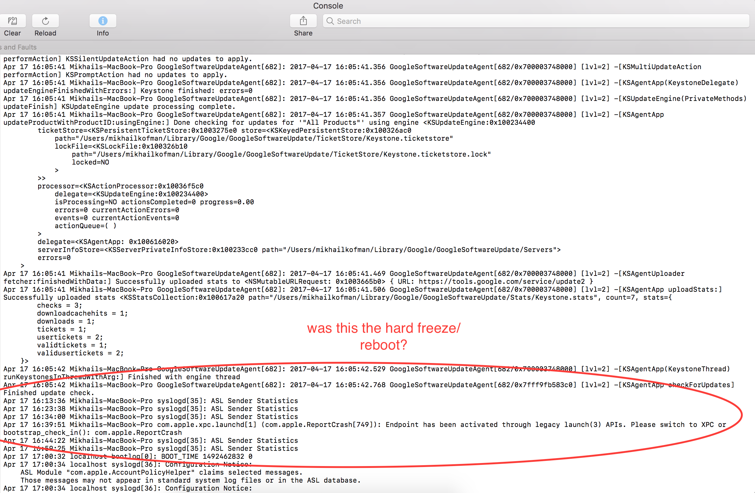

yes i am on .4 .... 8/10 times hte hard freezing happens, its after black screen/sleep. but rarely also during use. but also i am thinking it might be google keep app which runs in chrome, i use that 24/7 at work for note taking for my school students during lessons. I looked up the time stamps for the time that the freeze happened and see lots of stuff related to chrome, here are the screen shots.... maybe someone can decipher for me.
at 4:59 pm, i woke pressed on the trackpad to wake up the laptop and thats when it froze, trying to find something for that time in system log, this is all i see
