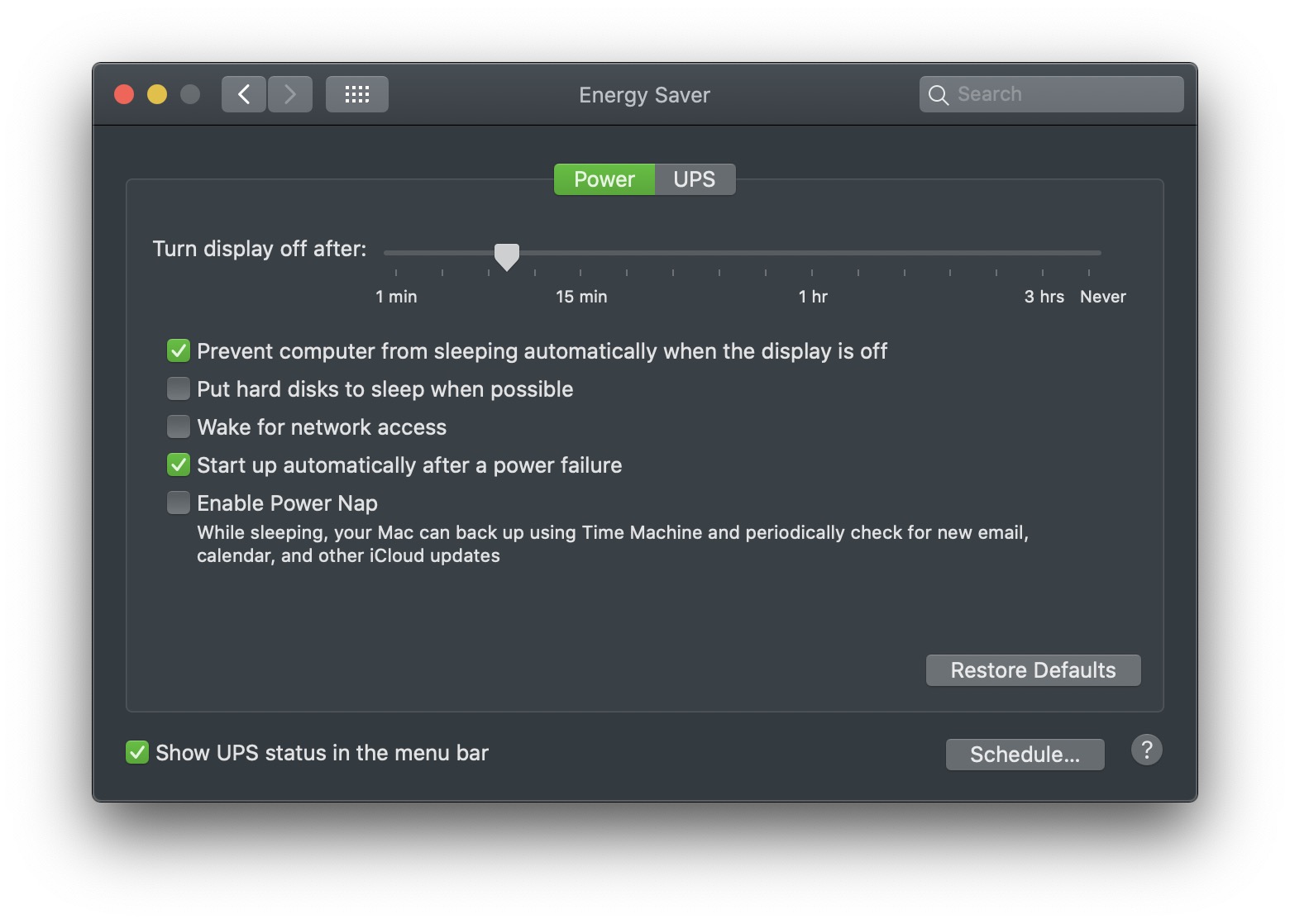

Being pragmatic, and setting aside what is vs. what should be, try setting your Energy Saver like this, and see if it resolves your problems.
Reactions: OkiRun

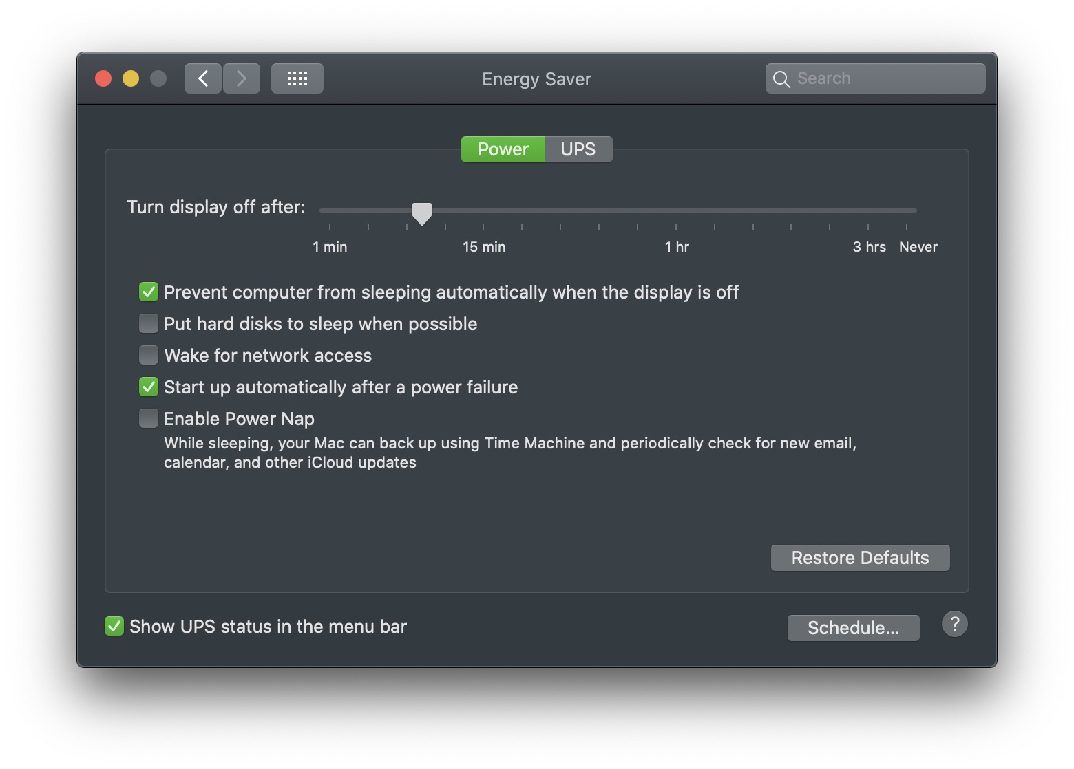

Being pragmatic, and setting aside what is vs. what should be, try setting your Energy Saver like this, and see if it stops your problems.
