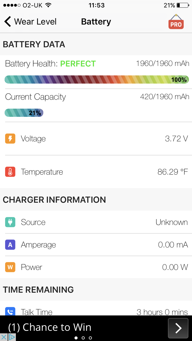

battery life for now it shows current battery charge & capacity & voltage/charging state, all are correct. but no temp reporting, but with battery percentage etc all those other ( 99% same app from same dev under a different name etc), ull see it shows what the current power source is, under charge its fine, when under battery itll say 0/unknown.

The latest battery life app version shows temp now

All apps that go by 'Battery Life' in the app store now are knock offs of the original that was pulled. The developer even stated that on Twitter, they even stole his icon.
With that being said, its not as accurate as Coconut Battery for Mac. Coconut shows the real time battery health down to the single digits. Battery Life shows battery health per percent. iPhone 7Plus has a 2900mAh battery. Coconut will show 2851mAh (98.3%), Battery Life will show 2842mAh (98%). It does it in larger blocks because it cannot access the full information. So its not as accurate. Current charge is also broken on these apps. The apps are using iOS' battery meter to determine current mAh of the device, not the battery itself. Remember, the battery meter on iOS is not 100% calibrated to the battery itself.
When iOS reports 100% the battery is really 95%.
When iOS reports 50% the battery is really 47.5%.
When iOS reports 5% the battery is really 4.75%.
When iOS reports 1% its really 0.95%.
Battery % is linear, but its not 100% = 100%. Never has been on an iOS device. So when using one of these apps now, you are just seeing what iOS is reporting, not the battery itself.
