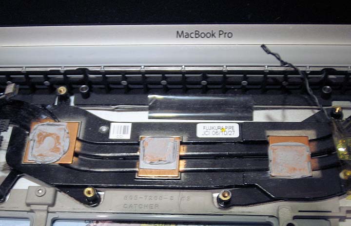

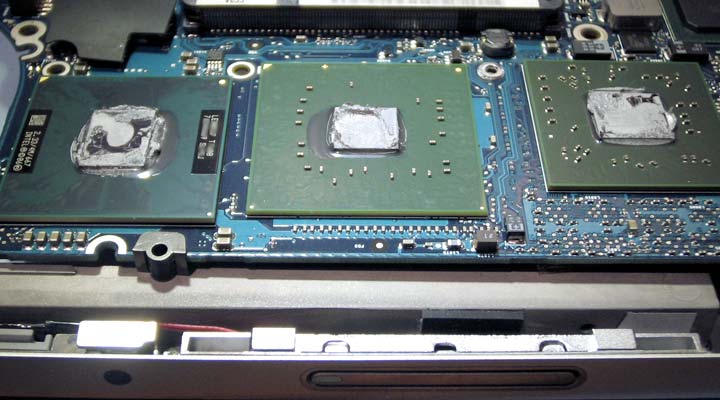

To resurrect this old thread from the dead...
In case anyone wonders, it seems that Apple has switched to some kind of standard size thermal pads since the Core 2 Duo MBP's. While swapping the hard disk in my MBP Core 2 Duo (Oct 2006), I couldn't resist my curiosity and removed the logic board too. You can see what it looks like in the attached pictures. The pads are still slightly larger than necessary, but it looks a lot better than the 'mayonnaise' from the early MBP's.
Of course I had to apply new thermal grease when reassembling, and I used Zalman's "Super Thermal Grease" which is comparable to Arctic Silver 5. However, Temperature Monitor doesn't show a considerable drop in temperature compared to the standard grease, so it seems the latter does a good job and it's rather pointless to take the newer MBP models apart.
That grease is NOT thermal pads. It is the same paste they have been using, Shin-Etsu. In your case, it is only 4x too much paste, in my case, it was like 100x too much. Here is my thread from back in June of last year when I redid my paste, I saw a huge improvement in temps.
Indeed, I used the wrong word. What I meant is that they now seem to use some pad-shaped applicator to limit the amount of paste.
Anyone got any other sources to confirm that the newer MBP's have less thermal paste? I'd hate to finally get one only to find that I need to take it apart.
Well, as you can see from my previous post, taking mine apart didn't improve the temperatures. I think we can assume that the cooling system works correctly now.
