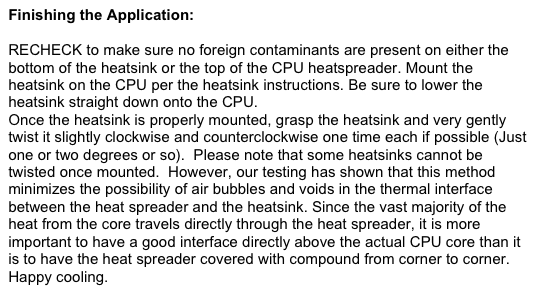

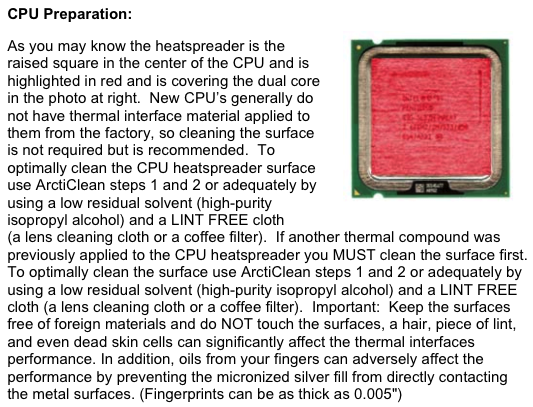

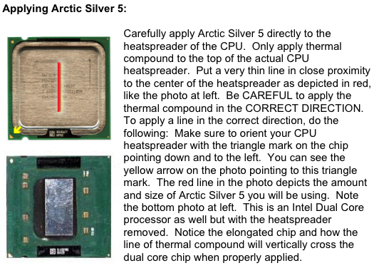

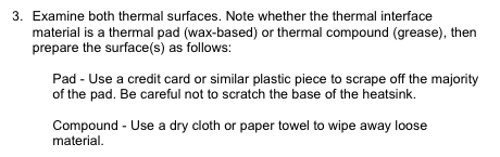

FYI: pasting the right way
Hi 😀
Just thought that I'd share this because most ppl #include <mysel.f> don't generally read instructions 😀
> whatever you don't know, could hurt you <
