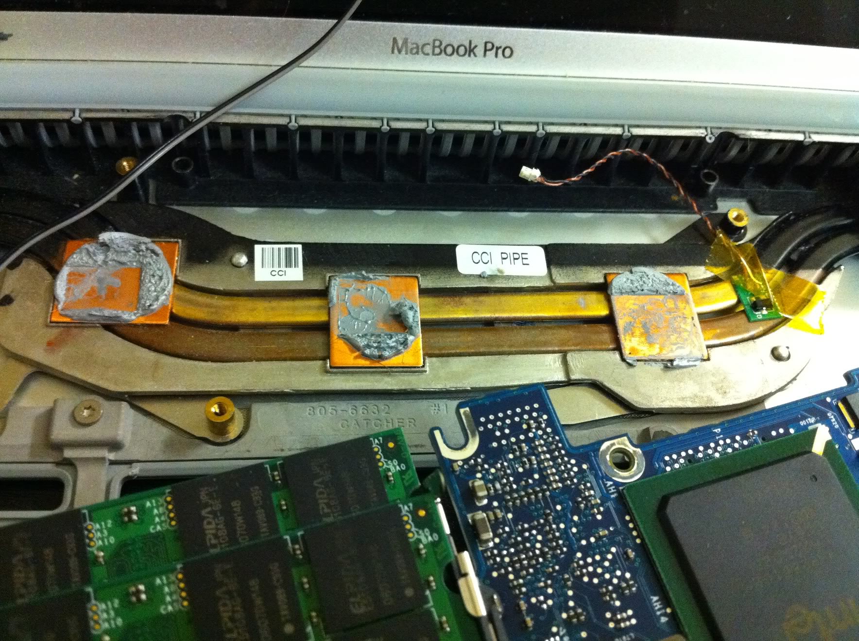

If you see this mess, Apple should switch back to the nasty black print-on gaskets they used on the PowerMac G4. Can't be worse than a china man with a syringe.
Holy mother of god.

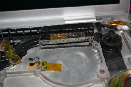

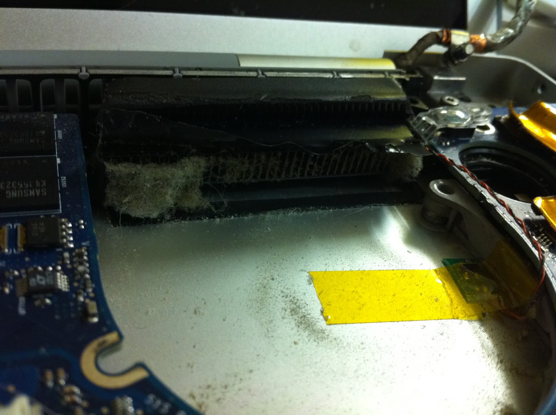

Btw - how gross is that first picture with the dust. That's 4 years worth of dust. This is the first time I've ever opened the mbp in the 4 years.
I have to recommend everyone who has temp problems to replace their thermal paste - especially the 2006 first gen owners.
It makes a crazy difference. Idle from 60C to 48C on those core duo's just says it all.

Geeeeezz that is a lot of paste. That is even more than the paste on my 13" MBP. I thought what I had on my 13" MBP was a lot...
See my post with pics of the stock thermal paste application here:

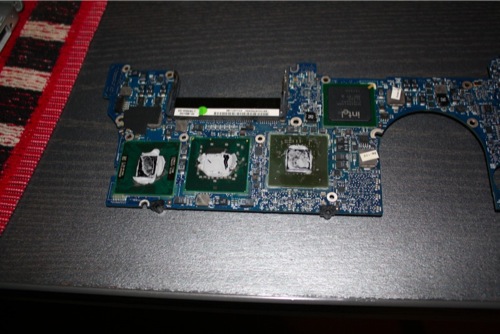

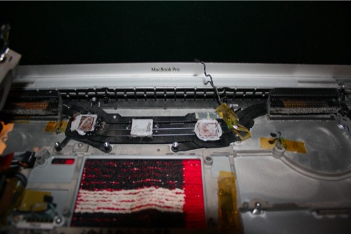

SUCCESS! After meticulously disassembling my MBP, I have successfully applied Arctic Silver Ceramique to the CPU and GPU. I took pictures of the original application of paste, but I mistakenly forgot to take pictures of my paste application. I am noticing a difference of approximately 10º-12ºC, idling. The difference between the original paste application and my new paste application is about 2º-5ºC, under load. I know that is not much, but the fan speeds are about 3000rpm lower than before the paste application, under load. The fan speed while idling is the same 1990-2000rpm as before the new application of paste. The whole reapplication process took about an hour (including taking apart the MBP).
Now on to the pictures:
This is a picture of the MBP's Logic Board with the original thermal paste application.
This is a picture of the MBP's heatsink/heatpipe with the original thermal paste application.
This is a picture of some of the scraps of the original thermal paste that I took off with a lint-free cloth and rubbing alcohol. It came off of the cloth.
This is a picture of the heatsink/heatpipe with all of the thermal paste removed.
This is a picture of the logic board without any thermal paste.

Also, have you tried just opening it up and blowing out the fans with canned air?
results
Actually I did not try blowing out the fans, and I'm going to do that next. I couldn't find my compressed air last night.

OK I blew out the fans, but not a lot of dust came out of mine.
