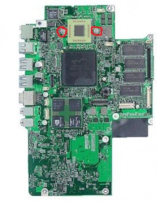

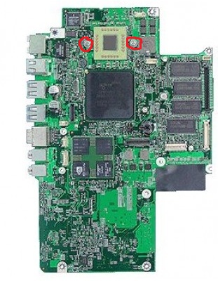

Can you post a picture of where the screw thing fits into in the Powerbook's logicboard?
I totally see what you were saying now! I'm sorry I misunderstood. However, there is no conceivable way I can get the two pieces apart. They are fused extremely tight, perhaps heat over time? I tried clamping it and trying to separate with a screw driver, undoing them with pliers, heating it up until it was to hot to touch and trying to get them apart, all to no avail. I think I will have to go without them. Here is a picture:

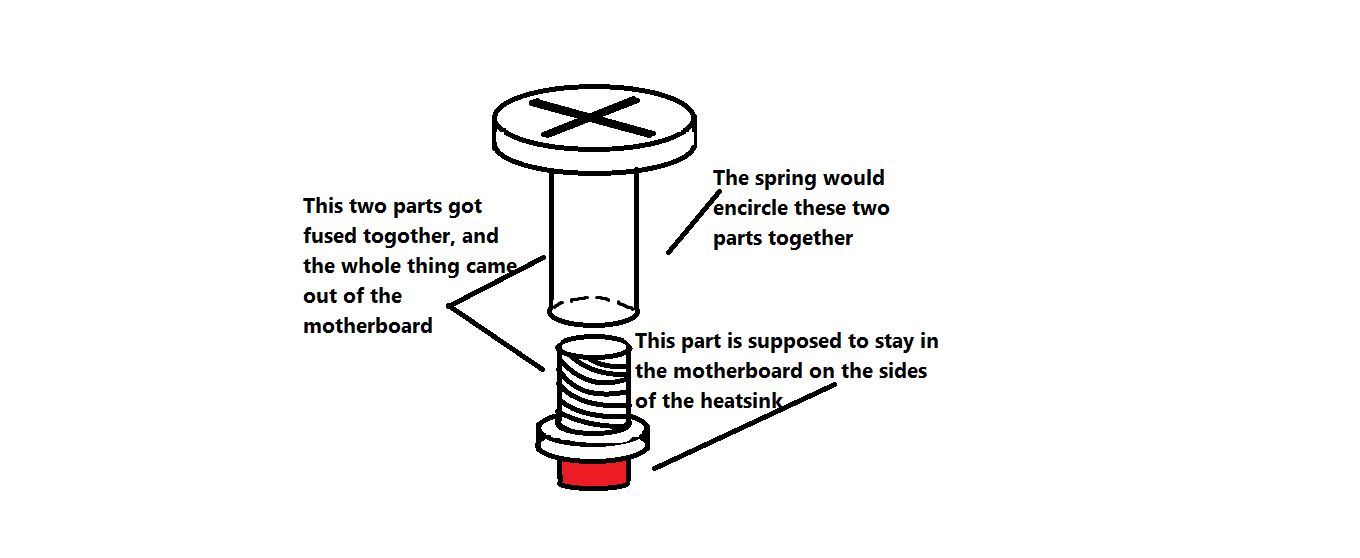

Ok, I sketched a picture of the screw and what happened if anyone else wanted to know:
(Click to enlarge)
EDIT: I forgot to write that the red part is the part that the motherboard holds in.

@Eyoungren: The 12" PB has no thermal paste at all?? And you did leave those two spring-screws out. Ok, I was worried that they were used for a very sophisticated and advanced reason for which I could not comprehend.
No, no, no. 🙂
All I meant was I did not apply new paste. Anything that was there when I pulled the heat sink off was left there. So, the old paste I assume would have reliquified when heat was applied again. Yes, I left the two screws out.
No, no, no. 🙂
Ok, I was like, "What dark magic has he used?!?"

Don't forget that because the two heatsink screws are broken, the heatsink isn't making good contact with the CPU die.
Ah. The heatsink made relatively good contact w/out the screws, not as well of course with them, but it didn't move around at all.
So long as it is firm and you can't move it by moving the machine around I think you are okay. That being said there should be no flex between the heat sink and the die. If there is air may form bubbles in the paste and then it will conduct heat poorly and raise the temperature...
Yes Intell, you are right, but it does work fairly well. Is there any way to re-secure these screws in your experience? I've read that this is a very common issue, where over time, heat will bond the screw and socket together, and the whole thing will pop out, especially since it's not well secured in the first place.

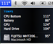

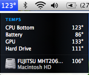

OK, I think I'm pretty pleased for now. My iBook has better idle temps, but honestly when my iBook is running two apps at once, it gets about as hot as my PB does under the same workload. I'm typing on it right now, and although it has only been on for about 20-30 minutes with 3 or so apps open, it's at 130F. My PB does about the same once it gets going. Thanks all for advise and help!
I should mention that all the temps I've listed are CPU. My iBook doesn't have a GPU temp monitor, so I can't compare them, unfortunately.
The first screenshot is of normal use (an app open, in use) after about 10 minutes. The second screenshot is after 10 minutes or so of heavy flash use on YouTube.
