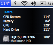

This is after about 45 minutes or so of an average workload. Temps honestly haven't changed that much, but the old paste was drying up (it's been 10 years!), so it would have become an insulator, which is obviously not good!
What was it after 45 minutes with the old paste?

I just finished replacing the pads on my GPU and NorthBridge and re-did my original thermal paste job on the CPU. Temps didn't really change that much, but I feel safer now that everything is in it's correct place.
The GPU is idling at around 120 F and the CPU at around 105-110 F

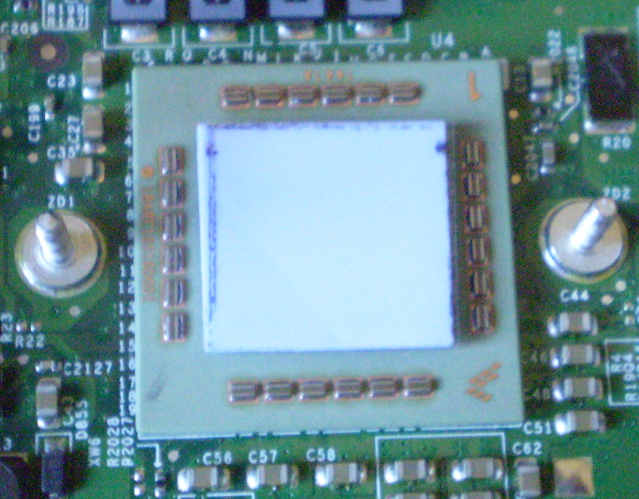

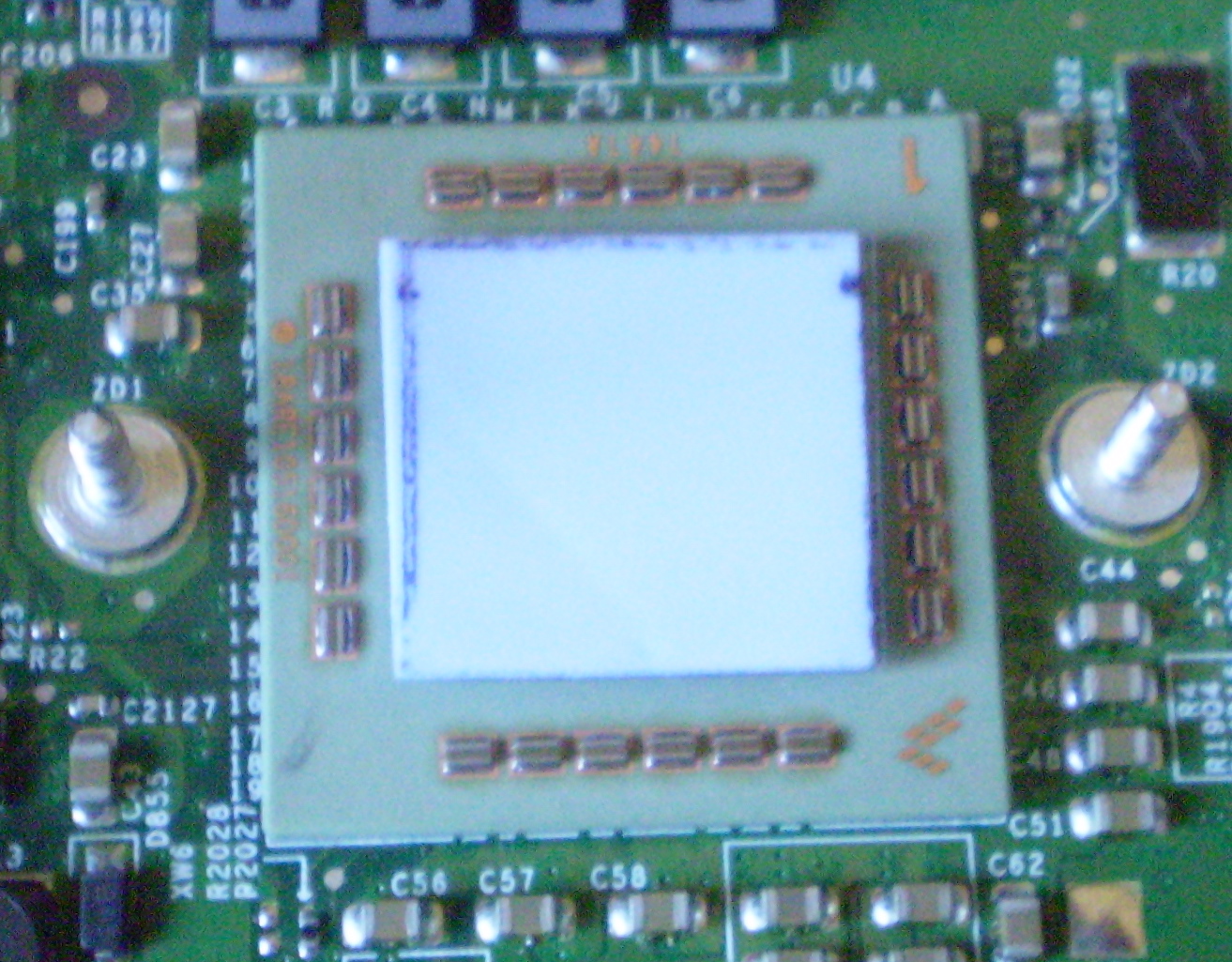

I did have one question about replacing the pads in my iBook. The CPU die and the GPU core are as pictured (below): not very big and only cover the center of the chip. Should I just cover the die/core with a thermal pad? Or cover the whole thing with thermal pads? The pads I purchased are about 15mm x 15mm.
If it has a pad, replace it with a pad. Never put just paste or it will overheat. See here why you should never replace a pad with paste. Even on a 15" or 17" Powerbook, it is a very bad idea.
Sounds great. If I replace my iBooks pads however, should they cover the whole chip? Or is it ok if I just cover the dye like with paste?
