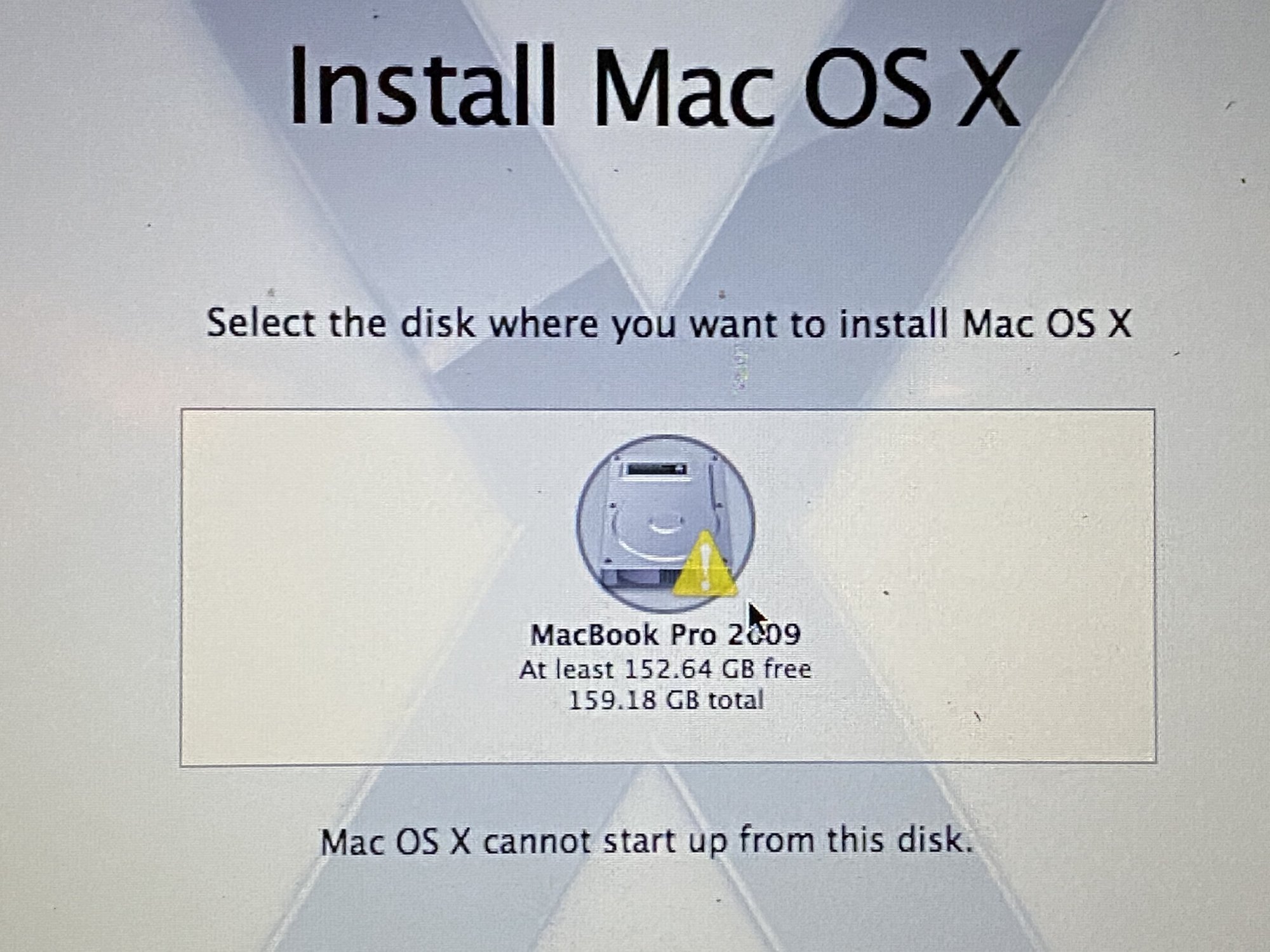

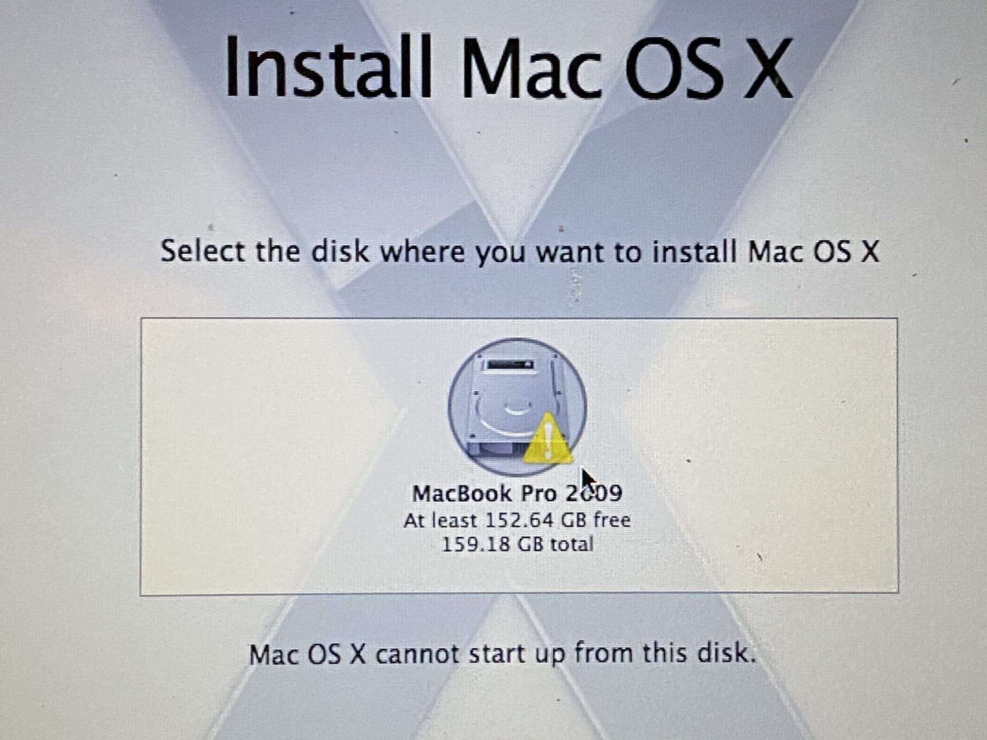

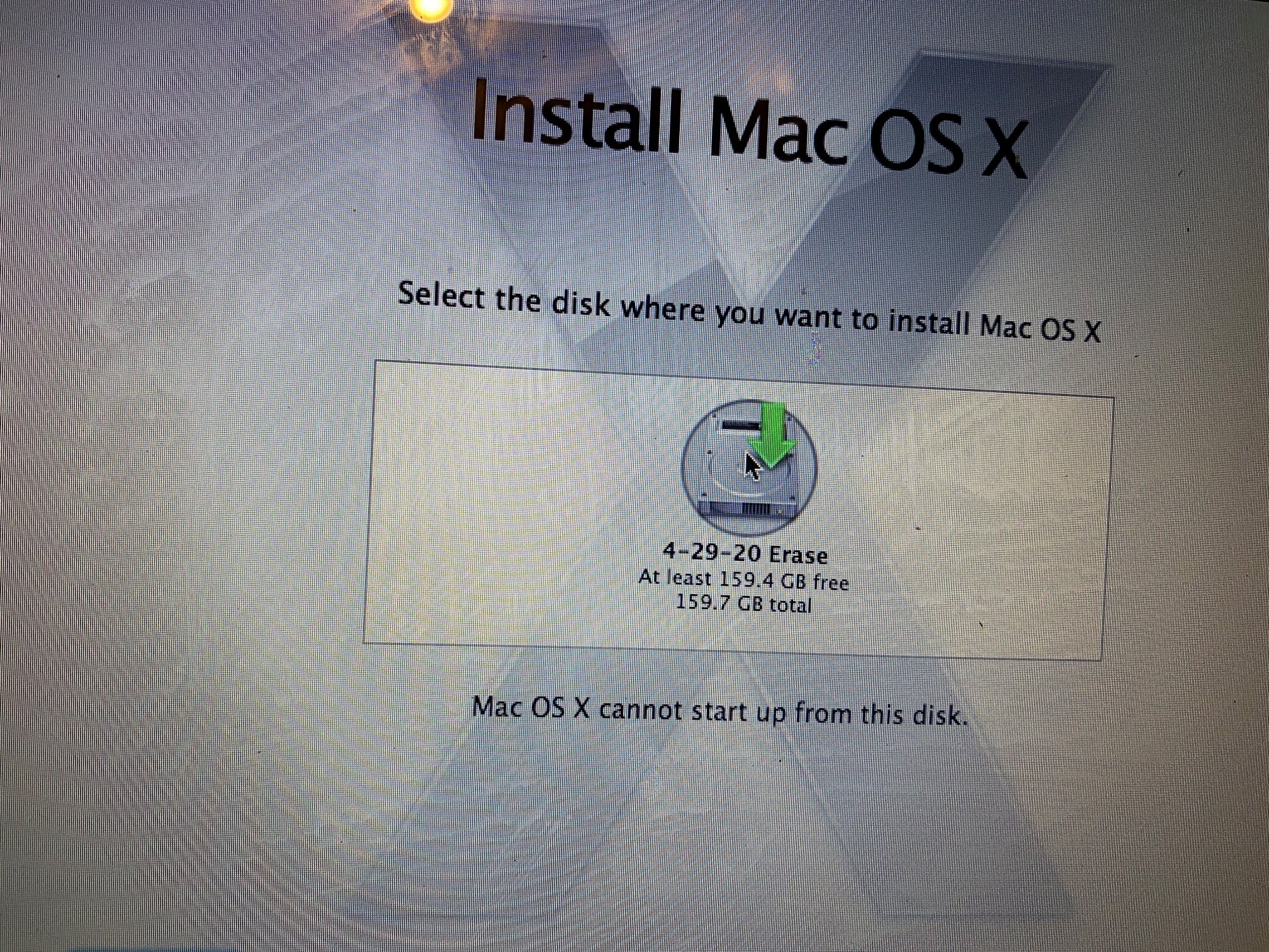

My goal: reset my MacBook Pro (Mid 2009) to factory settings.
I am attempting to install Mac OS X Snow Leopard 10.6.3 but I get this error message.
I have also tried using the internet to digitally download OS X but it won't allow me to.
Please help!
Thanks,
Jim

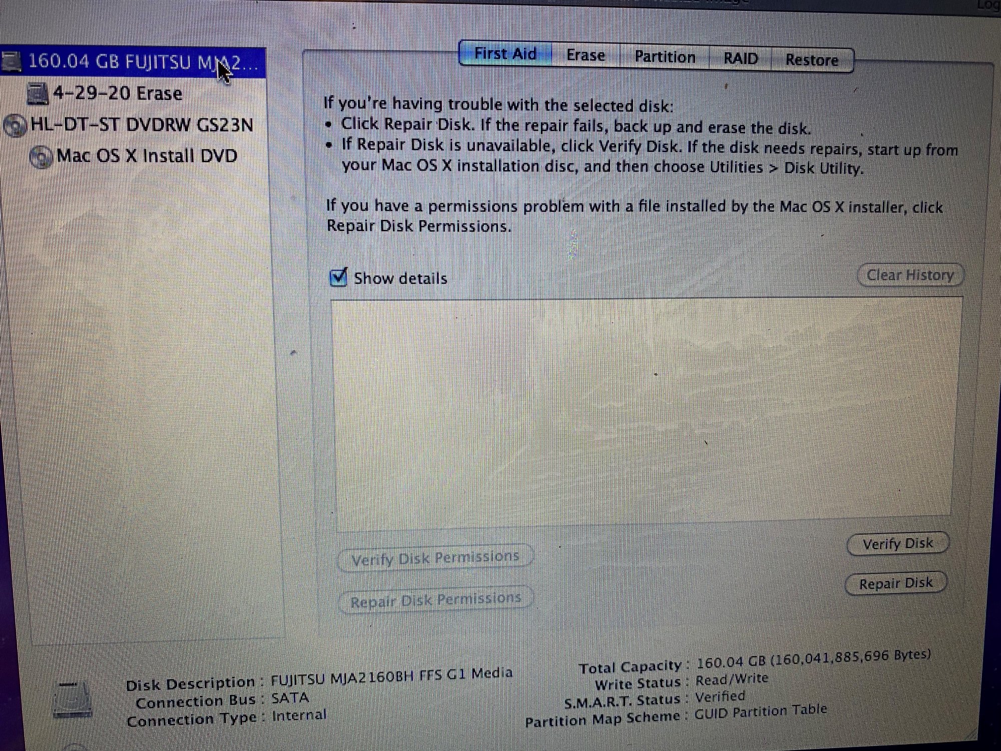

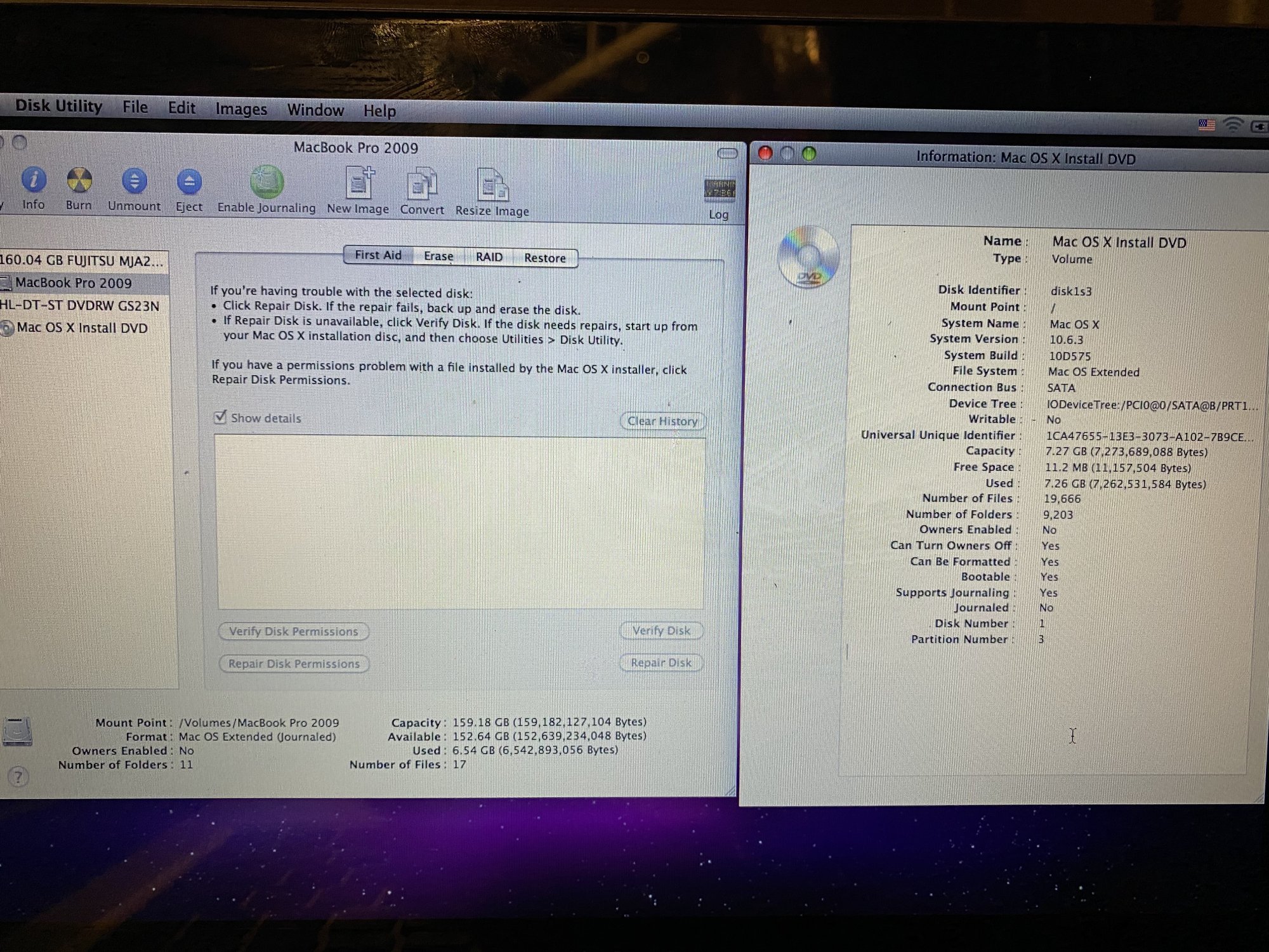

Can you send a picture of the information about this disk as reported by Disk Utility?

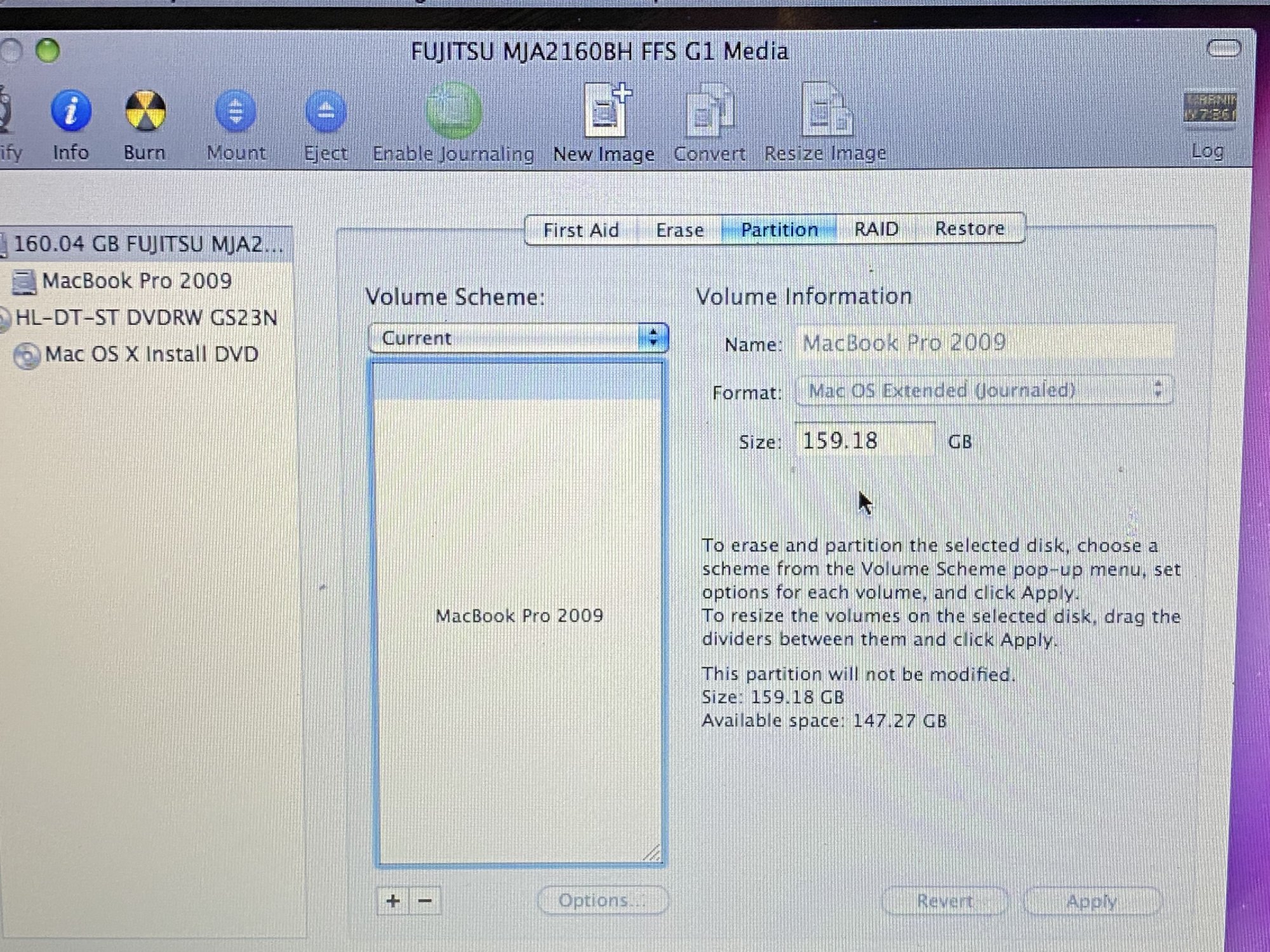

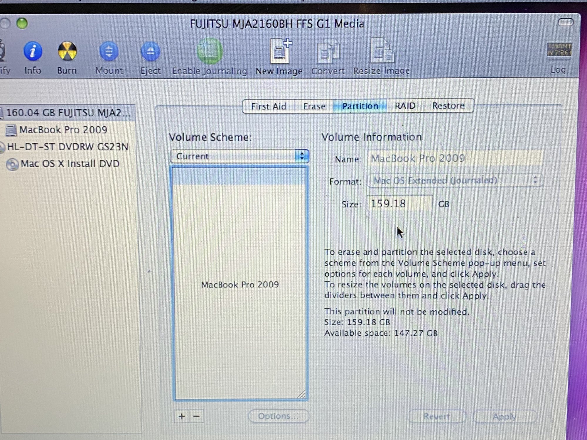

Try formatting it as Mac OS Extended (Journaled). Make sure the partition map is GPT and then try to install. IIRC on SL the partition map settings are under the "Partiton" tab (be sure to select the drive itself and not the partition like you have selected right now when you do this).

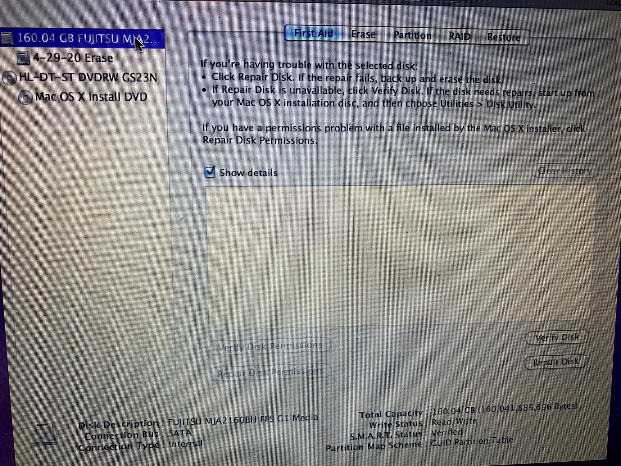

How do you format it? Do you highlight the disc itself or the drive labeled '160.04 GB FUJITSU?
Ok, try going to the "Erase" tab and seeing if you can erase from there.

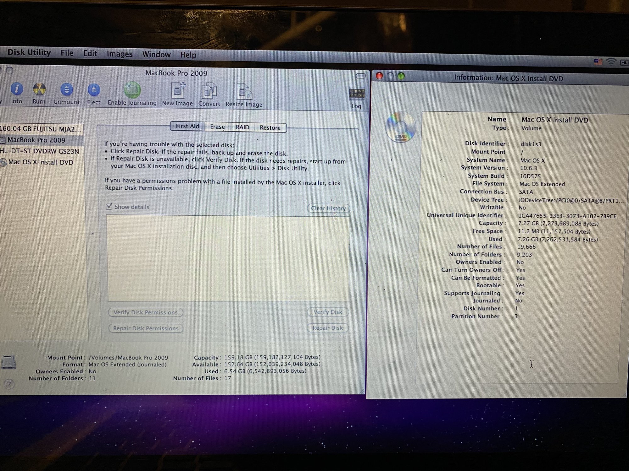

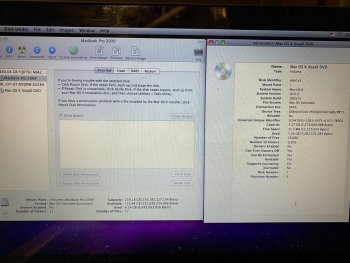

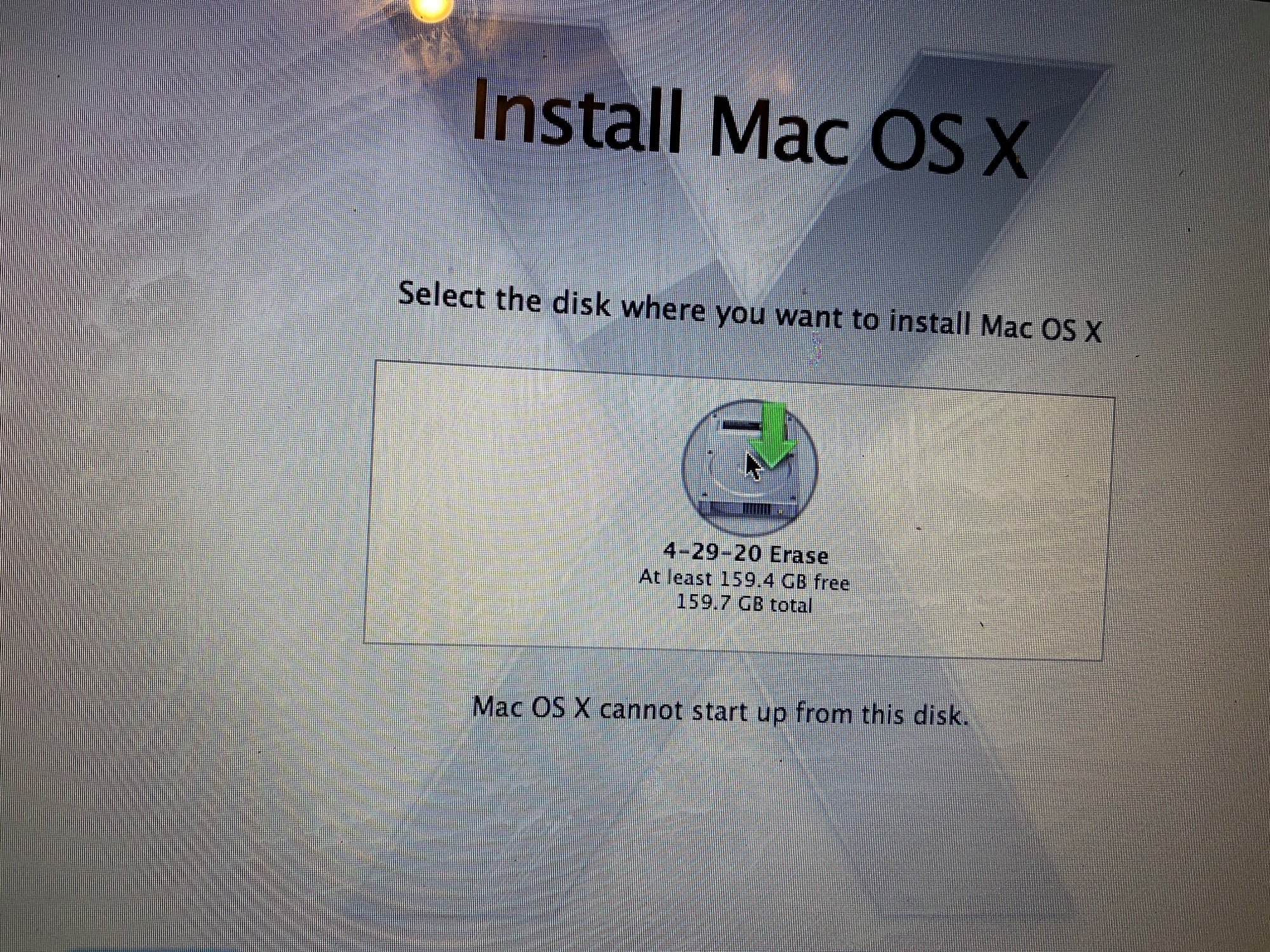

Okay so here's where I'm at after the erase. Where do I go from here? The disc still won't work even though the drive is now a green arrow pointing down instead of the yellow caution sign.
This is getting a little odd... Have you tried restarting after formatting the disk? It may just be that the installer needs to refresh itself.
It's working now! Thanks for your help! Which OS x platform is the best for mid 2009 to function normally?

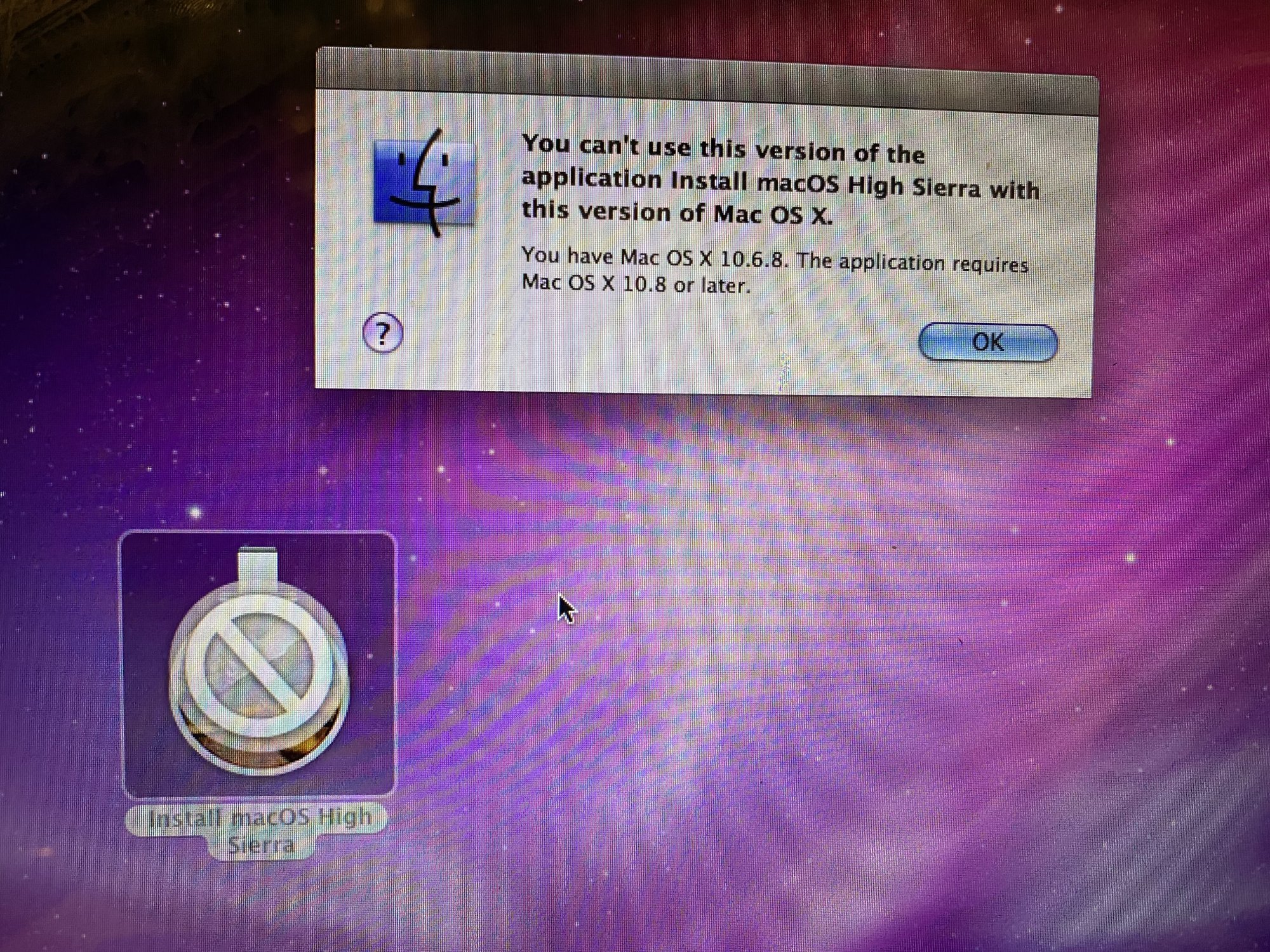

Like I said, High sierra is good. Use the tool I linked to in my first reply. The tool can download High sierra, put it on a usb and then install and patch it.
When installing HS make sure you set the date before hitting the install button. The date has to fall in a certain range else installation will fail. In terminal type:
date 121212122017

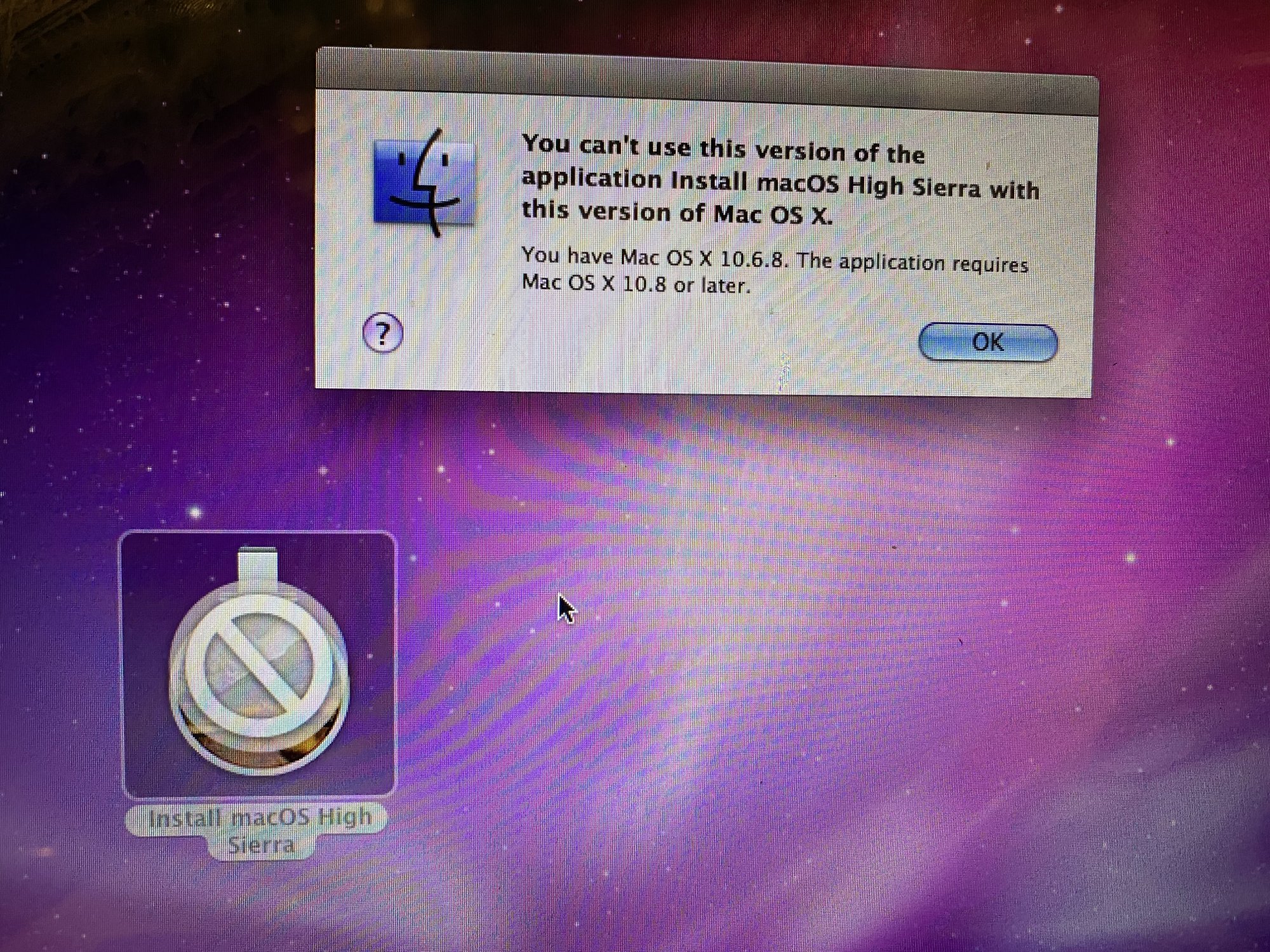

How do I change the date? I didn't change the date and I get this message after getting through all the steps including uploading the file to a USB drive and restarting the computer to load the USB OS. :
