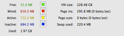

and now for the attachment.

It has only 2 GB 1333 RAM, so that needs to be dealt with. things like opening system prefs takes 16 seconds. start up is a bit slow. the dock is jittery as you move along it. i just quit iphoto and there was a lag of about 2 seconds from when i command q to seeing the iphoto at the top of the page flash blue. my 4 year old mbp is snappy compared to this. the apps seem to run ok. it's not my machine so i don't know all the issues. i've attached a snap of the activity monitor cpu looks like isn't challenged.
wb
You are way underpowered in RAM. 4GB is the minimum you should have and 8 GB would be more ideal.
Activity monitor snap shows that RAM isn't an issue (and in fact I've run minis just fine with 2GB) as there is no swapping. CPU isn't an issue either. But I wonder about the antivirus program. I don't use one except at work, on a PC, where I have no choice. It saps a lot of the performance, very noticeably!

It doesn't look like it's really being taxed, memory-wise. Upgrading to 4GB would make a difference. Upgrading to 8GB would be better and would go a long way towards future-proofing it. 16GB is the maximum for that model and may be overkill, but still isn't all that expensive ($110 or so, like CoachDave said).
But just to be sure, in Activity Monitor, can you switch where it says "Active Processes" to All processes and post the new screen shot? You may need to click on the %CPU header to sort it if they don't all fit on one screen.

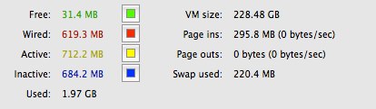

Your Activity Monitor is reading 31 MB free memory. That's almost zilch.
A properly running system should have very little free memory, as free memory is simply wasted. The two important items is Wired+Active, which is the amount of memory being used, in this case 1331.5 MB. The Inactive memory mostly represents programs that have been closed but whose memory image is still present -- these can be restarted instantly.
The second important item is Page Outs, which is what occurs when you are out of memory and the least recently referenced program/data is written out to the hard drive to make room for something else. This kills performance. If it is 0, as it is in this case, the amount of memory is fine.

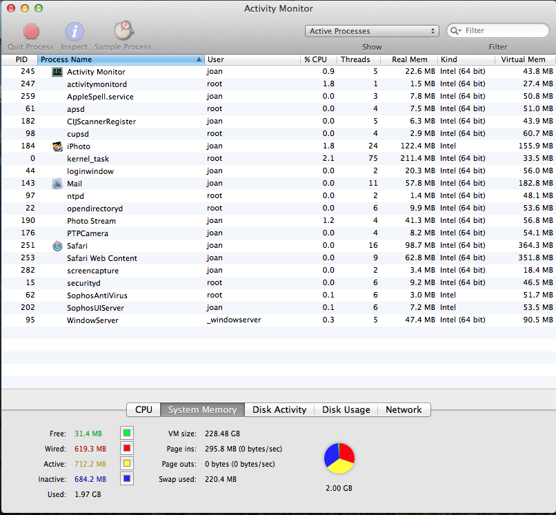

You can't assess the situation just from page-ins, page-outs, and swap file size as they are heavily influenced by how long the computer has been running and what it's recently been doing. If the OP just started his Mac and opened those apps, this is the result you'd expect. Let him use it for a few hours and then see what Activity Monitor shows. It certainly isn't going to look like it does in his/her screen shot with only 2 GB.

No, that's not normal. There are a few possibilities. (I haven't read the entire thread, so if these have been covered, please disregard) One could be a failing drive. You should make sure you have a current backup of your drive at all times, especially if this is a possibility. It could also be a runaway process. Follow every step of the following instructions precisely. Do not skip any steps.
  1. Launch Activity Monitor
  2. Change "My Processes" at the top to "All Processes"
  3. Click on the "% CPU" column heading once or twice, so the arrow points downward (highest values on top). (If that column isn't visible, right-click on the column headings and check it, NOT "CPU Time")
  4. Click on the System Memory tab at the bottom.
  5. Take a screen shot of the entire Activity Monitor window, then scroll down to see the rest of the list, take another screen shot
  6. Post your screenshots.
