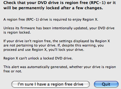

The first four changes are written to software, the fifth change (on supported hardware) is written to the drive. It works with Leopard as well, it's just not supported.
From the startup screen of Region X (now version 1.2, Leopard compatible)
