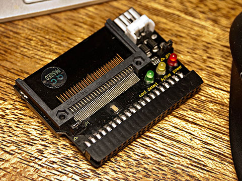

Of course the only way to find out is to try it but I think it should work fine. My IDE is fully functional under boot-camp Windows in XP, Vista 32, and Vista 64 on a 2006 MacPro.
I've had the Superdrive fully recognized. I currently have a Pioneer CD/DVD unit and also this thing:
and they both work fine. <shrug>
