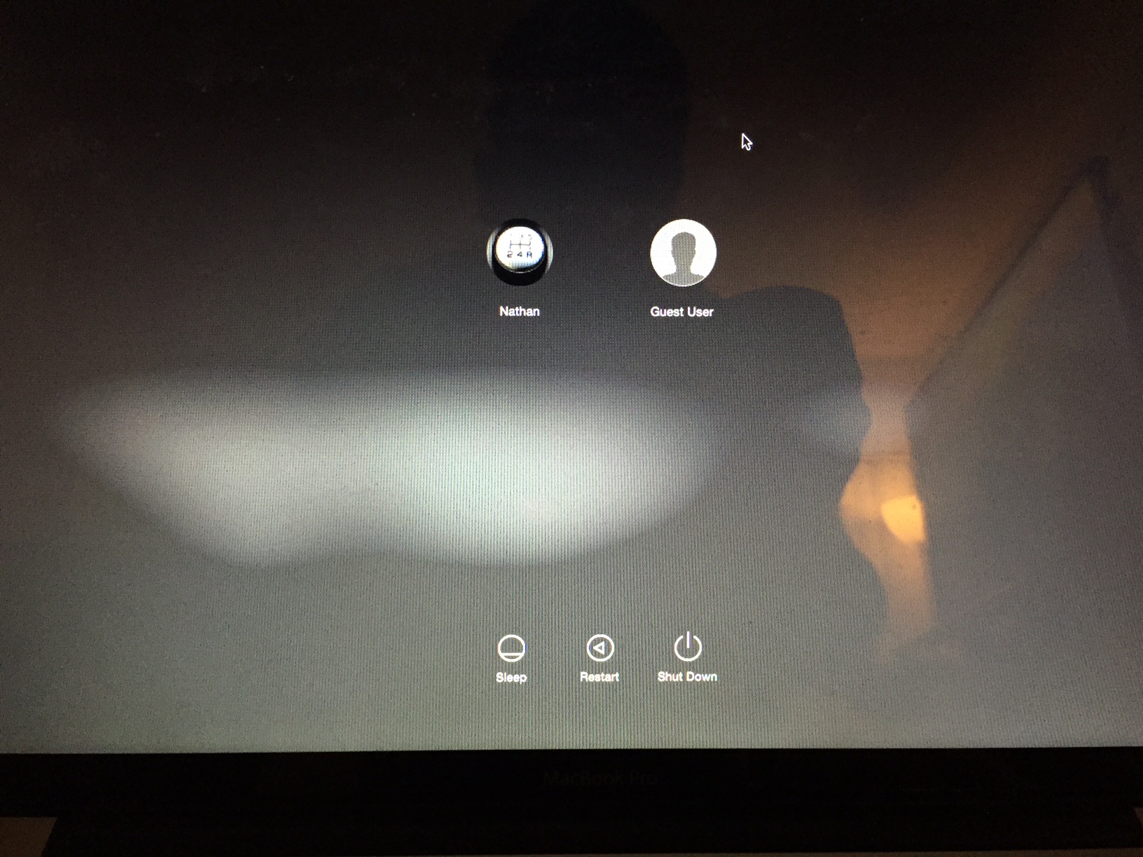

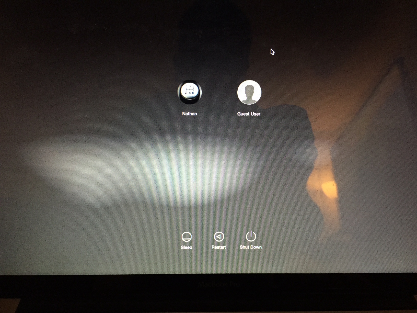

I'm starting to have concerns that it may just be more than age affecting my computer. After a restart, I noticed this on my screen. It appears that something is burning into my screen. I've also noticed the rear Apple logo "ghosting" into the screen lately. Is this just a sign of age or is this possibly a logic board issue? See the attached photo.
Also, I assumed that the pinwheeling, lag, low boot times, keyboard input and just overall poor performance was due to the age and the current hardware but I am starting to wonder if there is some other issue at heart. It just seems extremely weird having just Chrome, App Store, and iTunes and/or Spotify open
