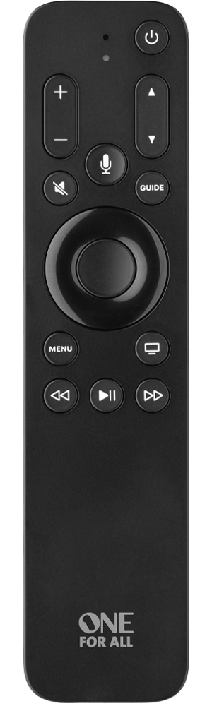

One For All also do an AppleTV remote.
Thanks. That would be perfect for me. But, I live in Thailand and am still looking for someone who will ship here.

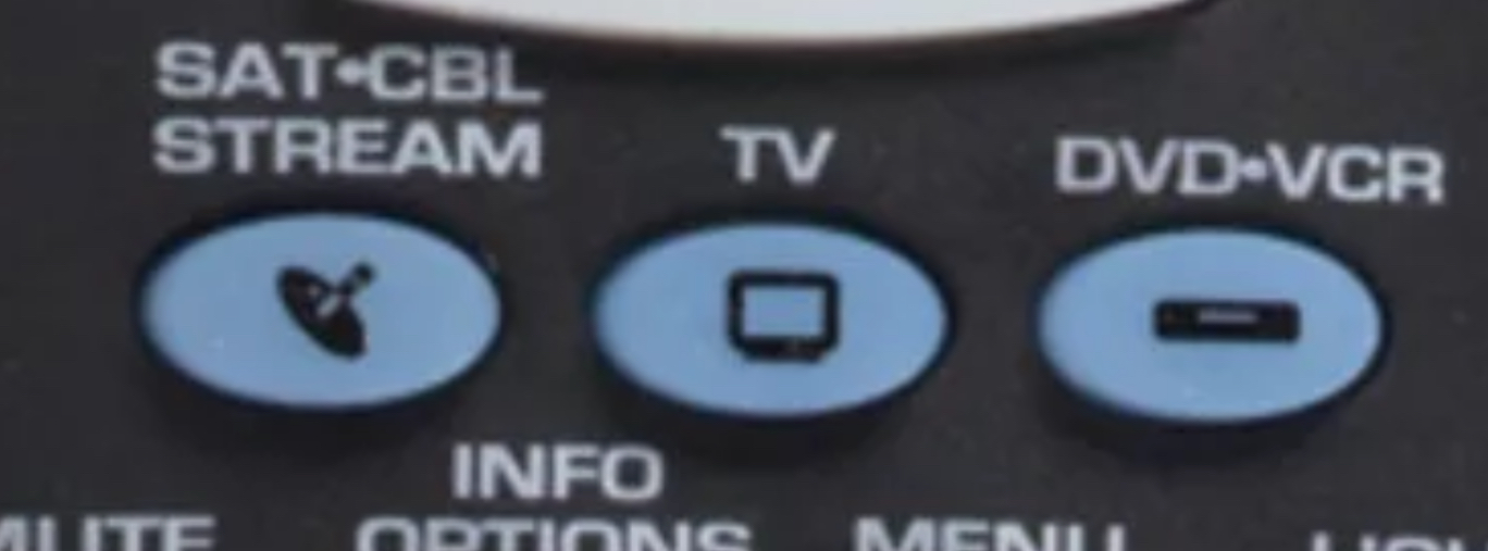

There are no channels to change on AppleTV. But if you mean you want a remote that can also change channels when using other sources- such as a cable connection or cable-like streaming service- ANY remote (other than the AppleTV remote) will have channel (change) buttons.
In a typical universal remote, you'll have some "mode" buttons and one might be a button called cbl or sat (for cable or satellite)...
full
Put it in that mode programmed for that source (where you have channels) and buttons like channel change will change channels. When wanting to use AppleTV, a typical universal mode is AUX or STM/STR, and then the buttons that AppleTV can process will work with AppleTV. "Change channels" is not one but "up" & "down" is often used when streaming apps with apparent channels present a DVR-like grid of "what's on."
And again, AppleTV can do something different than how we traditionally set up any universal remote. It can "learn" the remote instead of having the remote "learn" AppleTV. So you can buy (or may have) ANY remote- ideally one with buttons to control disk/vcr type buttons too- set up its AUX or STRM button for any old disc/VCR/DVR and then use the "learn remote" features of AppleTV tvOS to learn the commands the remote generates when you push buttons that work with AppleTV. Technically, a button you push might be trying to tell as Toshiba DVD player (you don't own) to fast forward, but AppleTV "learn remote" will (be taught via AppleTV learning to) "see" that as "fast forward whatever user is watching on AppleTV." Clicking menu on that remote might be an infrared command for that Toshiba player to go to menu... but AppleTV will interpret it as show the AppleTV menu. Etc.
