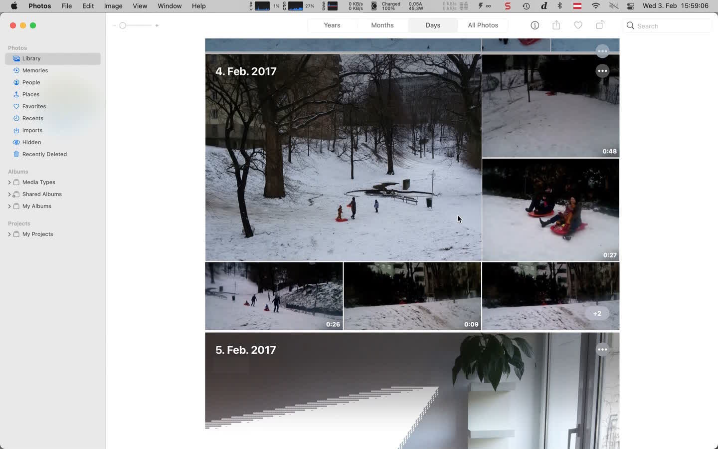

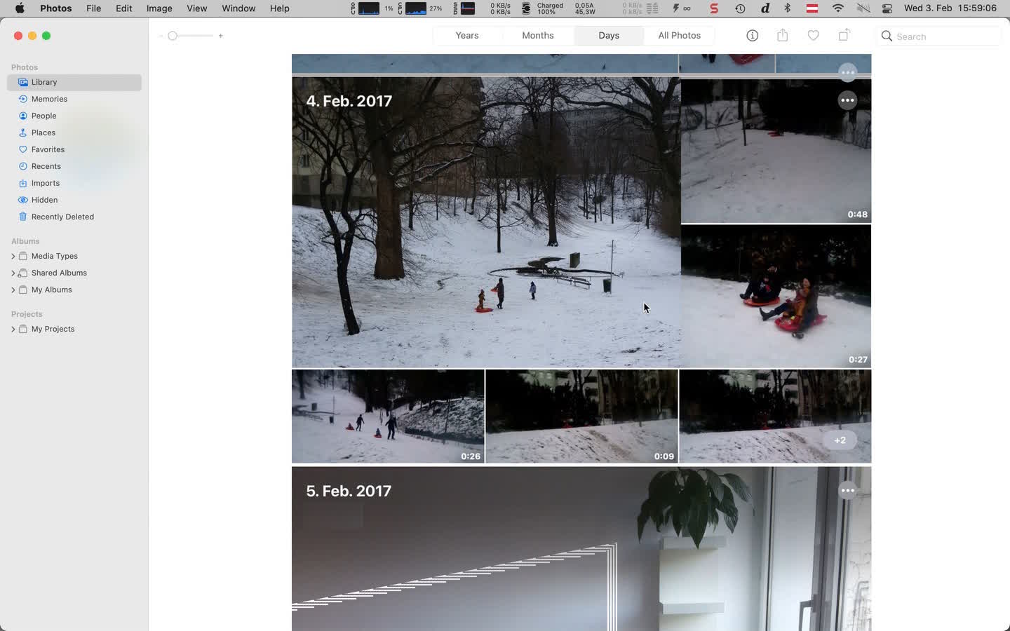

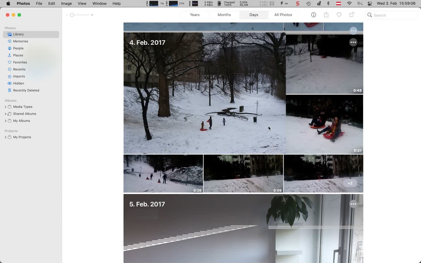

GLITCH I in Photos.app​
Always correct behavior on iGPU (100% reproducible)​
  • Disconnect power adapter to run on battery
  • Launch Photos.app, it runs on the iGPU
  • Switch from "Months" to "Days" view and later back again
  • Perfect animation, always

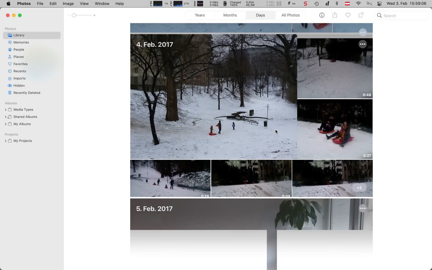

Always faulty behavior on dGPU (100% reproducible)​
  • Connect power adapter
  • Launch Photos.app, it enforces dGPU
  • 1a) Switch from "Months" to "Days" view and back again
    • During the transition within the content canvas of the single-window-app:
      • The upper ca. 30% and lower ca. 30% off the canvas show the faulty behavior:
      • Random white/grey lines, triangles or rects overlaying some of the photos.
    • Sometimes this does not happen at the first transition, but just scroll up or down a bit, and then transist, and latest at the 3rd-5th repetition you get the glitch.
      • And if you then transist back and forth, without scrolling inbetween, you always reproduce the glitch

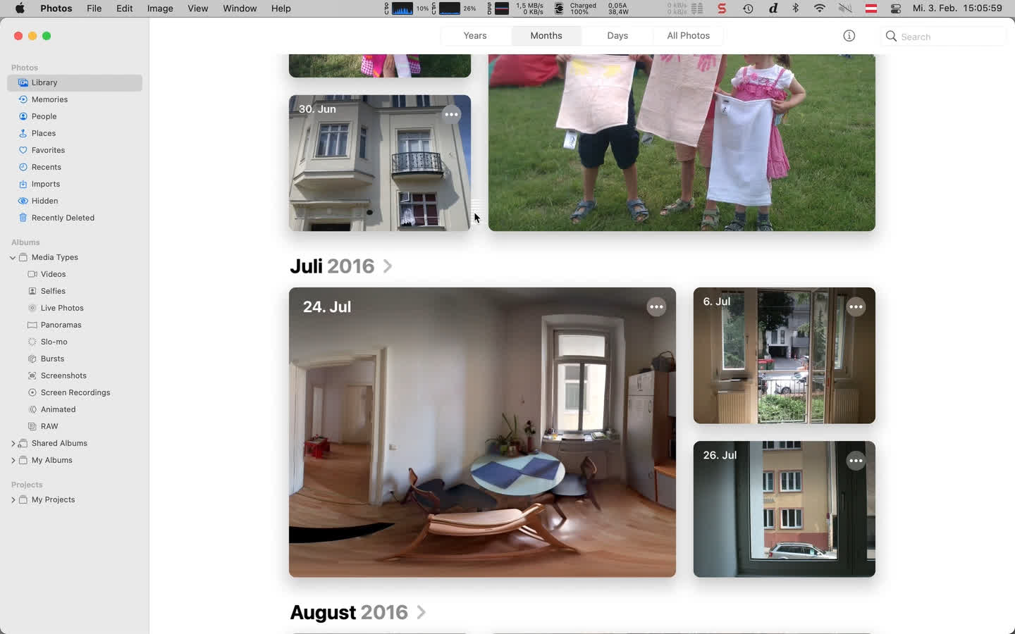

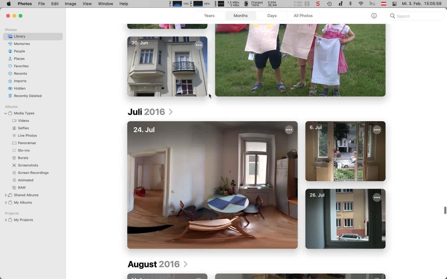

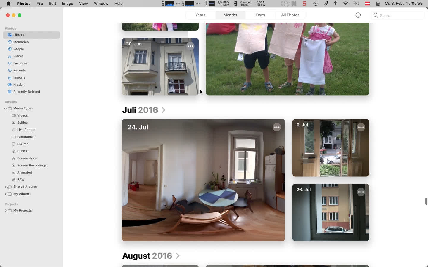

  • 1b) If you are already in the bug and then scroll within the "Months" view, then the gap surfaces between the photos flashes in full white or with white zig-zag lines.

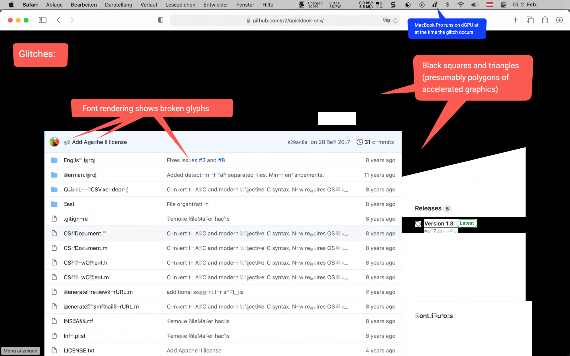

GLITCH II in Safari​
Not reproducible. But when occurring certain environment commonalities are observable:
  • Experienced this twice within 8 days while using my computer ca. 6 days a week for 6-10 hours a day.
  • Both times happened on GitHub.com, though on different project pages.
    • Not on other domains, and I sure visit 100 different domains/websites per day.
  • Always occurred while on dGPU:
    • On 2020-02-03 I ran on an external display which enforced the dGPU.
    • On 2020-02-11 I ran on the internal display, had Photos.app running in the background (I explicitly mean the GUI, not the daemons like photoanalysisd), which enforced dGPU.

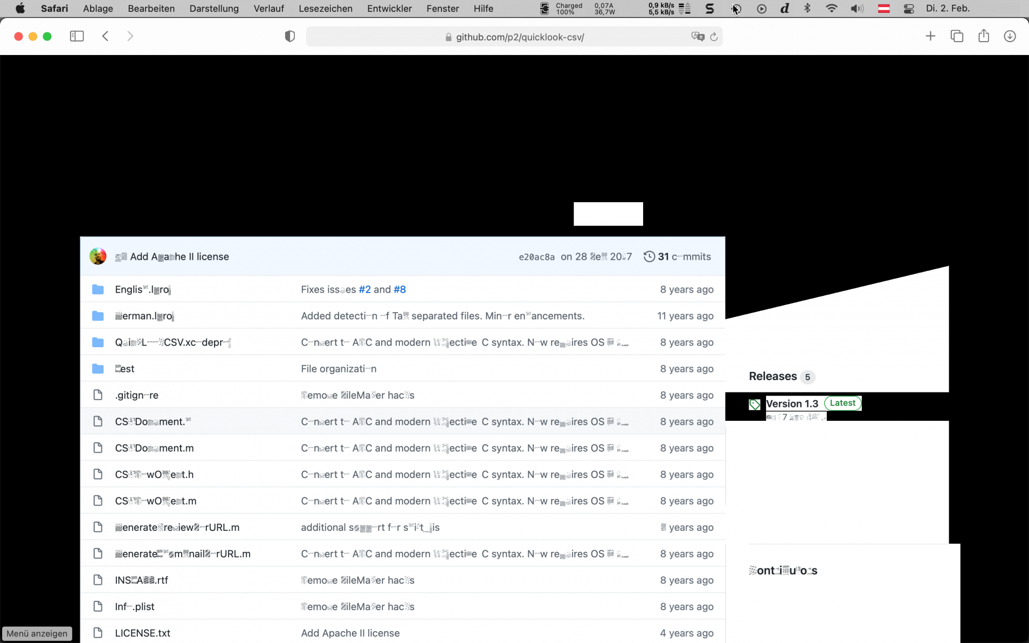

2) Visible glitches​
  • Black squares and triangles (assumingely polygons of accelerated graphics)
  • Font rendering shows broken glyphs

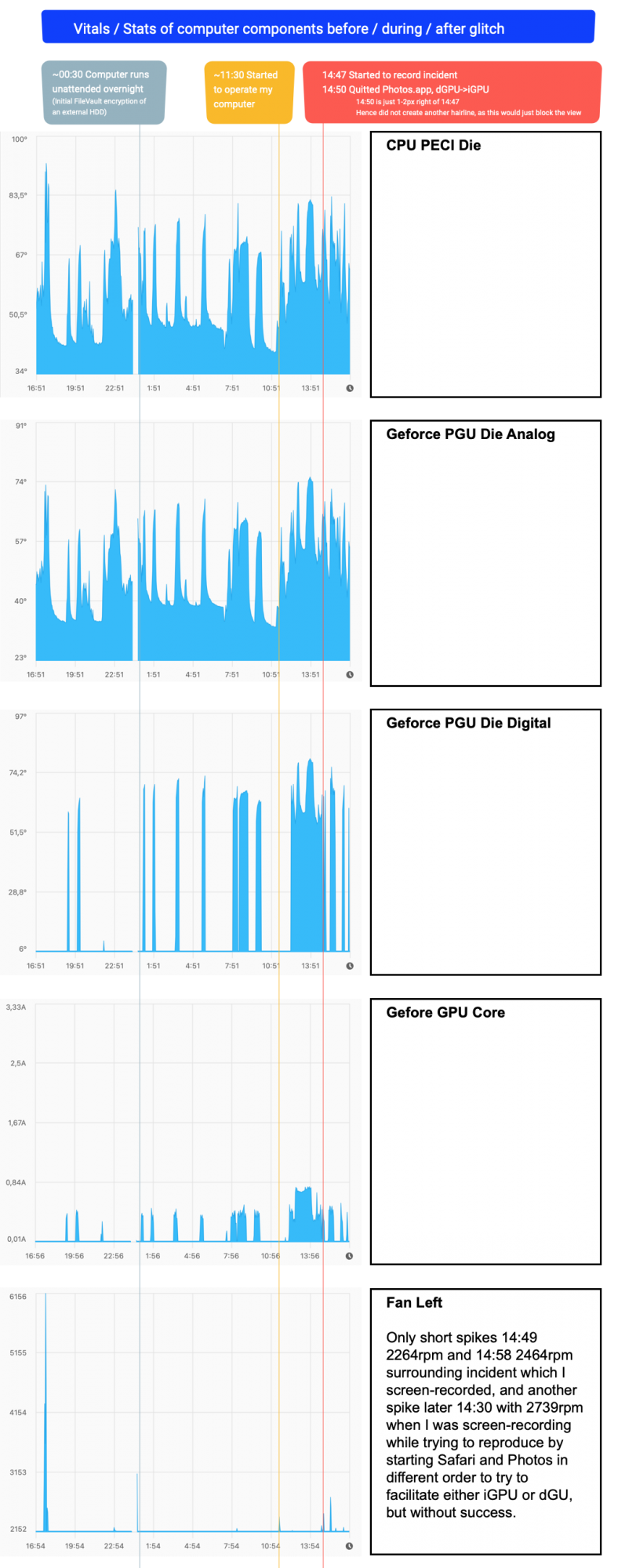

3) Workaround:​
  • 3a) When Safari suffers the glitch
  • 3b) Switch from dGPU to iGPU
    • I did this while running on power adapter effectively by quitting the only dGPU dependent app Photos.app
  • 3c) Thermals were unsuspicious while that time. Fans very relaxed.

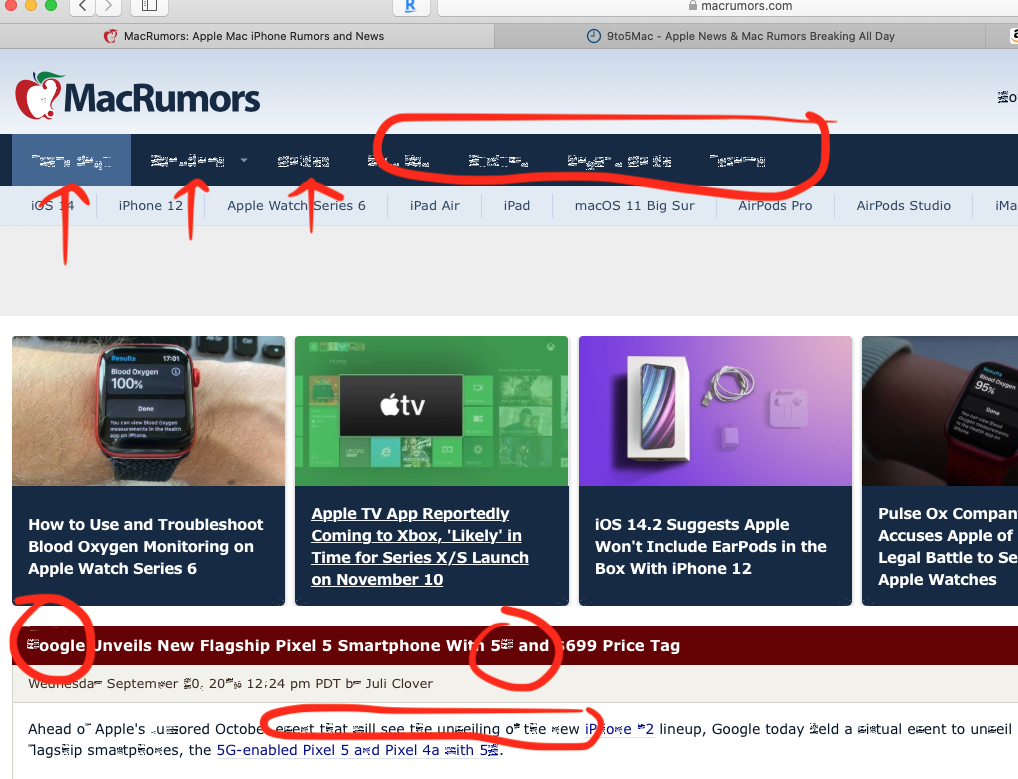

4) Also other people on the Internet report the same symptoms​
All of late 2020 or early 2021, so very likely all related to recent Safari and macOS Catalina / Big Sur. And in many cases mentioning NVIDIA GPUs.

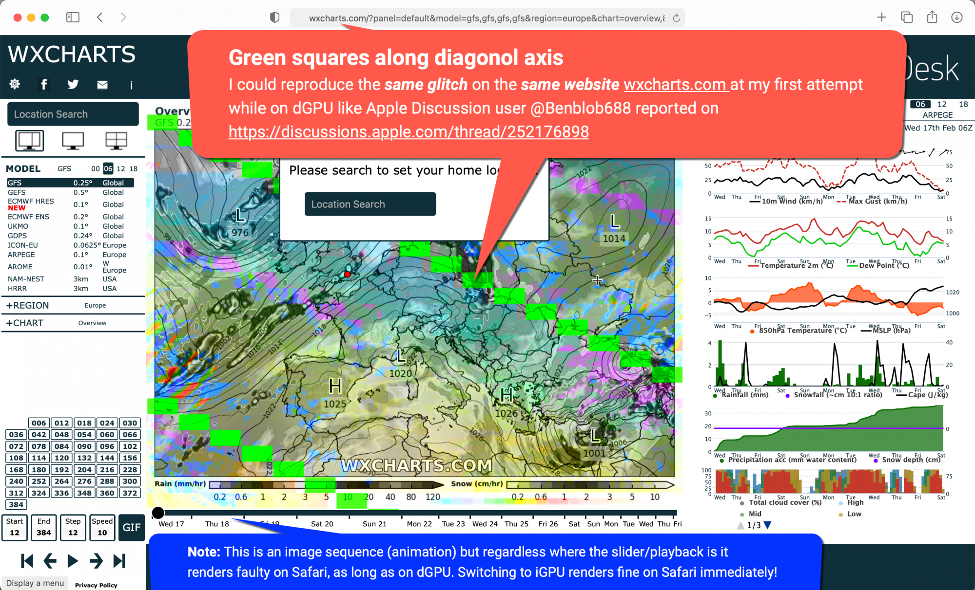

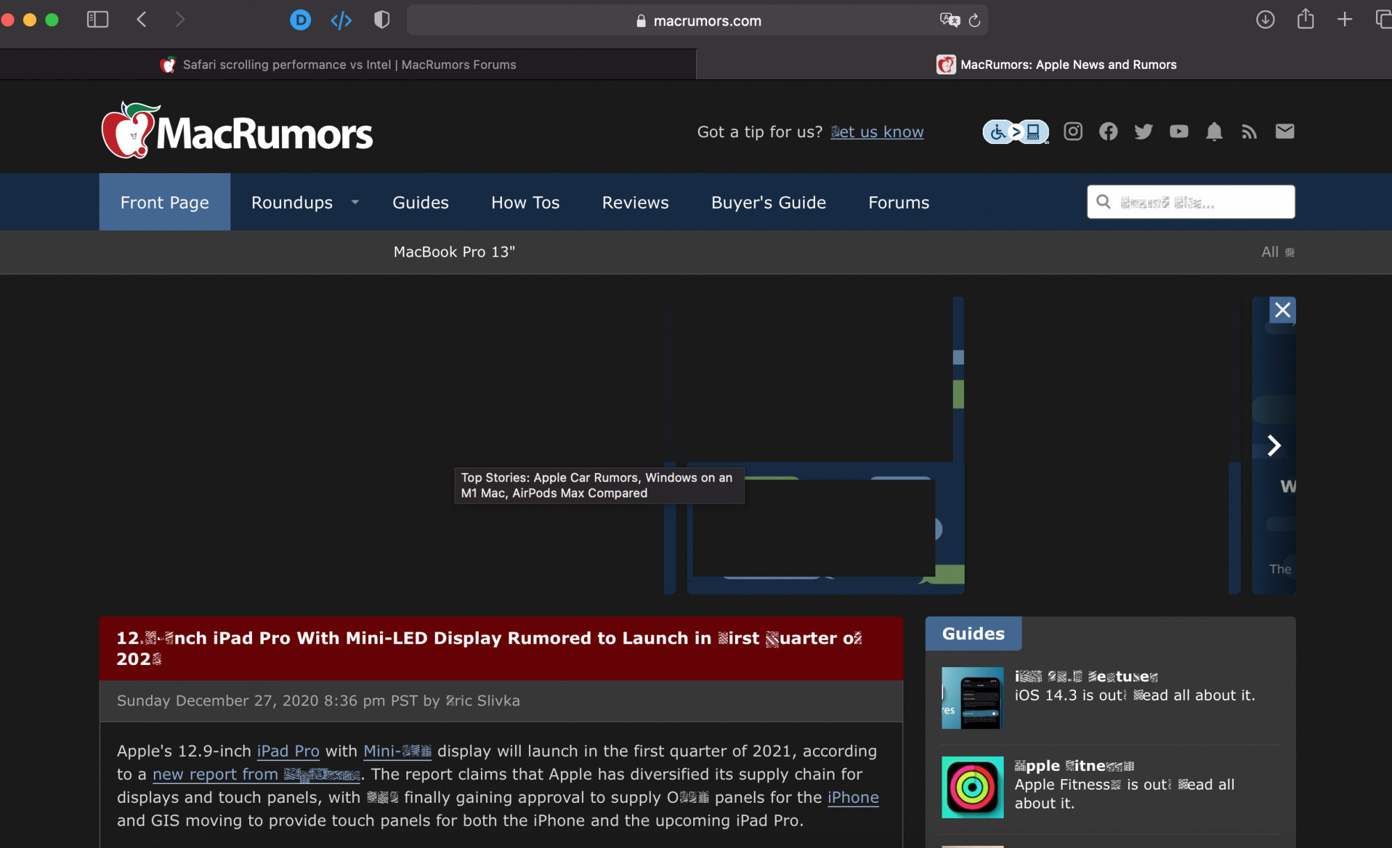

GLITCH III in Safari​
Always reproducible!

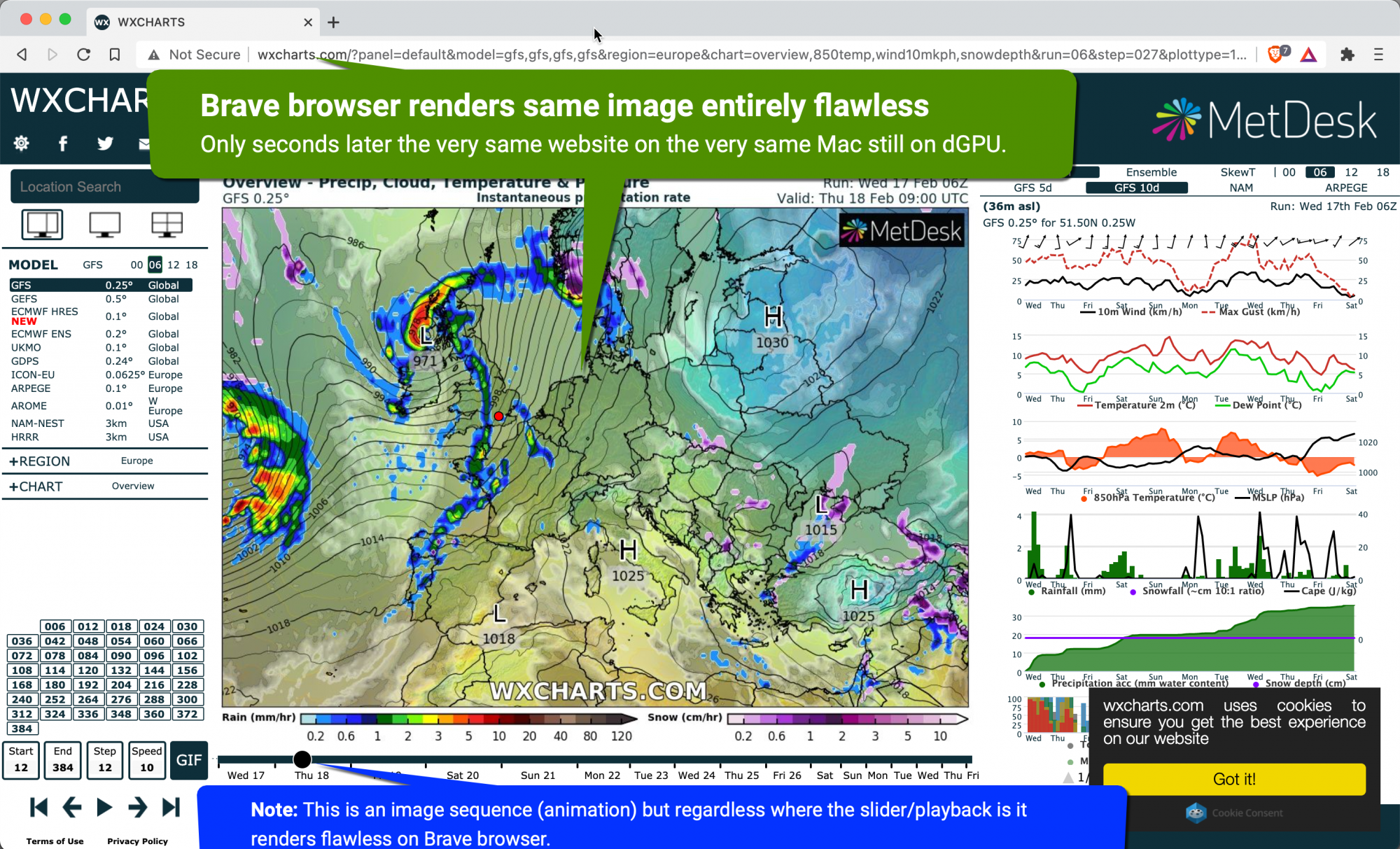

  • 5a) I now have a stable reproduction:
    • With your external display connected, hence the dGPU on, open Safari
    • Open wxcharts.com (a weather website)
    • The satellite/weather image sequence shows a rendering glitch: Green rectangles (ca 90x50px) along a diagonal axis are shown above that satellite/weather image sequence. Regardless where the playback/slider is.
      5a dGPU WxCharts Safari glitch - Image has overlay of green rectangles along diagonol axis.png
  • 4d) exactly as user @Benblob688 reported on https://discussions.apple.com/thread/252176898
  • 5b) For comparison, while still on dGPU the same website renders flawlessly on Brave Browser (Chromium web engine)
  • In Safari: As soon as you switch to iGPU by disconnecting the external display, the window re-renders instantly, and all is fine!

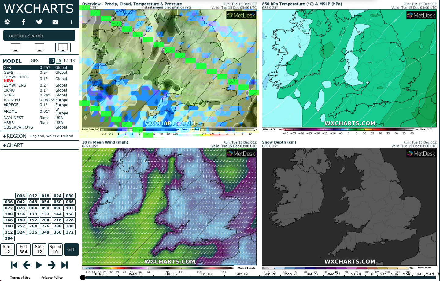

i experience the same glitches now and then, most notably the green rectangles in safari, using my MBP i7 mid-2014 and big sur.
can’t say i did under catalina though.
  • Sad
Reactions: porg
I have a 15" Late 2013 MBP and I have the same bugs since upgrading to Big Sur (Mojave -> Big Sur since I wasn't ready to lose my 32 bits apps yet for Catalina). I suspected a bad install but I just updated to 11.3 (full install from the app store and not an upgrade from System Update) and the problems are still present.
Problems:
- I got the weird black triangles bug once just after upgrading to Big sur, but it was system-wide and not just in Safari. A reboot fixed it and it didn't happen again
- I get the green/pink diagonal rectangles bug in Safari regularly. It disappears when I switch to integrated graphics
- I got the weird glyph bug in Safari just a couple of times

This seems to be an issue with Nvidia graphic chips as that seems to be the only common element in what people who have given specs who have this issue. Some have seen it in other programs but safari seems to have the most issues. I finally got tired of it and went to Firefox. Haven't seen a graphic glitch since.
I encountered these problems when I upgraded eventually from Mac OS X Catalina to Mac OS Big Sur V11.4. The most apparent problem is with BBC News website using Safari. I thought it was safe to upgrade to Big Sur after testing Big Sur on my MacBook Pro 13-inch, but it only has the Intel Iris iGPU, and not a dGPU. So I wasn't aware that there was going to be a problem on my MacBook Pro 15-inch with iGPU and dGPU installed. Fool!!!!!!!!!
My spec is as follows:-
MacBook Pro (Retina, 15-inch, late 2013)
Graphics
NVIDIA GeForce GT 750M 2 GB
Intel Iris Pro 1536 MB
The problem becomes apparent when my external monitor is attached, therefore using the NVIDIA dGPU. Disconnect the external monitor and the Safari window appears on the internal Retina display. The problem remains for a split second and then all is fine on the Retina display. If I then go to System Preferences-->Battery and disable "Automatic Graphics Switching" this forces the MacBook to always use the dGPU, and hence the problem appears on the internal Retina display. I think the problem is specific to how Safari is responding to some HTML features used by some web sites.
The bad news is that the problem is not fixed in Safari V15 so far. You can obtain a copy of the "not yet released" version from Apple called "Safari Technology Preview."
I raised the problem with Apple Support using Case ID 101420288005. I also provided feedback via "Apple Feedback Assistant" on the Safari V15 "Safari Technology Preview" version.
After much interaction removing "Login Items", Safe Boot, etc the Apple support technician agreed that the problem appeared as I had suggested. His response was to raise the issue with the BBC News web page developers. And perhaps I should reformat my hard drive (SSD) and do a completely clean install of Big Sur.
If you go to the "Official Apple Support Community" and search for "green rectangles on safari in big sur" you will find a significant number of threads with people experiencing the same issue. And thousands of hits!.
Regret the only way that this is going to be resolved is if many of us raise support issues with Apple to complain. RIP Steve Jobs. Not sure this would have happened on "your watch"!
Reactions: Tuli
I have the same problem. Macbook Pro 15 inch 2014 with Geforce GT750M. I typically get ths only on Safari when visiting Macrumours.
