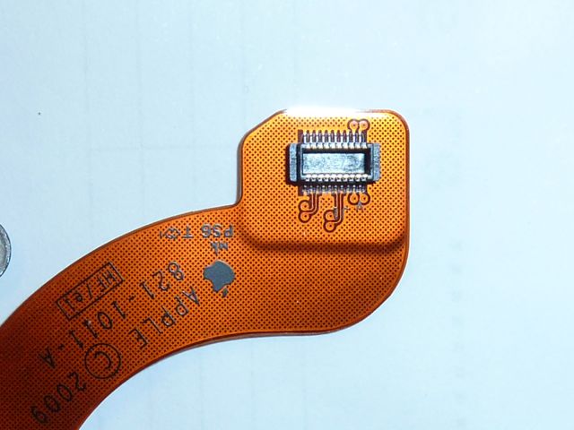

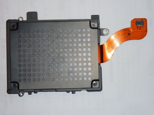

This thread is very interesting to me, although I'm not 100% sure it brings the solution to my problem, so here I ask:
My first MBA died (motherboard, RIP) but the SSD Drive is still good. I want to use it as hook it up an external drive to my new MBA. So the question is: can I plug my old SSD drive in a Renice external case ?
I kind of doubt it given the connectors of the drive (see attached pics), but I hope someone's going to tell me I'm wrong...
Xavier
