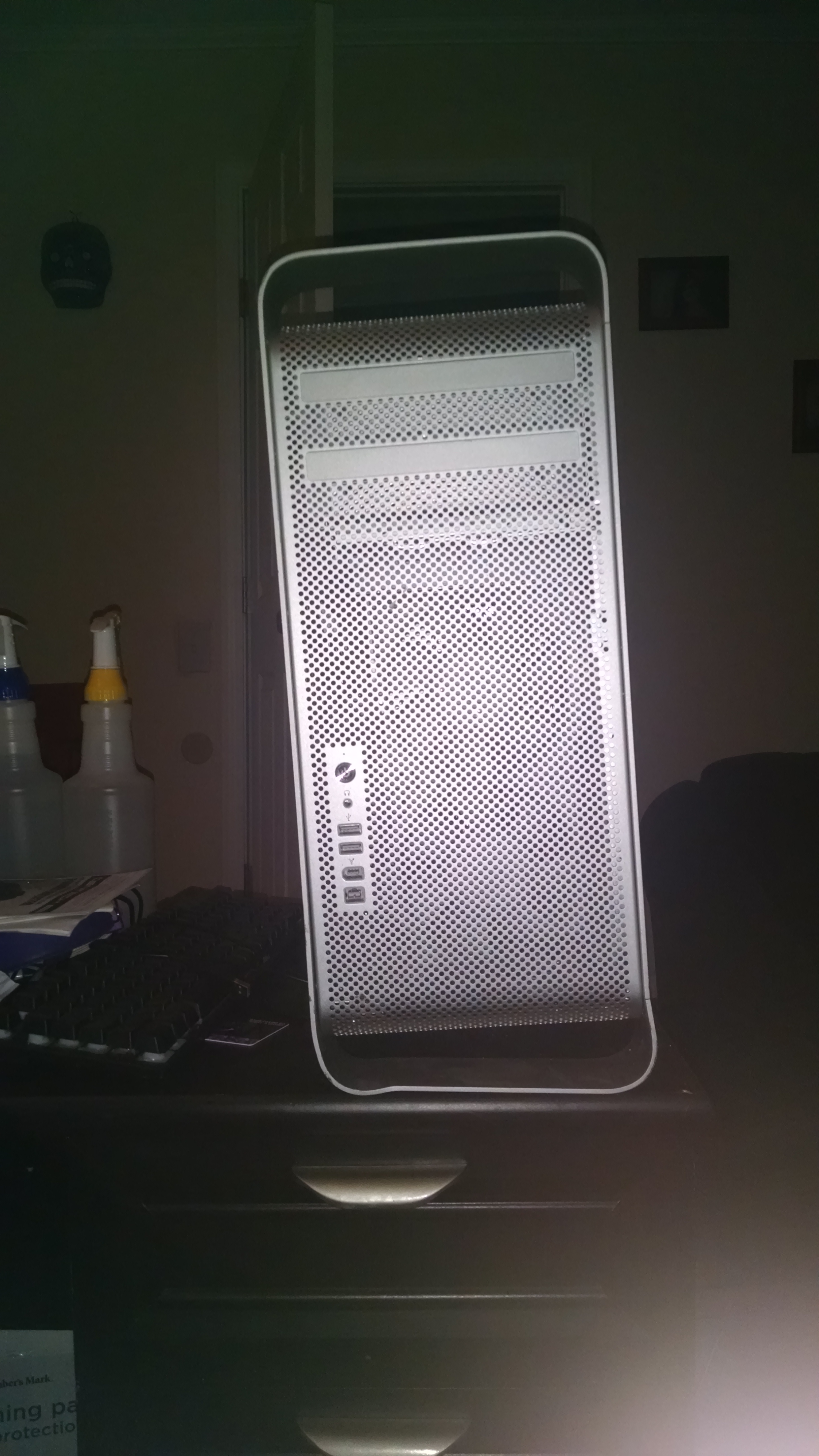

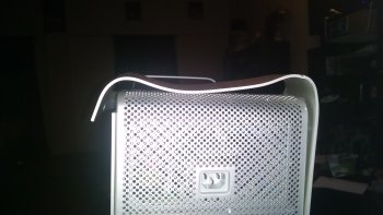

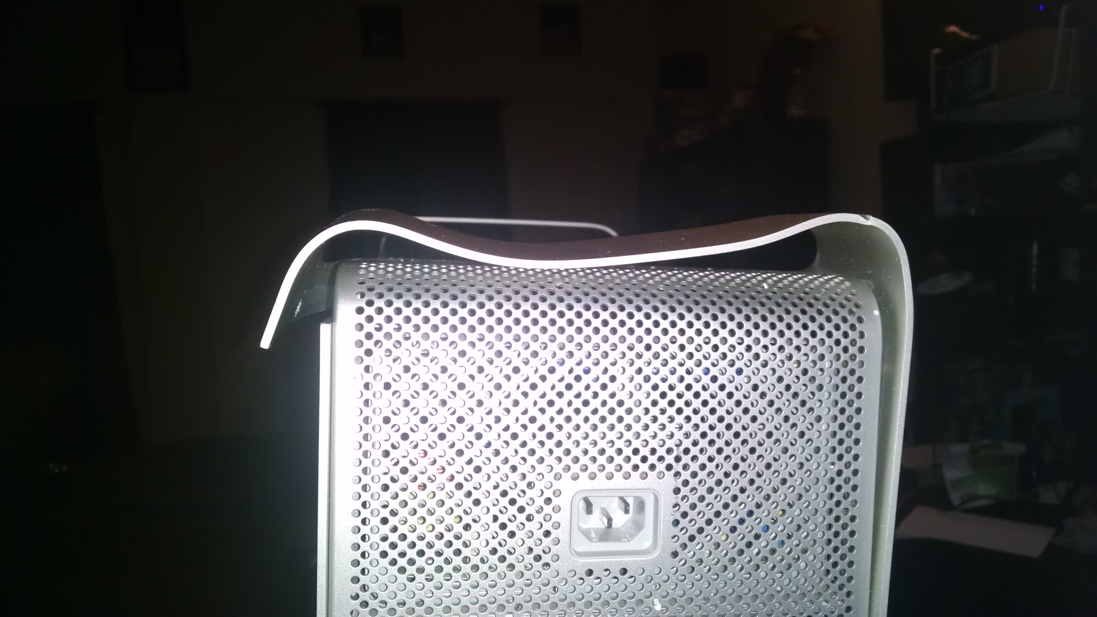

So UPS delivered my first Mac today.
And all of my joy and excitement was sucked away, as I opened the box only to find it damaged.
While the box looked pretty decent (no obvious exterior damage, save a weak-looking corner), packed somewhat tightly with solid sheets of 2" styrofoam on all 6 sides, with peanut filler, the unit had clearly taken a fall.
The front foot had been bent slightly, giving the whole unit a leftwards lilt. But the top rear handle had been crushed down nearly flush with the top of the case, and forced the side of the same handle out and down, preventing the case from being opened.
The unit still appears to boot, and the few minutes I spent with it, everything inside seems functional. So, small miracles, right?
But I'm definitely going to need to get into this thing soon for upgrades and hard drives, and I definitely can't bend this thing back into shape with my bare hands. (Though I did give it a shot.) I figure it's going to take a pry bar, but I'm also pretty sure that just screw up the case more.
Does anyone have any tips for reshaping this? Or am I better off trying to hunt down a whole new case?

You will never get the handles reshaped, the rivets that hold the case together are popped.
Your Mac looks way worse than all 4 of mine.

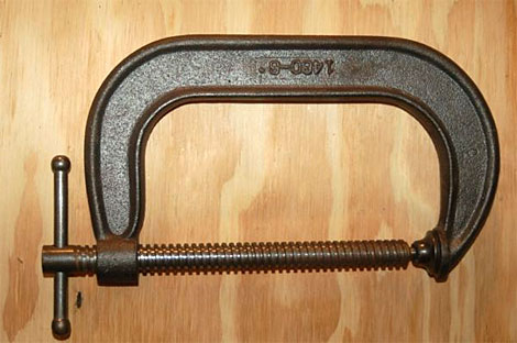

The top, you will need two clamps!
One to hold the side plates together, while you try the other clamp to pull the handle up.
At some point it will look half decent, be patient.
The side where the rivet popped will always stick out, unless you drill a hole and screw it together.
Kind of interesting that the damage is to the front/bottom and rear top.
Yeah, I've been staring at the box since last night trying to figure out exactly how it happened, with no obvious damage to the exterior. You'd have thought something that crushed the top like that would've tore through the box.
Pretty certain it wasn't repackaged, though. And pretty certain it didn't occur before shipping...or at least before it was in *a* box...no marks or scratches on the top to indicate direct contact with something.
Regarding the bottom front damage, now that I think about it....
None of the pictures in the auction show the front bottom fully, and it would be pretty easy to shove something small under it to level. Front damage could very well have been hidden and not disclosed. Not necessarily what happened, but not much of a stretch either.
