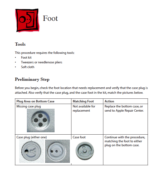

On second thought, is this an option? (I've never bought from this site before)
It is, because Apple’s own service repair guide suggests this glue-on solution.
If you’re familiar with how the OEM feet/base plug combo are assembled, the OEM rubber foot contains an off-centre prong which gets mechanically pressed through the base plug’s respective hole (also off-centre). The foot’s prong spreads outward and is wider at the tip. This tip anchors the foot to the base and holds the foot to the base plug hole from the inside. If you pull one out, it’s not impossible to re-seat it back through that hole, but it is prohibitively difficult.
In short, no glue is involved in the OEM feet/base combo. Apple realized it would be a lot easier to provide this remedial fix kit using part #076-1070 (i.e., the “case foot” kit, which includes a tube of super glue). It isn’t the same, but it was the only remedy Apple provided.
I’ve been at odds with this fix for a long time, preferring instead to source surviving foot/base plug combos where/if possible (way easier said than done, however).

It's kinda wild how if that tiny little case plug is missing, the whole fricking bottom case needs to be replaced.
