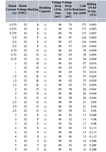

I am having trouble finding one with a white dot. I have found on with a leter "P" on it. I have read in Dadioh 's WLED thread that with a different logic board it was one with a "P" on it.
let me know if you see it anywhere on there, anymore insight or clues would be great. Thanks
Yeah that looked like the fuse. It should measure 0 ohm (good fuse) or open circuit (blown fuse). To fix mine, I just tacked another fuse on top of it and added a tiny bit of solder on both ends. This thing is so tiny that doubling up should not cause any strain whatsoever.

By bridging a blown fuse you mean temporarily shorting the fuse? Never a good idea because whatever is causing the fuse to blow initially may still be present, thus causing more damage to the rest of the circuitry being protected by that fuse. These SMD fuse are fast acting and any overload beyond its current limit would "blow" the fuse within microseconds. You can get the fuse from DIGIKEY, MOUSER or EBAY. The physical size is either 0402 or 0602 (larger), and the current ratings is system dependent (like I said do not have A1369 schematic, but it is most likely 2-3 amp fast blow fuse). The letter P I believe is a 3A rated fuse. See the attached picture that shows the letter coding for 0402 fuse. Not every fuse manufacturer use the letter code for marking the current rating though. Your 2.9 Ohm could be the impedance of the remaining circuit that is being protected by that fuse. I have no idea of that is an acceptable reading or not.
