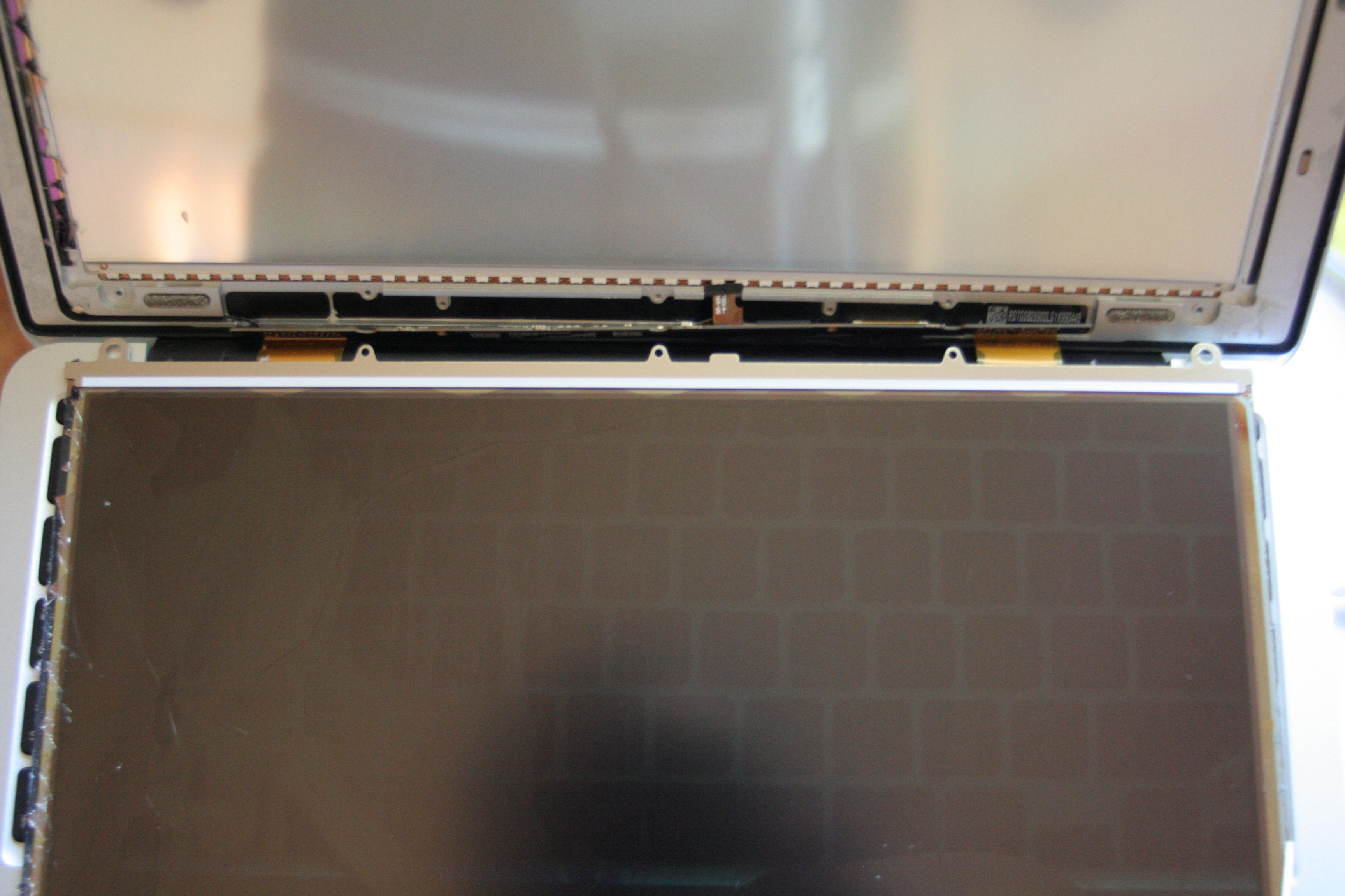

Having tried and completed TWO bare LCD replacements on A1370s, I think next time around I'd probably buy complete display assemblies and do it that way. Neither of my two MBAs turned out perfect. The first one has a partially torn backlight flex cable because it was very short and you have to fold it a certain way to re-attached. I also didn't notice that the bare assembly LCD has a thin clear plastic sheet with a red lettering (probably lot number) and once you glue this into the LCD frame/back there without removing it, there is no going back without damaging the new LCD, so I am stuck with it. It shows thru the LCD display screen.
On the second one, I was quite careful in removing the old one, but it still comes apart in thousand of pieces (exagerating), and again the heat gun damaged/curled the 3-5 sheets of back up milky plastic sheets functions as a diffuser for the LED lights. So when I put all back together, you can actually see the damaged diffuser.
I don't think it is worth doing it again unless you are really experienced and have the right tools. Get a similar MBA with water damage main board and use the hopefully good display in it's place, or go to some chinese website (i think it is alibaba something) and get it from them.
Kapton tape and a rework station with a narrow nozzle work wonders on the 11.6" air. For your third one! 😉
Use the kapton tape on the black trim and around the polarizer to keep the heat out of the important parts, and the rework station nozzle to target the heat. You can boil the bezel without messing up the back layers.

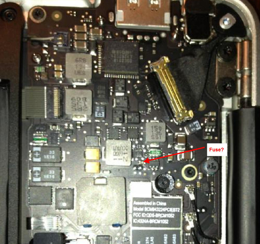

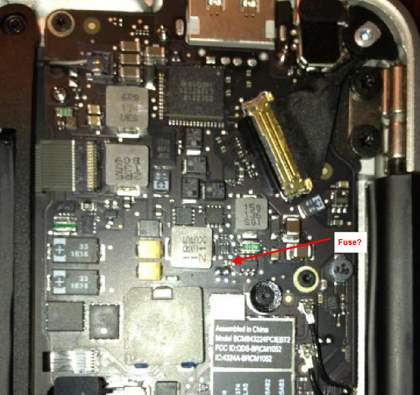

anyone have a pic of where the fuse is located on a 11" air a1370?
i did the lcd removal and it cracked "didnt care it was bad" buti didnt remove the battery connector before hand, after reading this guide i removed the two connectors on the lcd side of the inverter and connected the inverter to the pc side and im not getting a backlight... not sure if the lcd has to be uncracked in tact or if i blew the backlight fuse, any help would be appreciated
i assume its somewhere in the pic location by the lcd connector?

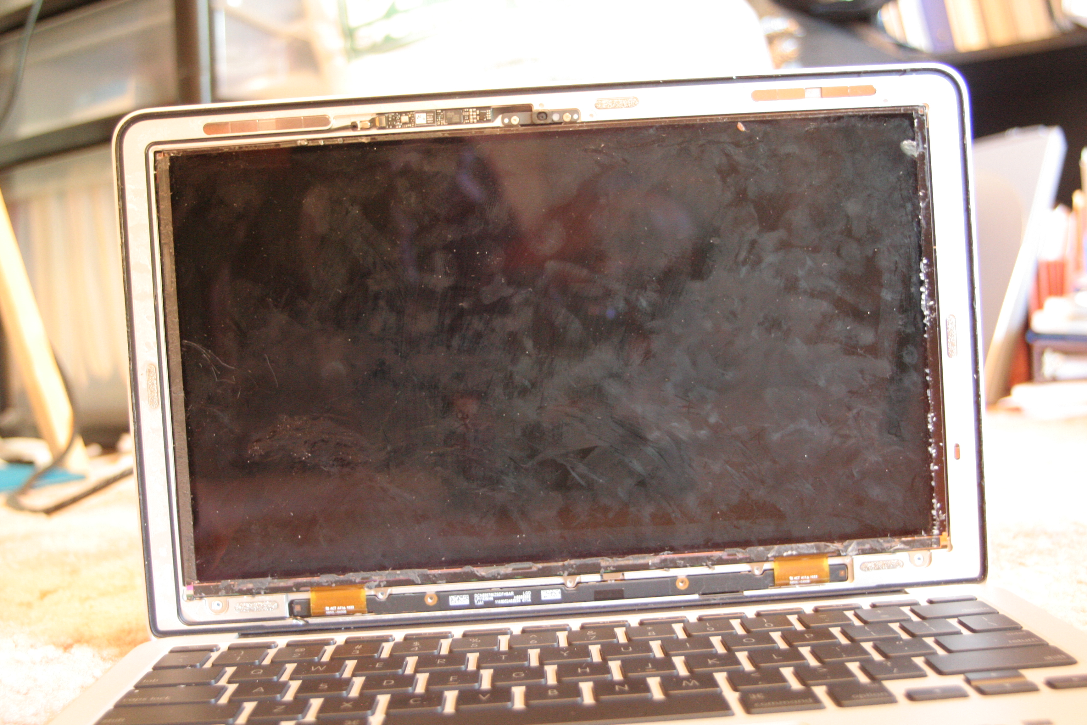

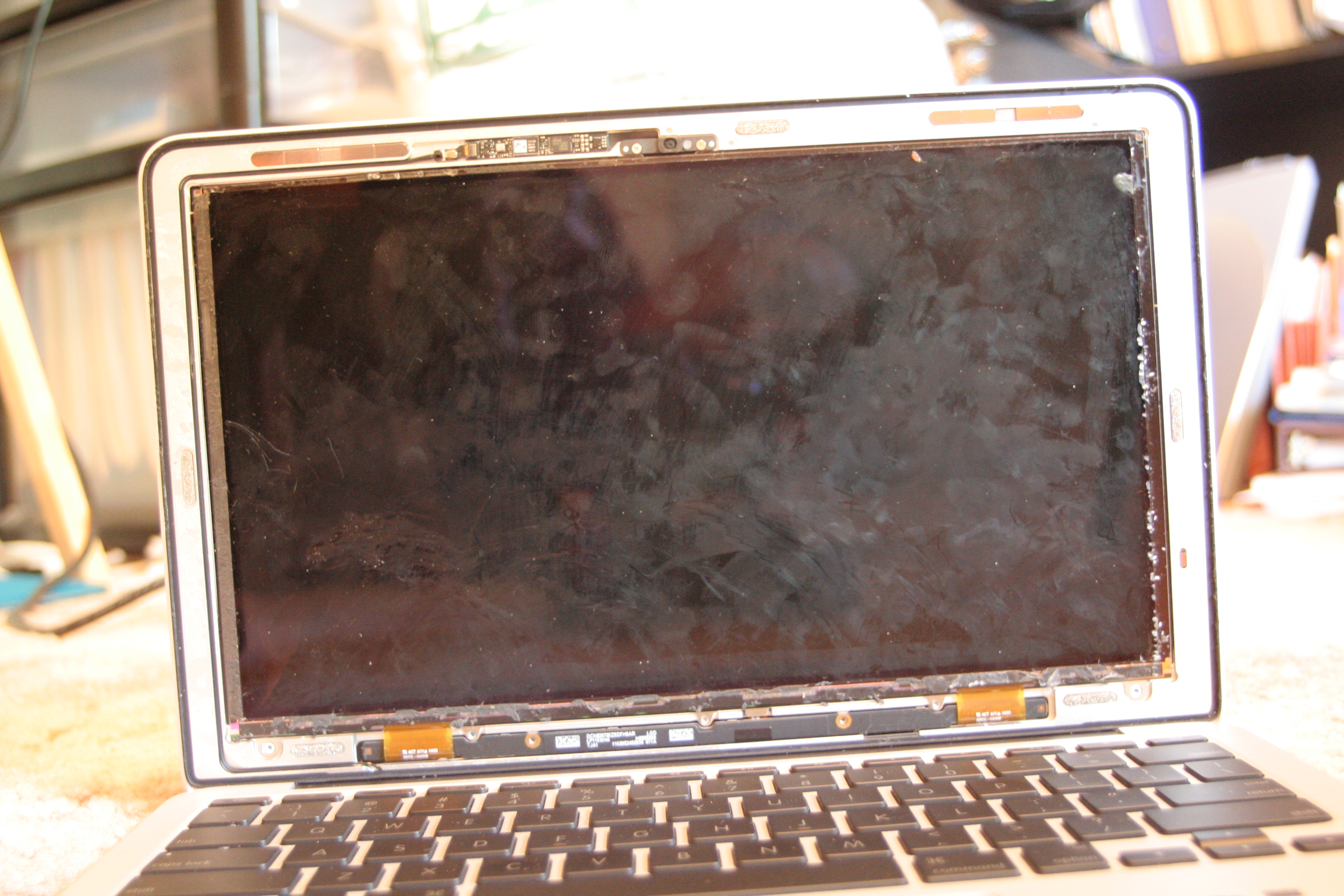

Hi folks, thought I would share my experience with the cracked screen on my son's macbook air 11" 2011.
We had the usual experience of being told by Apple that they would like £500 to repair the unit. As it only cost £675 (educational discount as he was off to uni), I searched the internet and came across the tech restore video on replacing the lcd. I'm pretty good at that type of thing so decided to buy a screen on ebay for £50 from Taiwan. With free post and packing, 8 days later the screen arrived, really well packaged and looking to be the correct one.
Apple have obviously no intention for making the lcd replaceable! Even with infinite patience and care, getting the thing apart was a nightmare. I managed to get the bezel off without damaging the plastic sheets behind the screen, but it is virtually impossible to remove the already cracked screen without leaving shards of glass behind. Anyway, plugged the new screen in and only half lit up. After a lot of trouble-shooting, it became apparent that the new screen had a problem. The supplier was brilliant, another screen arrived within a week, plugged it in prior to assembly and it was fine. Put everything back and could not stop the edge of the screen grounding out on the case. If you look at the old screen, there are a lot of small strips of tape etc that are not supplied with the new screen. After much fiddling about, I managed to crack the new screen as it stuck to an old bit of adhesive!
At this point, I ordered a complete screen assembly from the guys in Taiwan for £250. It duly arrived and with the excellent ifixit tutorial, was installed within a couple of hours and we are back up and running.
My advice is to go for the screen assembly if you have a problem. The observation that I made whilst trying to change the lcd is that without doing it for a living, having the correct adhesive strips etc, your macair is going to peel apart eventually.
Anyway, thought I would share the experience and hope it helps others. Brent
Photo is a bit blurry but I think it is the part I highlighted below. Fuses usually have a white dot, P, or F marked on the top.Looks like this one fits the bill. With power removed, battery disconnected, measure the resistance across the fuse. A good fuse is close to zero ohms. Bad fuse measures megaohms.

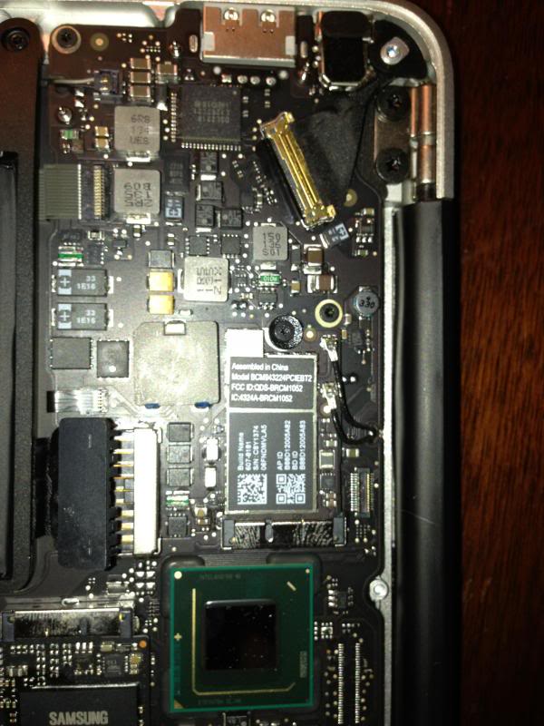

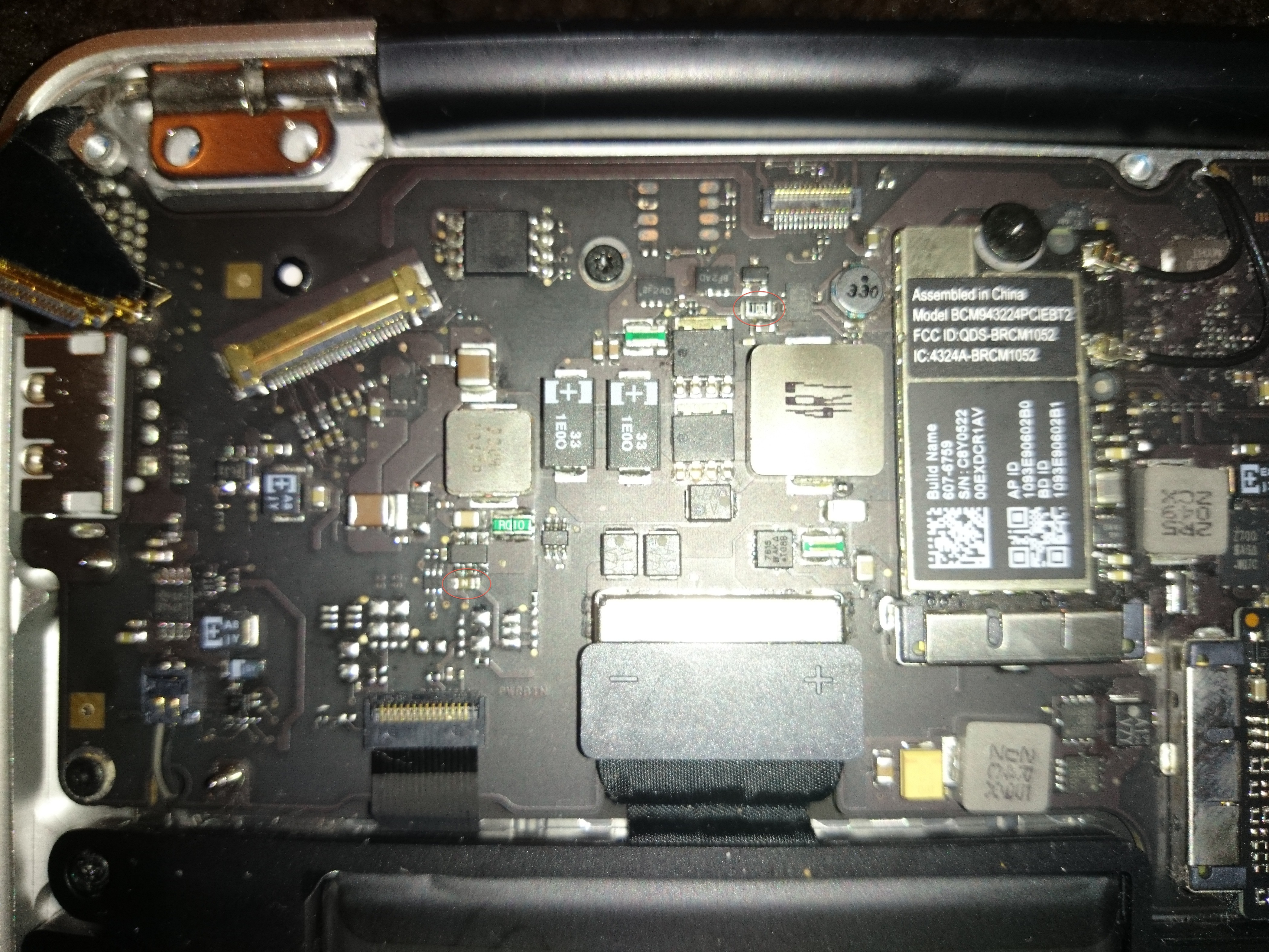

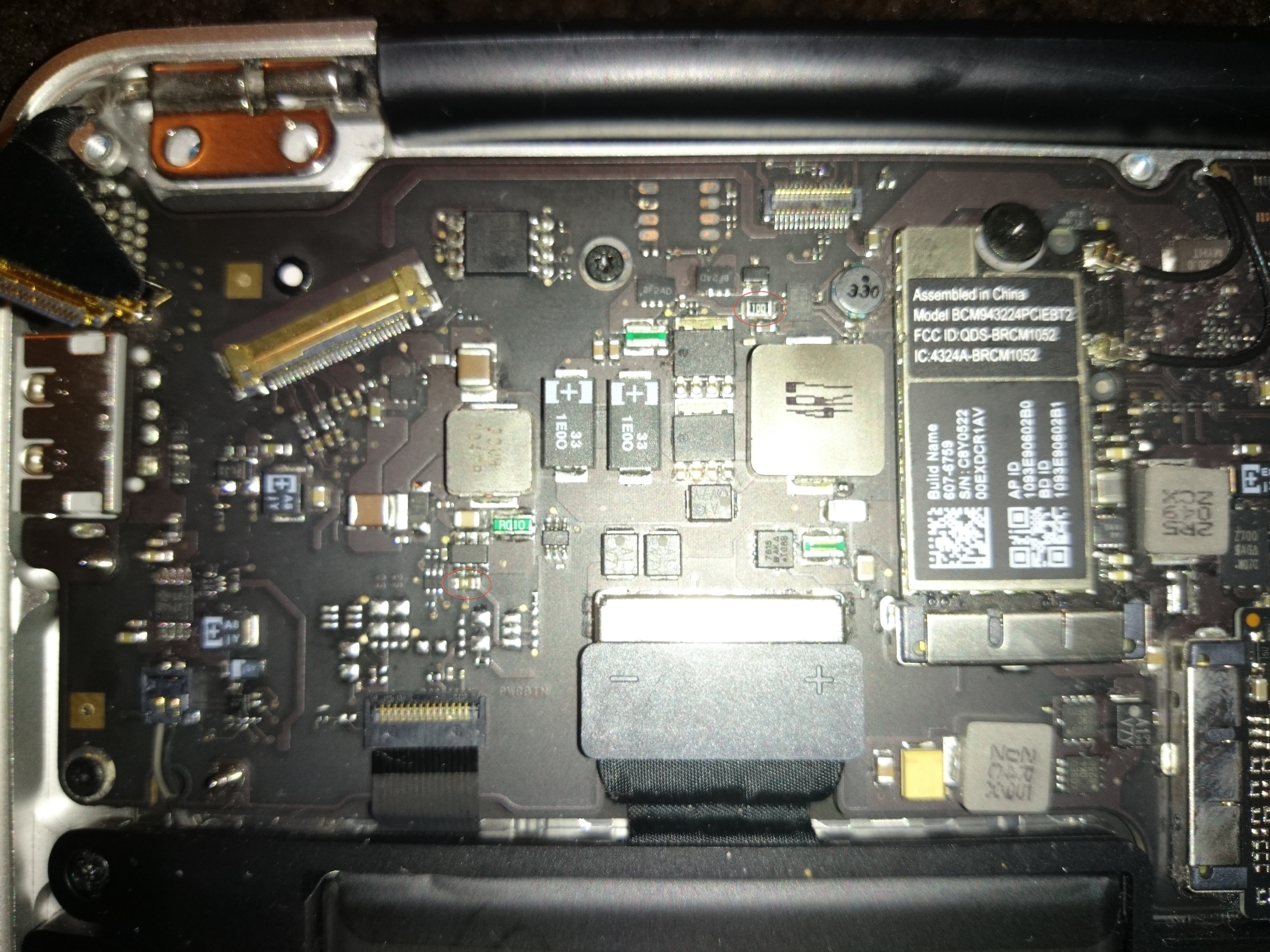

2010 11 inch a1370 backlight problem
hello, cmdrdata, the a1370 you have is a 2010? like this on the picture??
if so could you help me finding the led fuse, and the wled driver please!
thanks will appreciate it! a lot!
