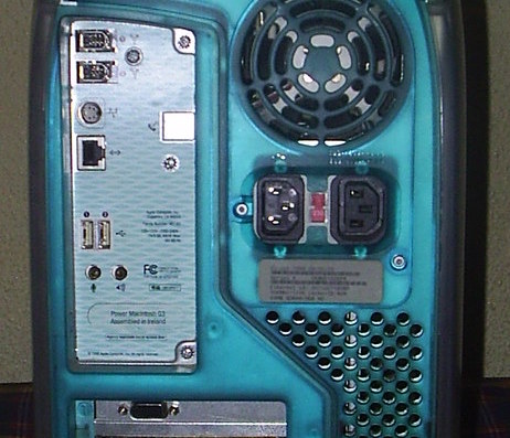

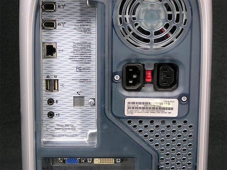

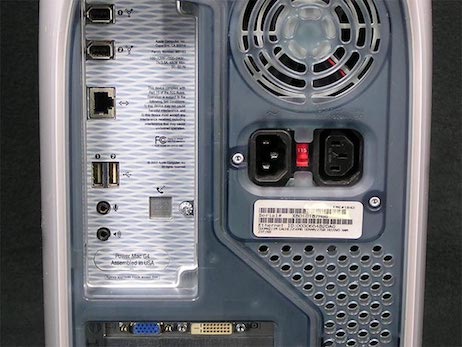

A board from a Yikes! or Sawtooth would be compatible with your power system, as they all share the same pinout scheme for the PSU, and run from similarly specced PSUs. You can't go beyond the Sawtooth, i.e. you can't use a Gigabit Ethernet (a.k.a. Mystic), Digital Audio, or Quicksilver board without replacing the PSU, because: (1) the PSU in your B&W is not high enough wattage to reliably run a GigE, DA, or QS board; (2) the PSU in your B&W is not pin-compatible with those models. You could change (2) by rewiring an ATX extension cable to match the power inputs on the GigE, DA, or QS boards, but - see (1). You just don't have enough juice.
So, unless you're going to swap out the PSU too, you're limited to B&W, Yikes!, or Sawtooth boards. The Sawtooth, though, will require a bit of modification to the back case to accommodate the different positioning of the audio out and modem ports. See the differences below:

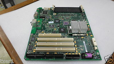

Here is an ebay link to replacement rev B motherboards if you want to keep it as a g3. I found out about them from this thread at os9lives (http://macos9lives.com/smforum/index.php/topic,6191.0.html).
The board form ebay would be perfect, if it had international shipping, as I don't live in the US, so it's a no-go.
