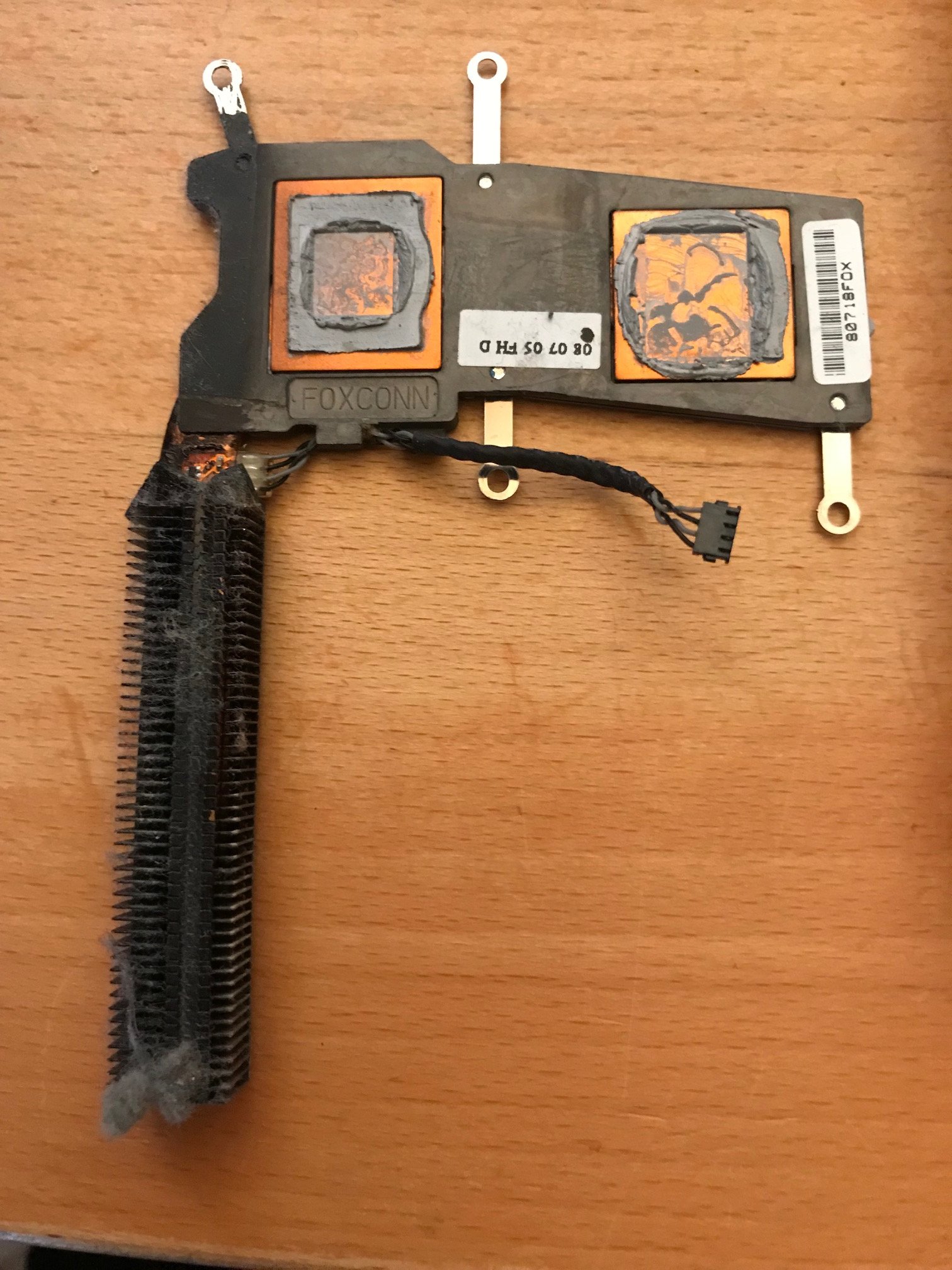

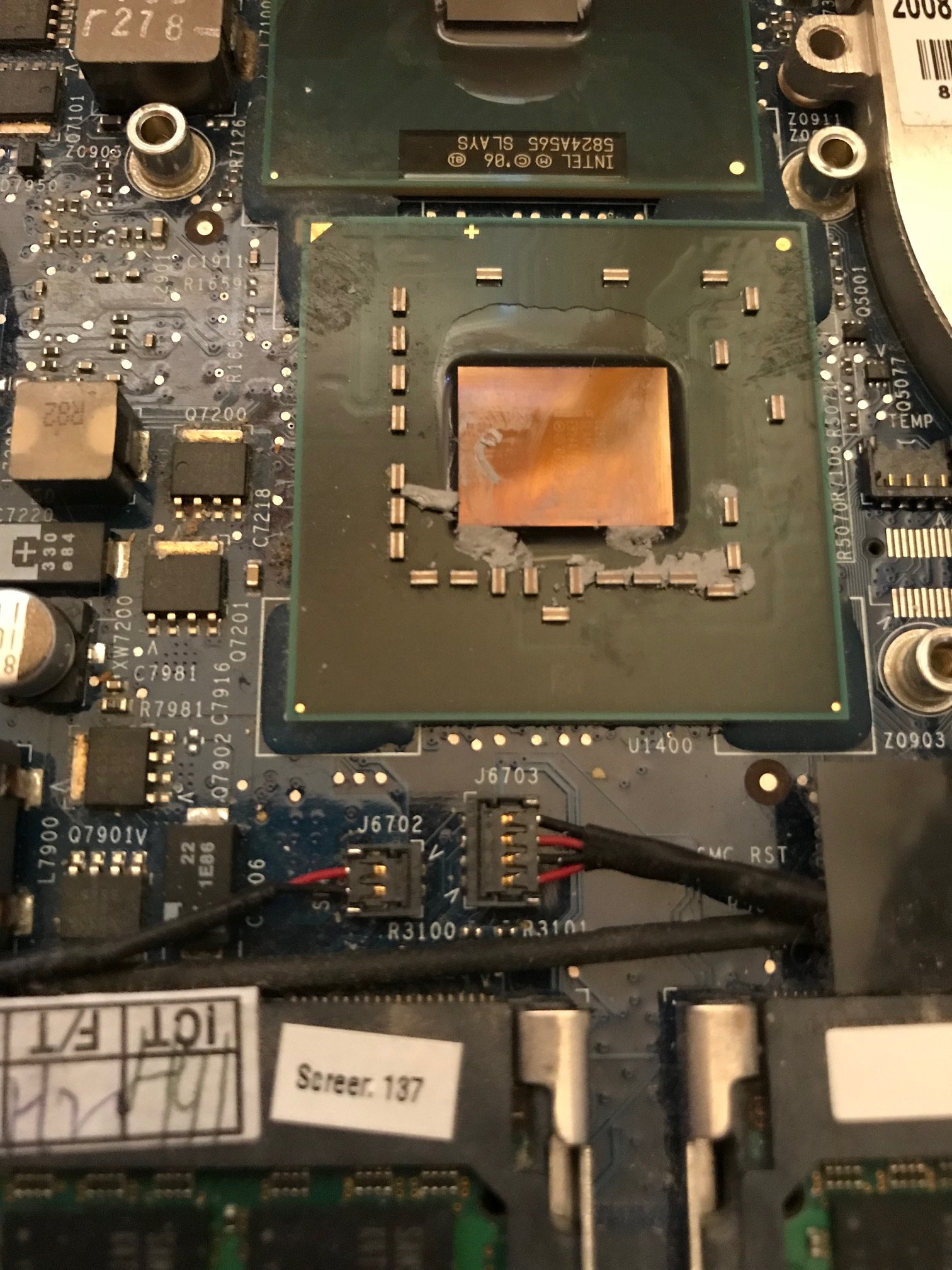

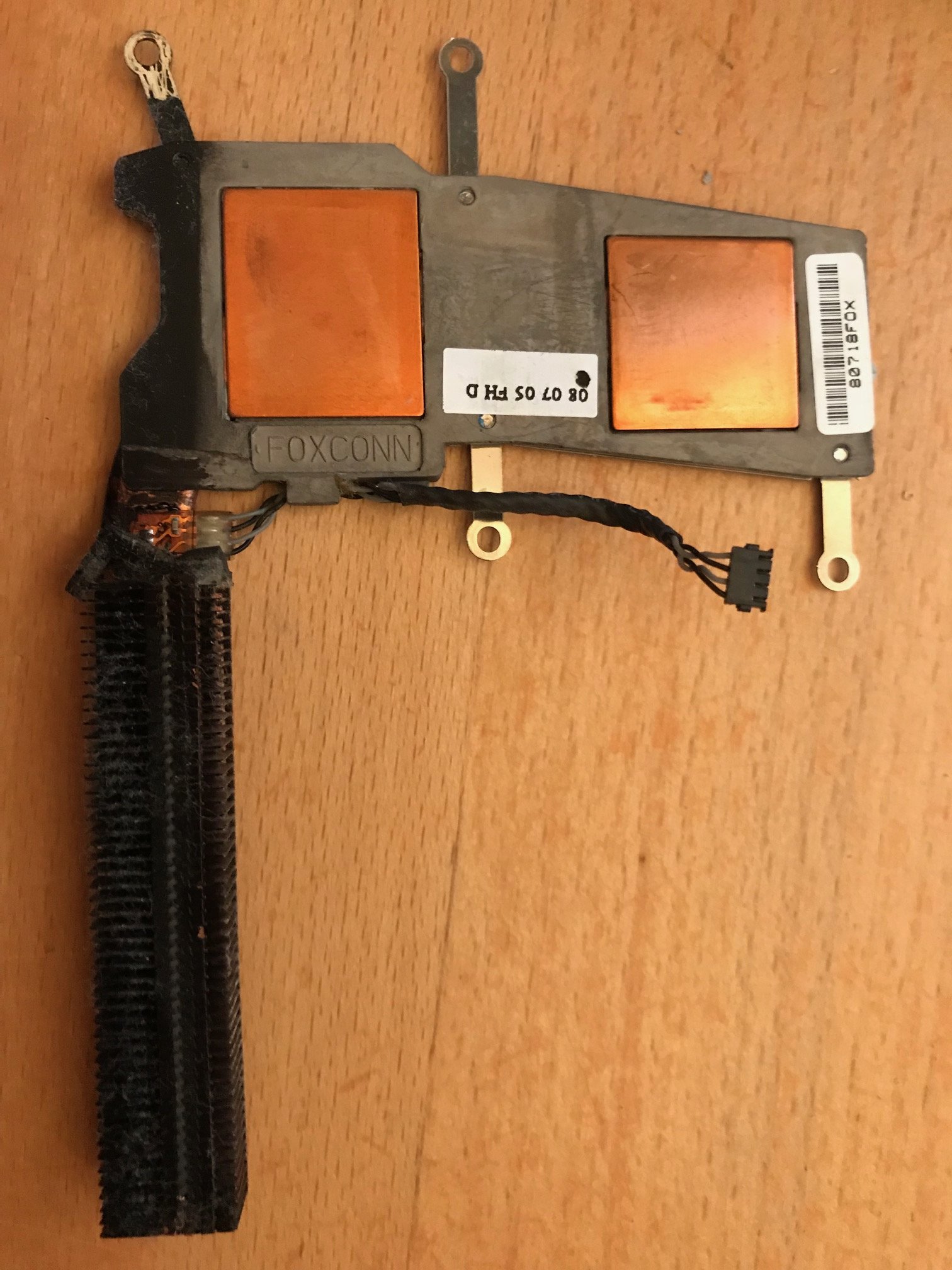

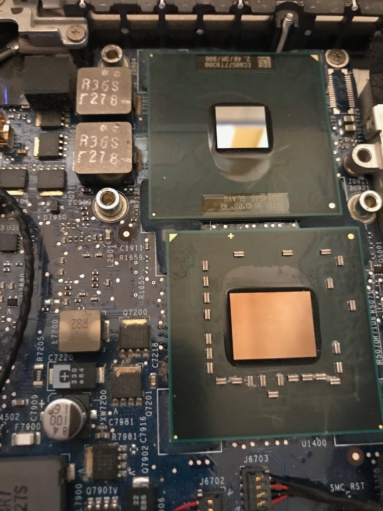

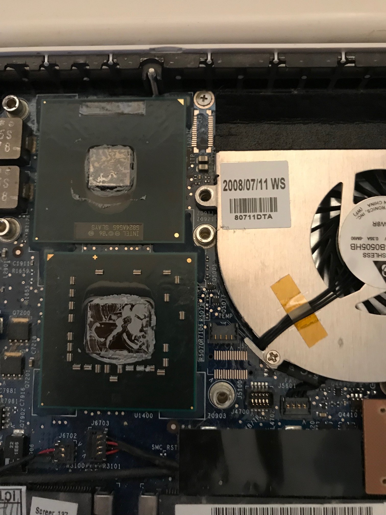

Holy crap! I was getting sick of the fan noise, so I decided to try this too. It took me about 1.5 hours to do it, start to finish, but it was most definitely worth it.
With Ubuntu 17.10, the Netflix 720p test video would ramp up the fan fairly quickly, and then it would stay there at max until I stopped playback. After the fix, which involved blowing the dust out the fan and heatsink and replacement of the decade old original thermal paste with my Arctic Silver thermal paste, also from my over a decade ago, I can now play the 720p video back for quite some time before the fan ramps up, and that's with 70% CPU usage. The fan ramps down quicker too.
I couldn't get the heatsink out without loosening the fan first. And the tape connecting the two had to be replaced too. I also took out that sponge bumper and left it out since it lost its stickiness.
There was a LOT of thermal paste there, and it not only did it look like cheap silicone stuff, it had lost its smooth consistency. It partially came out in soft chunks. The heatsink itself is partially copper, which is a pleasant surprise.
This machine is much more pleasant to use now.

The problem was that Apple (or at least the OEM manufacturer that Apple employed -- Foxconn most likely?) (a) used a cheap low-grade thermal paste, and (b) used far too much of it. This apparently was an issue endemic to other laptop brands, especially Dell and HP. In fact, some companies like HP and Lenovo were even worse in that they used adhesive thermal pads instead of thermal paste, which makes replacement far more difficult.
After 8 years, the thermal pad came off pretty easily for my AMD Athlon II X3 435 2.9 GHz triple-core CPU. I replaced that CPU with an AMD Phenom II X6 1055T 2.8 GHz hex-core CPU, and reused the same heatsink. Despite having twice the performance (with the same TDP), if anything the machine runs cooler now with a nice thin layer of paste from the same > decade old tube of Arctic Silver that I used for the MacBook.
That Arctic silver paste coming out of the tube looks the same as it did ten years ago.
BTW, yes it was Foxconn. That name is stamped on my 2008 MacBook's heatsink. (See pix above.)

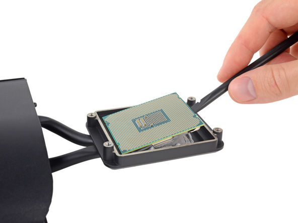

They still use Foxconn now (among others), BTW. It looks like they still use a lot of thermal paste still too, which isn't a surprise, since that's pretty much par for the course in the industry it seems. Here is a picture from a 2017 21.5" iMac:
https://www.ifixit.com/Teardown/iMac+Intel+21.5-Inch+Retina+4K+Display+2017+Teardown/92170
Same goes for the iMac Pro:
https://www.ifixit.com/Teardown/iMac+Pro+Teardown/101807
The goop they use looks pretty much the same as what I had in my 2008 MacBook.

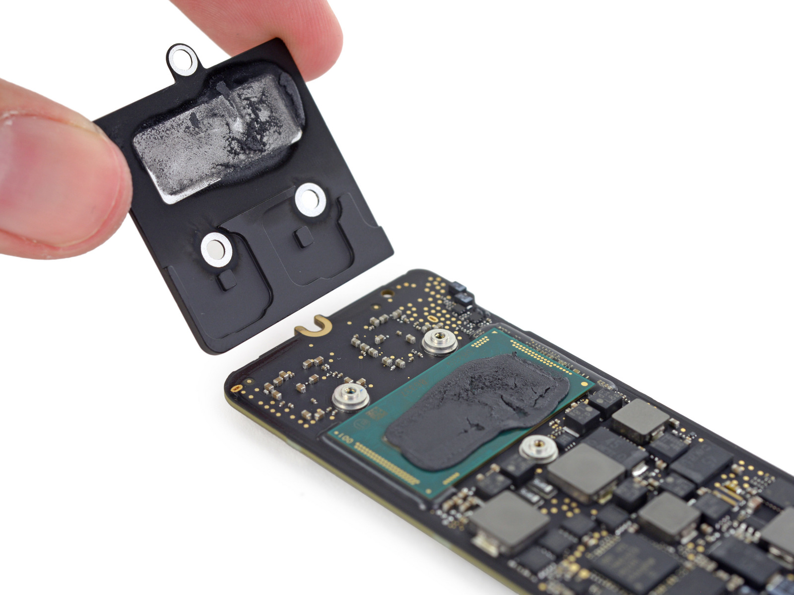

Meanwhile, my 2017 MacBook is fanless and seems to do well enough for heat dissipation. It turns out the thermal paste application is similarly sloppy though unfortunately, although it might be a different, darker colour. Here is the 2015 MacBook teardown:
https://www.ifixit.com/Teardown/Retina+MacBook+2015+Teardown/39841
One wonders what it will be like in 10 years.
