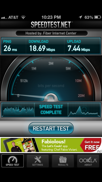

How are people "testing" the speeds of wifi?
It seems, as I reported earlier, that some apps are not accurate. (wifi disconnections on the other hand are different).
I use Speedtest.net app.
If I use a local server, I get 6 MB down, and 2.75 up.
If I change that server in the app to another state nearby, I get 21 MB down, and 3.5 up.
It seems (and I am only speculating), that the actual application you all are using may be a part of this puzzle.
This btw, is going without changing any DNS settings, or proxy settings or the like within the wifi settings on IP5.
So, I recommend that those who are indeed dealing with slower speeds on wifi, check out another application in the app store and do some comparisons. However, I do not know why one server nearby shows good speeds on the 4S yet poor speeds on my 5.
