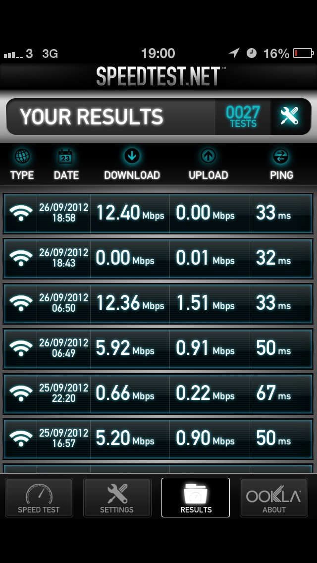

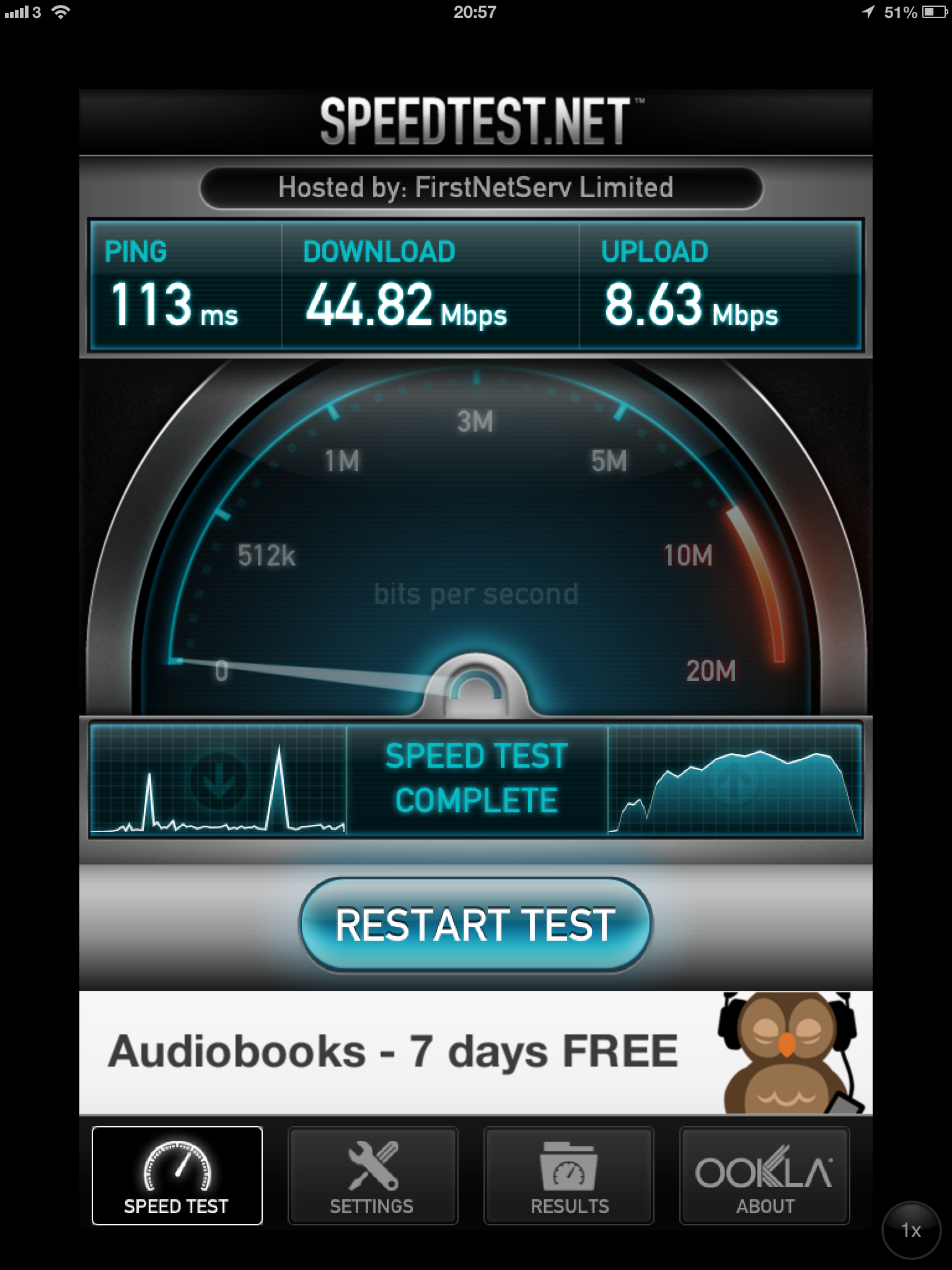

I've found the same issue tonight. I can get less than 1Mbps down on the iPhone 5 but the iPad 3 next to it is getting over 40Mbps down. Both devices on iOS6. I've tried on 2.4GHz and 5GHz networks and with WPA on and no encryption. My wifi is a 2TB Time Capsule.
