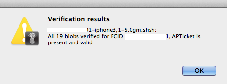

Here is the output from redsn0w
I have the tickets. Pulled em off the device with redsn0w.

I did this as a test with my iphone 4 with 5.0 long after the window was closed. And put 5.0.1 on with the same method (since I would have to restore with this file in the future, i might as well see if it works now and is fully compatible with the JB vs a stock install then JB)
You've done, to the best of what I can tell by your responses, what I did to make mine. The only diff, is mine isn't verizon, its att.

It's in the extras area and as I said, I have not seen any tutorials outlining it, which is why I took the time to share what I've done as it took a lot of trial and error to get it working. I had to restore to stock a few times and try different things to get from 5.0.1 back to 5.0.(the day corona was released, so well after the signing window) But wanted to test it during the 5.0.1 signing window to have had done it. Pull em from your phone and then run the verify, you'll see em. Also, not only that, tiny umbrella was also updated to support APTickets as well. You can use redsn0w to verify and stitch each one. That's why I suggested he get both, since tiny gets it from Apple, and redsn0w pulls it from the device.
I get the same response from redsn0w when I verify the blobs from my phone.
