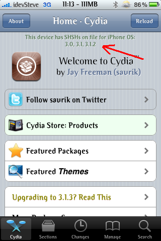

It's too late to store your 3.1.2 ECID SHSH. The way it works is that Saurik's server sends the signature request to Apple's server and then caches the response so it can pretend to be Apple's server at a later date. Only Apple's servers can generate the ECID SHSH, so you have to get your hashes cached before Apple stops signing a particular version of the firmware. If the main page of Cydia doesn't already say "This device has SHSHs on file for iPhone OS: ... 3.1.2" then it's too late for this version.

This is what you are looking for after you launch Cydia.
