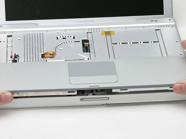

There is a clip in the top case just at the corner of the optical drive slot.
Looks like when dropped, the clip popped out. I had one close to the same location make it buldge out when it popped out of the clip.
It might be worth taking the top case screws out and pulling up that side to see if you can get the clip back in. That would keep it straight.
See the iFixit guide to the upper case. You can see the clips here.
eX3NTxyYCmFQrdmL.medium
Also with the top case removed it will be easier to bend that section right above the battery back out.
Thanks. I've got it fixed, the dent is only a millimeter off from the curve. Perhaps, I will try your suggestion when I open the machine to upgrade it.
