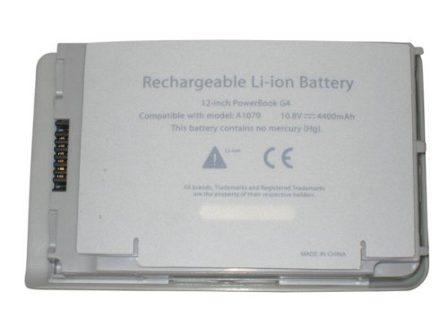

So I just purchased the exact battery you linked to, and it came in today. The top isn't real metal, it is plastic, and it's a hard fit, honestly. I think I found out why though, the new battery has two little plastic tabs on two of the sides, that appear to help hold it in. The other battery I have doesn't have those, and it fits a lot better. I'm wondering if it isn't alright to just shave them off, I think it would fit better.

That's unfortunate! Though I am unsure what the policies for Amazon to reimburse buyers are. For $16 or so with shipping in the US, it's not bad and still cheaper than eBay. But still a disappointment that they used plastics. Do they at least look like metal (silver paint) or are they white?
Perhaps if you dab a bit of superglue after removing the tabs, the casing of the battery shouldn't open up. But it's risky, is there any other area that the casing is sealed from (for support)?

It's very hard to tell in the stock image given on the site:
The plastic is painted silver, it's not too far off from the PB. You can't really tell it's plastic until you feel it. It claims to be 5200 mAh but I somehow doubt it, I will check with coconut battery as soon as I am given the chance. I don't think the tabs secure the battery top on at all, they just help hold it into the PB is my guess.

Alright, thanks Intell! Will that help it stay in better? Coconut battery tells me the battery holds only 4200 mAh like the OEM battery, so I don't know why it says 5400 mAh on the battery itself.
A slight warning, I'm not sure if the non-OEM battery's cover will match up with the OEM cover. So only do that if you intend on keeping the battery as it may not be reversible on the non-OEM battery.

EDIT: So cutting off the plastic tabs on the side of the battery didn't help much, it appears the battery is just very slightly taller than the original one.

Be warned it won't fit properly. It looks like it should, but it slightly pushes up on the right palmrest, and it's hard to get in. I measured it and it seems to be a couple millimeters taller than the original battery. It does work though!
