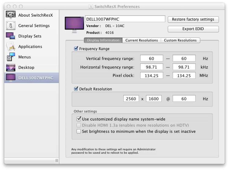

I resorted to SwitchResX, which managed to successfully set the 3007WFP back to 2560x1600.

I've been trying to get it to work as well, but can't find settings in SwitchResX that are valid for the 3007WFP-hc. Can one of you that got it working tell me the settings to use to make it work?
EDIT: figured it out. Here are the settings I used (from dell's specs), for anyone else it could help.
I just hit 2560x1600 @ 60hz. The following screenshot isn't for a 3007WFP, but it works the same:
Pretty straight forward:
- Open SwitchResX pane in System Preferences.
- Make sure the Daemon is running (see the bottom of the About SwitchResX tab)
- Select the Dell3007 tab (which should show up in the left column of tabs)
- Select Current Resolutions tab
- Check the radio button fro 2560 x 1600
And you should be good to go.

wish this worked for me, but I had to manually enter the settings above in order for SwitchResX to show me 2560x1600 as an option :confused:
