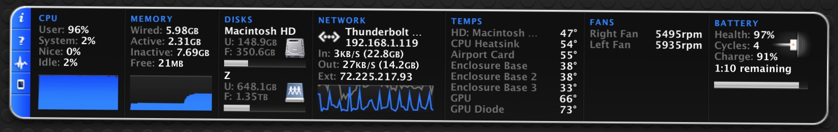

What were you temperatures afterwards? I can't get my CPU [2.7GHz] past 58° while all "8" (4+4) cores are at 100%, so I didn't even bother to change the thermal paste like I did with my last MacBook Pro [Core 2 Duo @ 2.8 GHz, from 106° down to 87°].

I'm not sure. The machine gets warm, but not really hot (nothing like my 2.8GHz mid 2009 MBP). I'm using iStat Pro to get the temps. I don't know if its accurate, but I think it is because it won't get hot.
I was going to change the thermal paste when I first got it, but I wanted to test it out first. When I saw the unusually low temperatures, I decided not to bother. But if I could lower the GPU temps by 10c or more, I might open it up.
Here's a pic of iStat, the CPU is under max load for about 10 minutes. The GPU gets much hotter than the CPU.

That's the heatsink reading, not the cpu diode reading. The cpu diode could be +20 degrees from the heatsink when under load.
