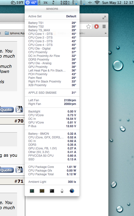

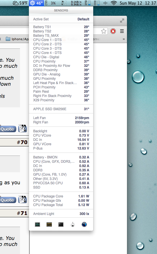

2.4 ghz is where I am at.
I have my TB display hooked up to my machine about 99 percent of the time, it's really a desktop replacement - with travel capabilities for work.
It's still early since I just did it last night to know full benefits.. but so far this is what I am seeing.
23.8C as my ambient temp.
Nvidia Discrete engaged to power TB display - which is always on and adds heat to the equation.
I do have the laptop open - but macbook display is OFF using the magnet technique.
Im finding under "average" load - Few tabs open in chrome, few finder windows open, VLC idle, skype running idle, activity monitor open, CPU is averaging about 3-5% usage.
Im getting a steady 43-47C CPU measured at the CPU Die using istat pro. This is down from about 53-58C before the paste switch. Fans are at 2k'ish.
GPU at this same load is steady at 39C measured at the die also.
