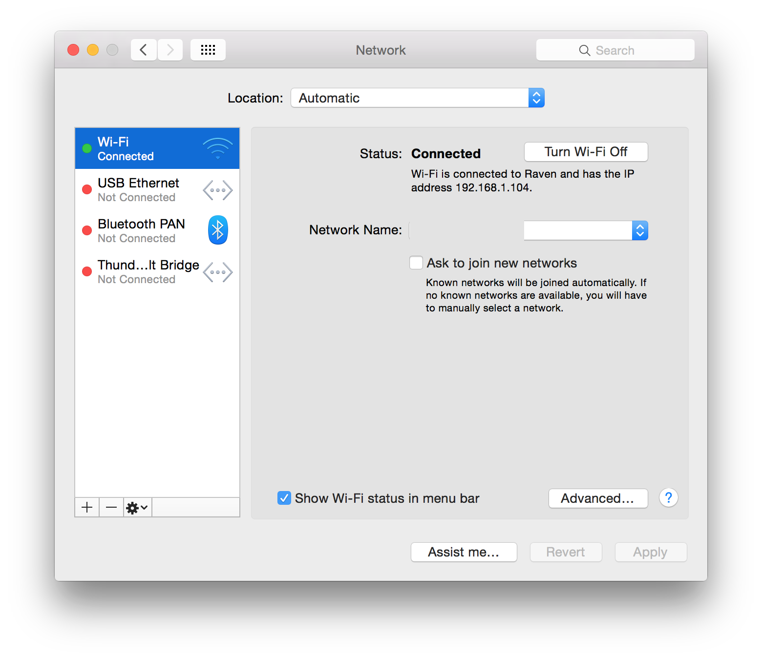

If the WiFi does not drop when in sleep without the monitor connected it`s likely a separate issue. For this there are endless guides. First I would goto System Preferences - Network delete WI-Fi (- box) Shutdown, boot into Safe Mode (can't hurt and clears out old caches etc.), reboot and reestablish Wi-Fi
Also note not all Mac`s play well with all routers, which can be frustrating, as no matter what you do there is no apparent solution. I recently had issue on a business trip with my 13" rMBP connecting to the hotel WiFi, however steadfastly refusing to connect to mail, internet etc. Solution was to use my Huawei MiFi (portable router) as a repeater, result perfect connection. This can only be attributable to hardware incompatibility between the hotel router & the rMBP`s wireless card. On that subject recommend you try a different router before (family, work, public etc.) prior to changing anything in the system.
