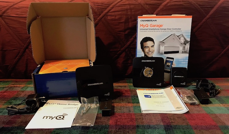

Back in January at CES, Chamberlain announced plans to release MyQ Home Bridge, a hardware hub to allow connected garage openers in the company's MyQ ecosystem to work with HomeKit. The MyQ Home Bridge was initially scheduled to launch in April, but as is common with these types of products needing to gain HomeKit certification, it was pushed back a bit and had a brief quiet launch earlier this month with an official launch coming just yesterday.
The MyQ Home Bridge requires that your existing garage door opener already support MyQ wireless connectivity through one of three methods: built-in MyQ Wi-Fi support within the opener, a non-smart garage door opener linked to a MyQ Garage hub, or add-on Wi-Fi connectivity for a MyQ-enabled opener using a MyQ Internet Gateway.
Box contents of MyQ Home Bridge (left) and MyQ Garage (right)

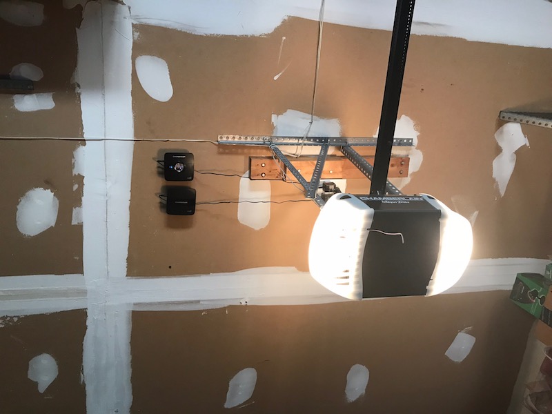

Working with my current dumb garage door opener, the first step was to install the MyQ Garage to get my opener online. It was a simple, straightforward process that only took about 15 minutes. The system uses a couple of screws to attach a metal bracket to the ceiling in the general vicinity of the garage door opener, at least two feet away from the opener itself but still visible when standing in the garage door opening.
MyQ Garage bracket screwed to garage ceiling
The MyQ Garage slides onto the metal bracket and a power adapter plugs into an outlet, with excess cord able to be wrapped around the metal bracket.
MyQ Garage hub mounted on ceiling
A separate door sensor is affixed to the top panel of the garage door itself, with either velcro strips or screws. The simple sensor wirelessly informs the MyQ Garage hub whether the door is up or down, based on the sensor's orientation. It runs on a replaceable CR2450 button battery.

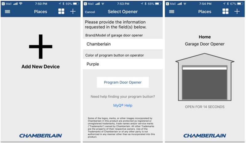

The rest of the setup happens within the Chamberlain MyQ app, which requires you to create a MyQ account and instructs you to connect to the MyQ Garage via Bluetooth to enable sharing of your device's Wi-Fi settings during setup. Once the MyQ Garage is online, the app walks you through the steps of pairing the MyQ garage with your opener through the opener's program button, tests the door sensor's communication with the main hub, and lets you name your opener in the MyQ system.
The app isn't particularly pretty and it hasn't even been fully optimized for recent larger-screened iPhones, but it gets the job done. It does support Touch ID, so it's easy to authenticate your MyQ account credentials whenever you open the app. The app lets you easily see your garage door opener(s) and their current status, as well as how long they've been open or closed for. Tapping on the door in the app will raise or lower it.

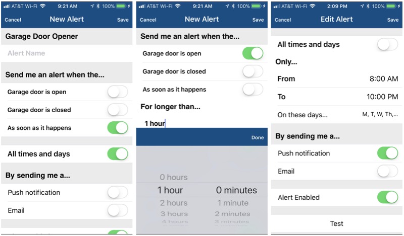

Alerts and Schedules
The Chamberlain MyQ app allows you to set up alerts and schedules for your garage door, making sure you're kept up to date on the status of your door and letting you automatically ensure the door is closed every night, for example.
With alerts, you can choose to receive them via push notifications, email, or both, and you can be alerted whenever your garage door is open or closed. Options allow you to specify only certain days and times during which you want to be alerted, as well as whether you want to be notified as soon as the event happens or after a certain time threshold is reached.
For example, you can set up an alert to be notified only if the garage door has been open for more than an hour. With multiple alerts, you can account for your daily schedule, such as setting up immediate alerts during the workday when no one is expected to be home, but only notifying after an hour or so at other days and times when people are more likely to be around the house.

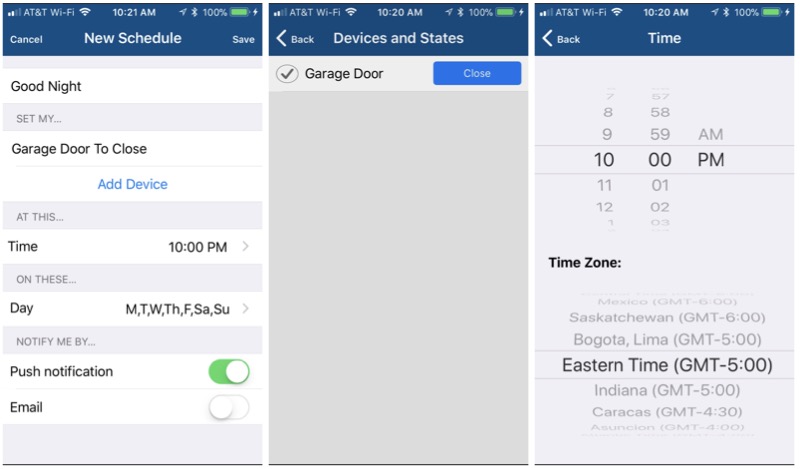

Schedules, as the name suggests, allow you to set up a fixed time of day (every day or only specific days of the week) to close the door, for example. For garage doors, only closing the door is supported, so you can't set the garage door to open on a specific schedule within the MyQ app.
If you have other devices such as remote lights integrated with your MyQ system, you can also schedule them to turn on or off. Even without HomeKit, schedules are a great way to automatically make sure your garage door is closed in the evenings before heading to bed, and you can receive confirmation via email or push notification.

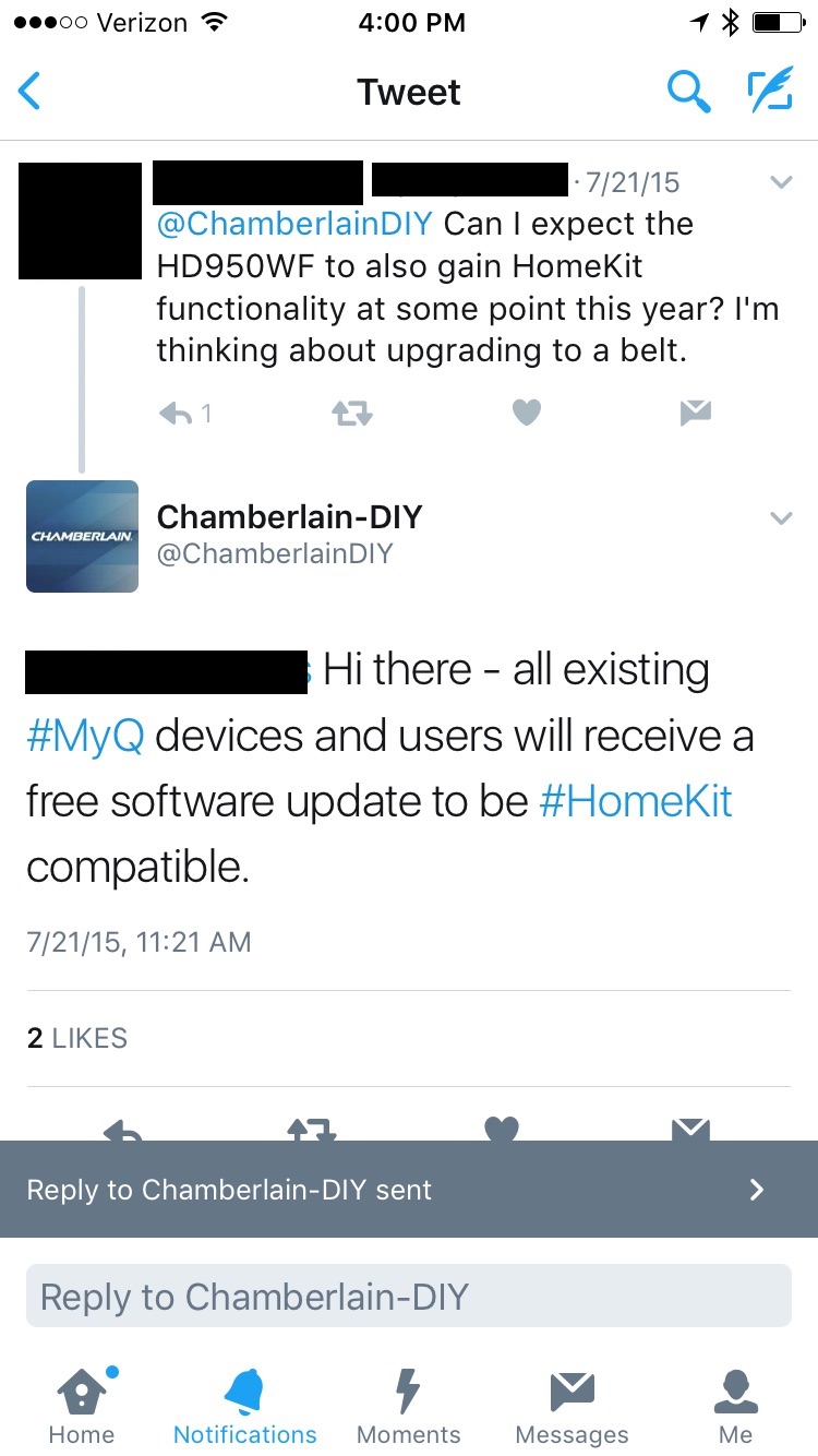

Screw Chamberlain. They announced HomeKit support a couple years ago and a "free upgrade" to current customers that bought the MyQ back then. When it was finally announced this year, Chamberlain said all customers have to buy new MyQ hardware and NO free upgrade. I won't spend another dime with them.
Here's the Facebook posts that they removed when they went back on their word:
https://myqcommunity.chamberlain.com/chamberlainmyq/topics/homekit-promises
https://myqcommunity.chamberlain.com/chamberlainmyq/topics/homekit-update-1-6-16
