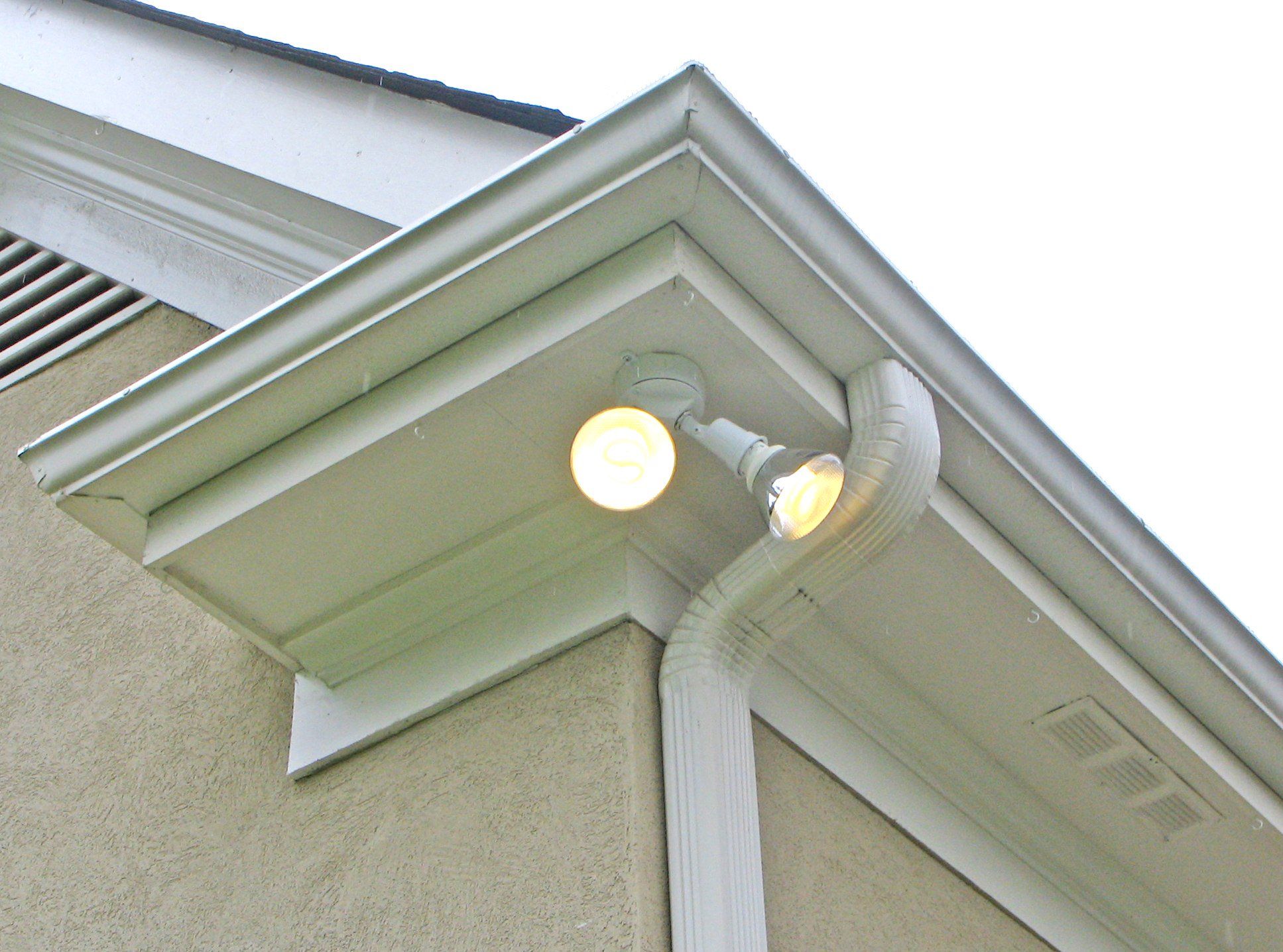

Lights that are intended to be "floodlights" are often mounted on the underside of a horizontal eave and not on a wall. So a lot of times, if you are replacing a light on a wall with something like this, you are eliminating a decorative or general-illumination sconce and not necessarily something that would've been pointing at your face and activated by motion.
It's the difference between replacing this:
And replacing this:

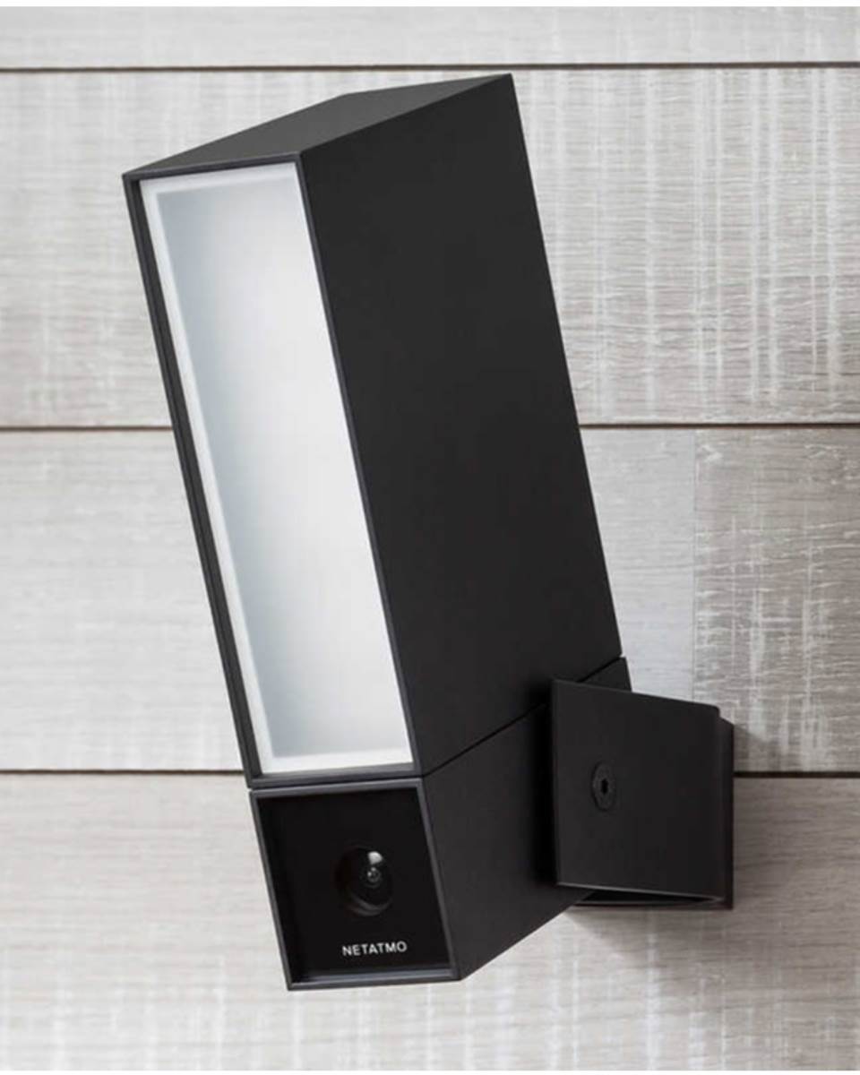

I like Eve and Netatmo. But functionality-wise, I’d opt for the Netatmo.
I have 4 Netatmo cameras which record to my NAS via FTP, which in turn is backed up to the cloud. I keep nine months of data. The cameras are flexible, as is the app. I use HomeKit to view in realtime and to turn on & off the spotlight as needed.

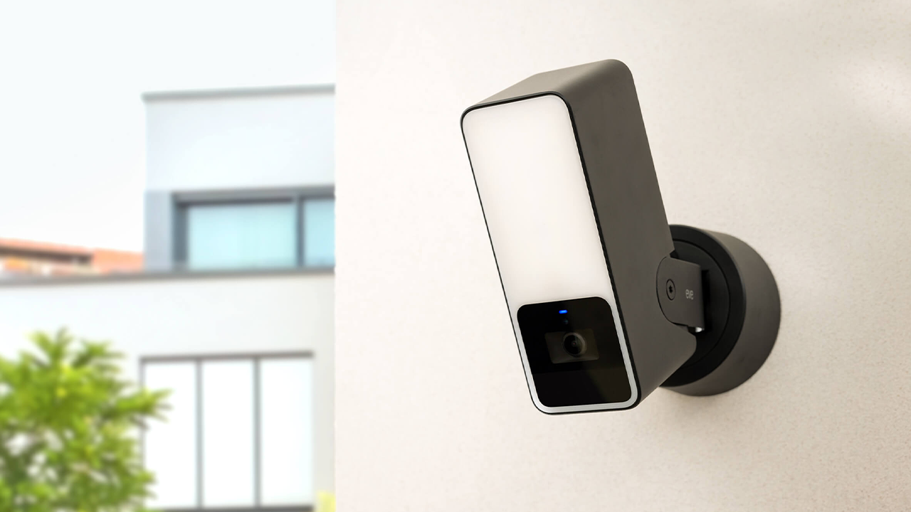

Eve back in May came out with the Eve Outdoor Floodlight camera, one of the only floodlight-enabled HomeKit Secure Video cameras that are on the market. I have been testing the camera for several months now to get a feel for how it works and whether it's worth investing in.
Part of the reason that this review has taken so long is because the Eve Camera has some installation caveats that potential buyers should be aware of. This is a wall-mounted floodlight camera, so it needs to replace either an outdoor light or an existing camera oriented in the same way, unless you're going to install a new electrical connection.

The Eve Outdoor Camera is one of the only HomeKit-enabled outdoor camera options that also has a light, so there isn't a lot to choose from if you've opted for the HomeKit Secure Video ecosystem. Luckily, the Eve Outdoor Camera is all around decent.
The camera looks sleek on the wall and it doesn't take up too much space for those who are looking for something subdued, but potential buyers should be aware of the installation issues and prepared for some headache getting the camera set up. It's also limited to 1080p and it can struggle a bit with high variation in light and dark, but it comes with unparalleled privacy.

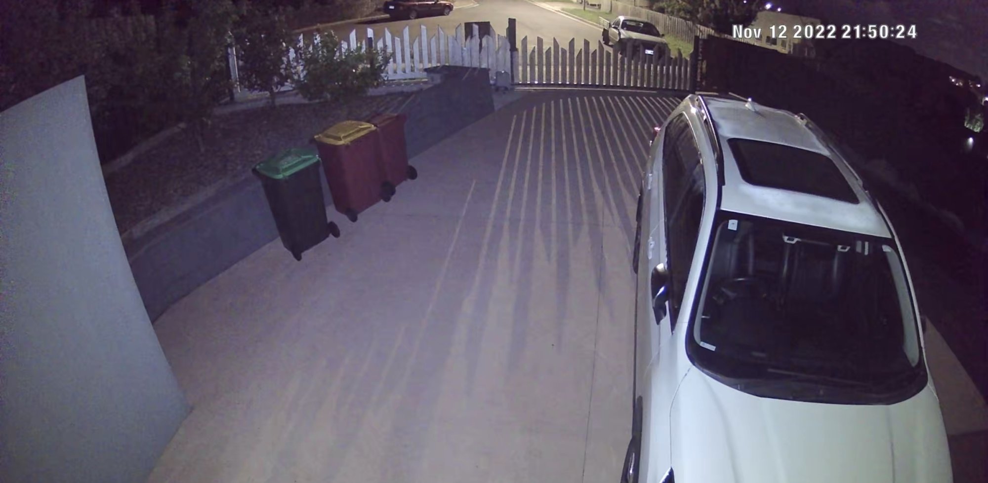

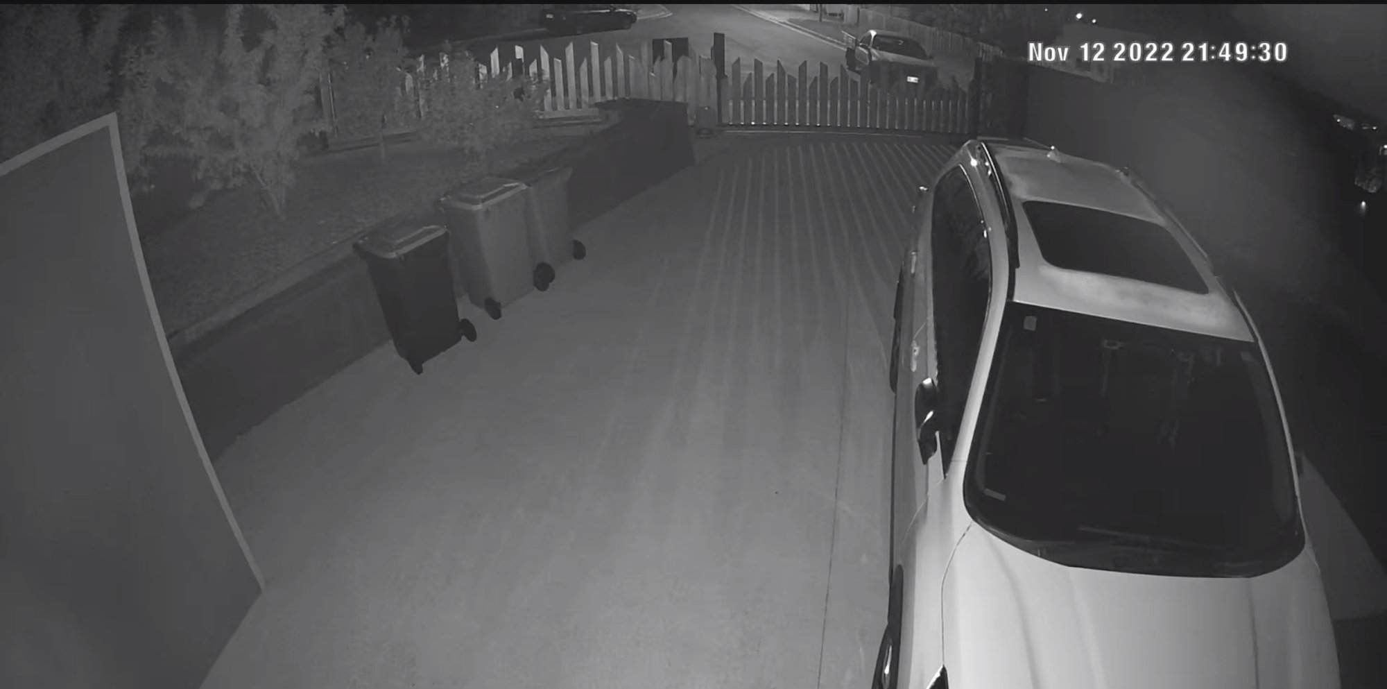

Yeah it’s the 2C Pro. Having used one for the best part of 9 Months, I’d definitely say it’s flood lights, rather than a spot light. I probably saw the same reviews as you.
The basis of night vision being 'better' is that it provides more contrast. And that is generally always going to be the same for black and white. When the light is turned on, it lights up pretty much everything you can see, and there is enough light to maintain a colour image.
The difference between flood light & spot light is obviously in the description of the name. The fact that it lights a large area, would indicate it’s a flood light rather than a spot, which does just that.
Sure some are more powerful flood lights, but this certainly does the job. Photos just now.

Thanks for the examples.
It definitely provides light for the recording, but not what a typical floodlight would do.
I think a telling part of the photos you sent is what looks like a street light which is pretty far away from the camera. The way the street light illuminates the area around it is what I would consider more of what a floodlight would accomplish.
With the shadows of the fence, you can see that the street light provides a lot of light for your camera as well. If you are in an area without the supplemental lighting, the little light on the 2C Pro would show I think. Maybe plenty of light to record close to the camera, but not the nearly the amount of light of the eufy's Floodlight Cam 2 Pro or other floodlight camera.
The point being, people looking for floodlight cameras are most likely wanting the area to be illuminated similarly to how the street light is in your photos.
I don't think the amount of light provided by the 2C Pro is the selling point, or even a main feature of it. For actual floodlight cameras, the light provided is the selling point. This is why the eufy advertises the amount of light provided on their floodlight cameras, but not their other outdoor cameras.
It's not as much to do with camera view as it is where the existing electrical boxes on the exterior of your house are.
And replacing this:

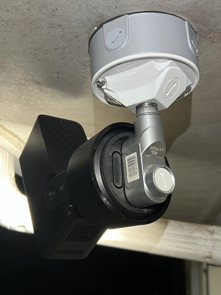

There have both horizontal and vertical mounted floodlights at my home. I got an Eve to replace one of the vertical mounts, but doing horizontal isn't impossible, and really isn't too difficult, it just requires some additional purchases at a hardware store.
This is an example of someone from Reddit:
A more ideal solution is to be able to mount it to a horizontal location right out of the box, but that I the problem with HomeKit Secure Video, there is hardly any options.
Yep, there's always a way - but I'd have to REALLY want that specific camera/light combo to go that far. 😀

In the photo example you had, the streetlight lit up everything, almost as if it was daylight out. The light provided by the 2C Pro looked like it was maybe on par with a 60-watt incandescent bulb.
My point is that there is a difference between a floodlight and a small light provided on the eufy 2C Pro. The small light on the 2C Pro cannot light up an area like even a cheap floodlight could.
A simple outdoor sconce light on a porch can illuminate an area, but it doesn't provide the amount of light that a floodlight can.
The light provides the ability to record in colour.
That may very well be. The light on my iPhone also provides the ability to record in color, but that doesn't make the light provided a floodlight.
I think you are just talking about the ability to record in color, and I am talking about the ability to illuminate an area.
I have a proper flood lights too.
Do they provide more light than the 2C Pro?

I agree, but then again other users are reporting that water somehow got into their Eve outdoor cameras. User error for sure as I've had 4 hooked up for months (that I installed and wired myself!) and they're still dry.
They make gaskets and gang box covers with seals for a reason...
