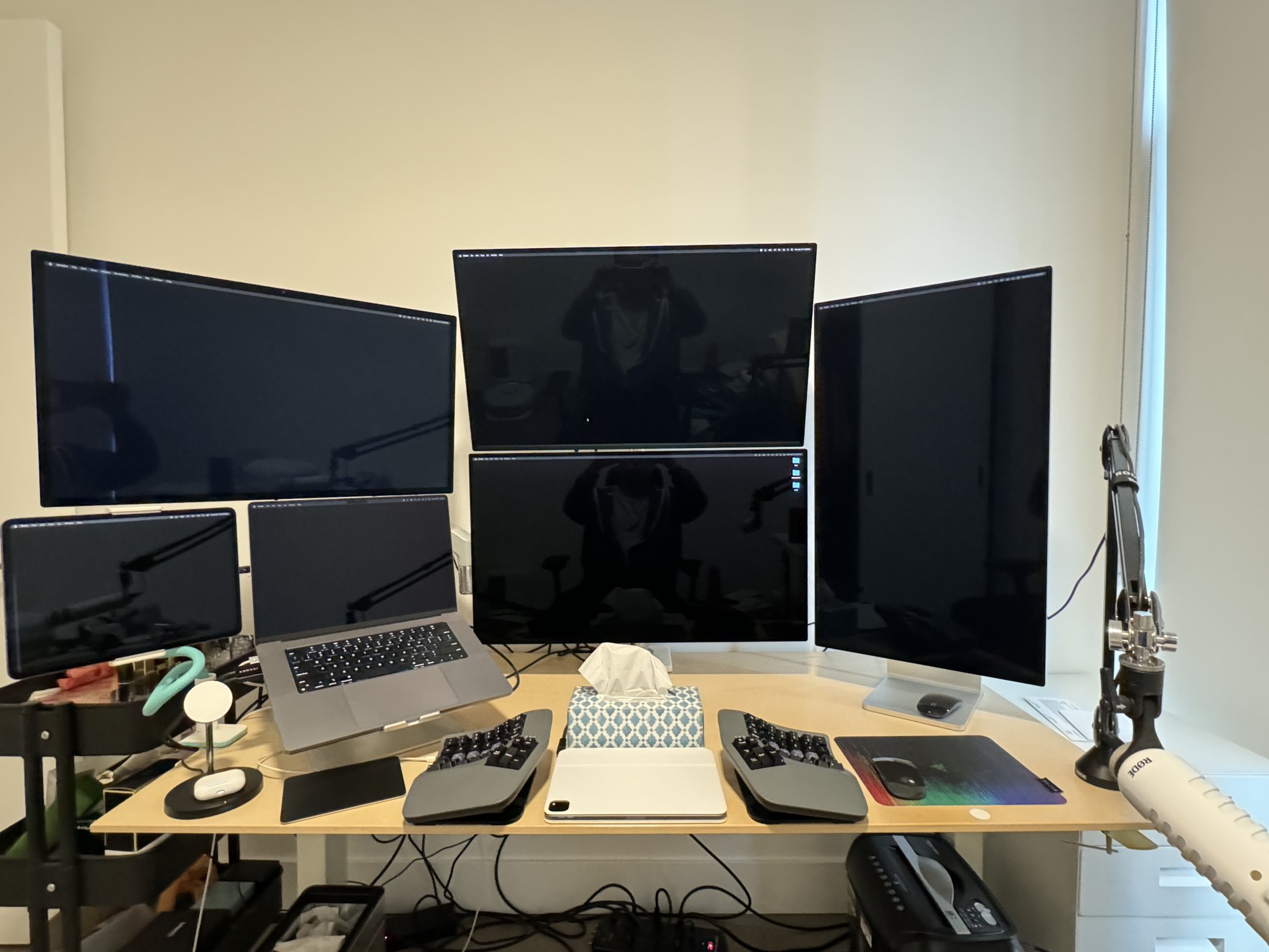

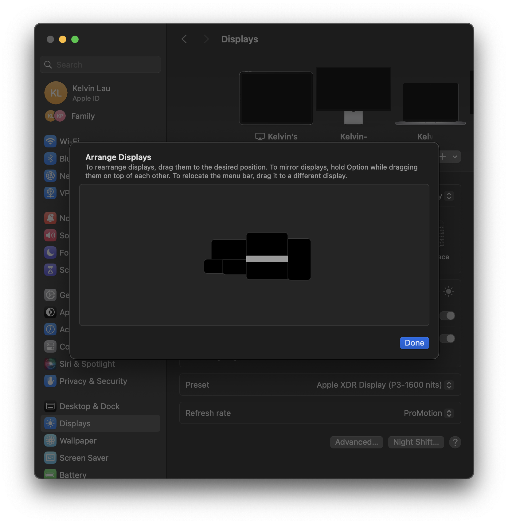

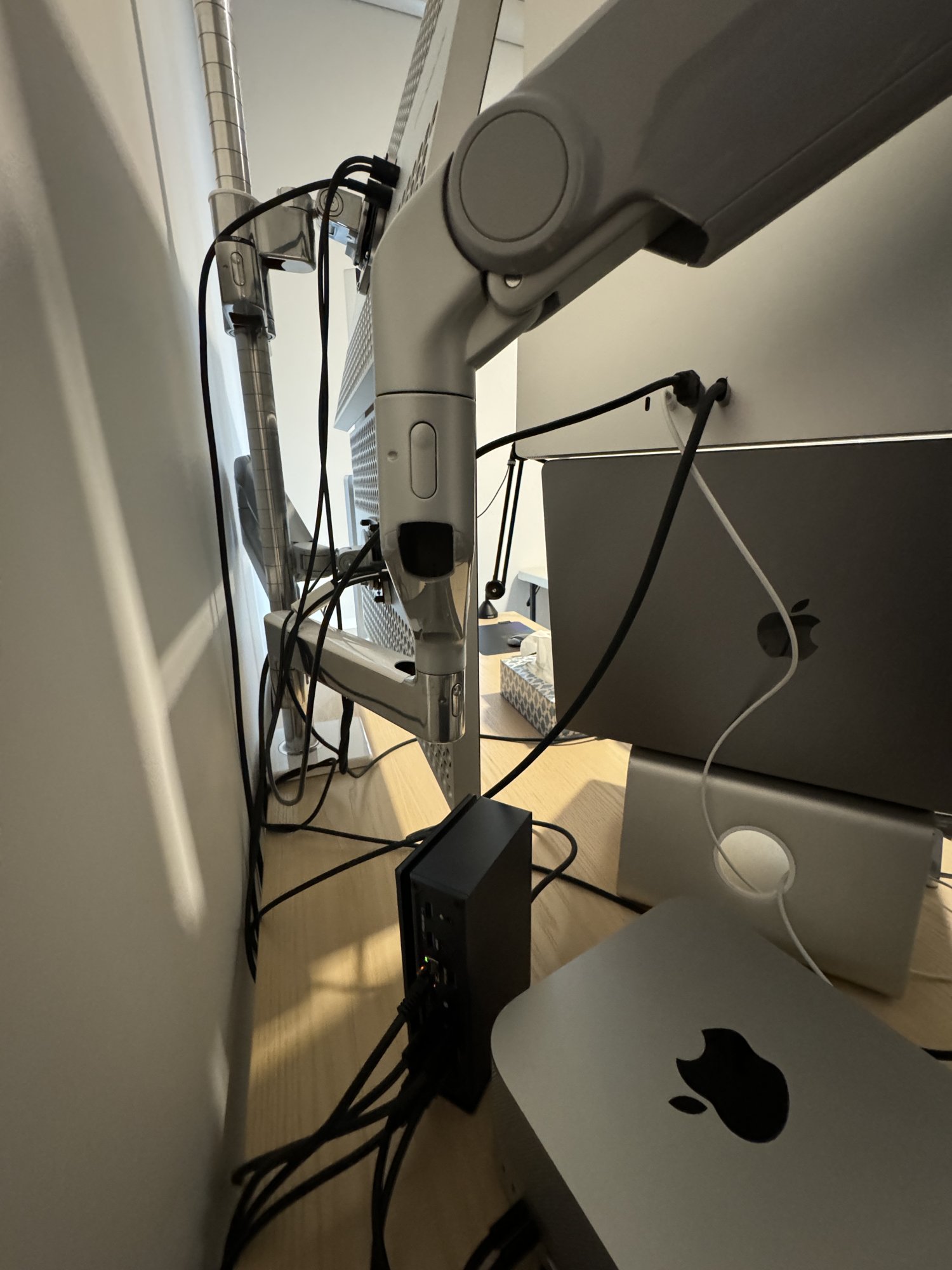

Got the dock a few months ago and it is awesome. With M1 Max, I can run 3XDR displays and a studio display flawlessly.
This was an upgrade compared to my previous setup:
1. Doubled my ethernet connection speed (ports on the XDR displays capped me at 500 mb/s). I could get this if I hooked it directly into MacBook, but my ports were fully utilized to power the XDRs already.
2. Enabled the ability to hook an Apple Studio display. Somehow the iVanky dock can enable the studio display at 5k, even though Apple advertises that M1Max can only support a fourth 4k monitor.
3. Freed up a USB-C port on the right.
4. Revived a malfunctioning XDR display.
Reviving the malfunctioning display was huge. After 4 years of ownership, one of my XDRs failed to boot up. The issue seems to have to do with the fact that MacBooks draw power from the display, and that interfered with the connection? (The faulty XDR works fine with my Mac Studio).
It is working fine with the iVanky dock, presumably because the dock doesn't draw power from the display.
I will say that the dock runs pretty hot. Hope that doesn't harm the lifespan of the dock. Overall very pleased

That desk setup looks wicked cool!
What do you do for work that requires five monitors plus the internal display? (Or is it four monitors, the internal display, and an iPad?)
