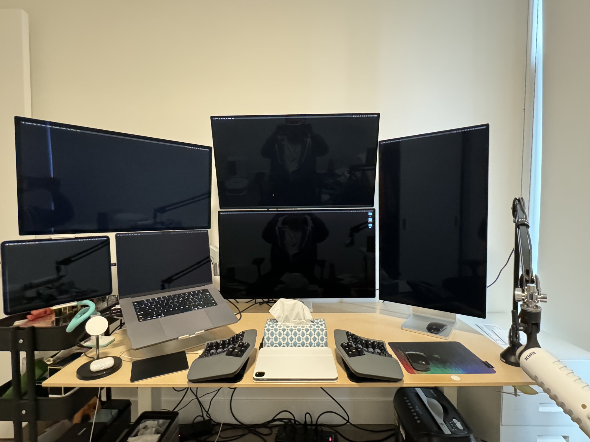

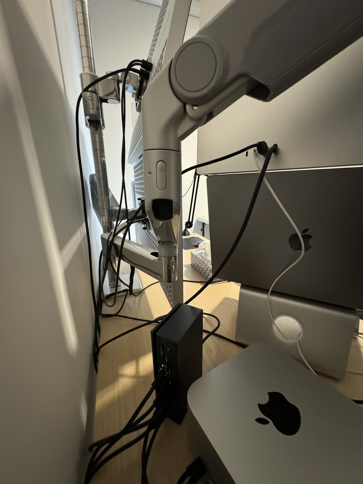

Got the dock a few months ago and it is awesome. With M1 Max, I can run 3XDR displays and a studio display flawlessly.
This was an upgrade compared to my previous setup:
1. Doubled my ethernet connection speed (ports on the XDR displays capped me at 500 mb/s). I could get this if I hooked it directly into MacBook, but my ports were fully utilized to power the XDRs already.
2. Enabled the ability to hook an Apple Studio display. Somehow the iVanky dock can enable the studio display at 5k, even though Apple advertises that M1Max can only support a fourth 4k monitor.
3. Freed up a USB-C port on the right.
4. Revived a malfunctioning XDR display.
Reviving the malfunctioning display was huge. After 4 years of ownership, one of my XDRs failed to boot up. The issue seems to have to do with the fact that MacBooks draw power from the display, and that interfered with the connection? (The faulty XDR works fine with my Mac Studio).
It is working fine with the iVanky dock, presumably because the dock doesn't draw power from the display.
I will say that the dock runs pretty hot. Hope that doesn't harm the lifespan of the dock. Overall very pleased

I have one of these, and it's solved several problems I was having with my docked 16 M3 Max Pro and 14 M3 Max Pro. I have a Studio Display, an LG 5K, and a Dell 4K screen plugged in. Before this dock I had two thunderbolt docks, but I'd have to have the LG plugged directly into the Mac, otherwise randomly one of the screens wouldn't wake up. Also, I was not getting great performance when a 10Gbe adapter was plugged into my old docks.
With this however, I've the two connections from the MBP and everything else plugged in to the Ivanky. So three screens and the 10Gbe. Everything works just fine, and all those waking/irritating problems have gone away.
I know screens take a lot of bandwidth, so I assume that's the issue I was running into before. With this setup however...it just works.
Apart from the cost - which was a little uncomfortable - it's solved my issues. Very happy with it so far.
I had very similar issues to yours. I too am using an LG 5k and unless that was plugged directly into the Mac, sometimes it wouldn't wake up. The iVanky hub fixed this issue. It also fixed an issue where randomly one of my three CF card readers wouldn't mount...previously I was using two different OWC docks daisy chained together and it was a nightmare. If you would breath on one of those devices items would disconnect randomly. OWC will never get another dime of my money.
