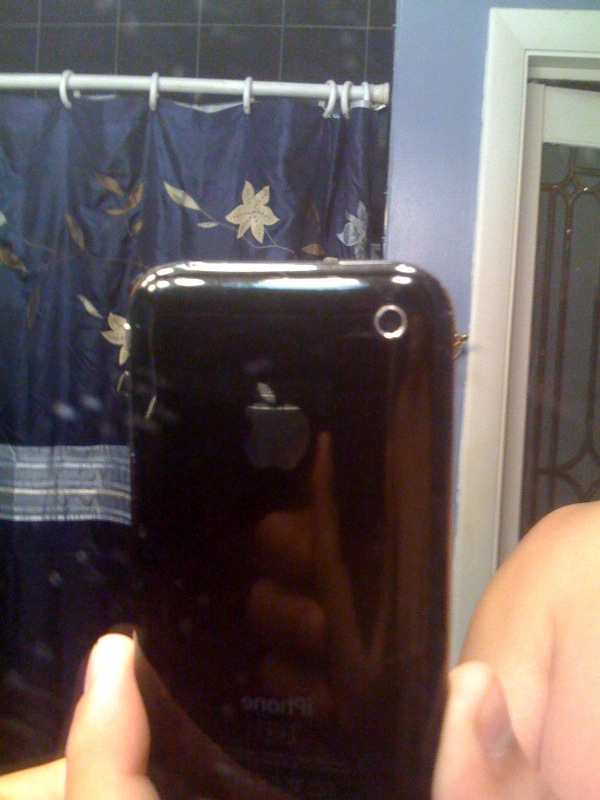

So i've let the iPhone sit for 13 hours, finally powered it on. There is still MINOR haze.. and a few bubbles.. quite small though. And my corners are nearly perfect. There is a 'hair' on the back, which is sorta annoying but if my phone is scratch proof im cool with that. The bezel like I mentioned ealrier has some fibers underneath it too, but no big deal..
I don't have a digital cam handy so i took a pic in a mirror with the iPhone, hopefully its clear enough to give you an idea. The back is nearly flawless you really can barely tell its on only cause the haze.. im sure in 24 hours it will look awesome.

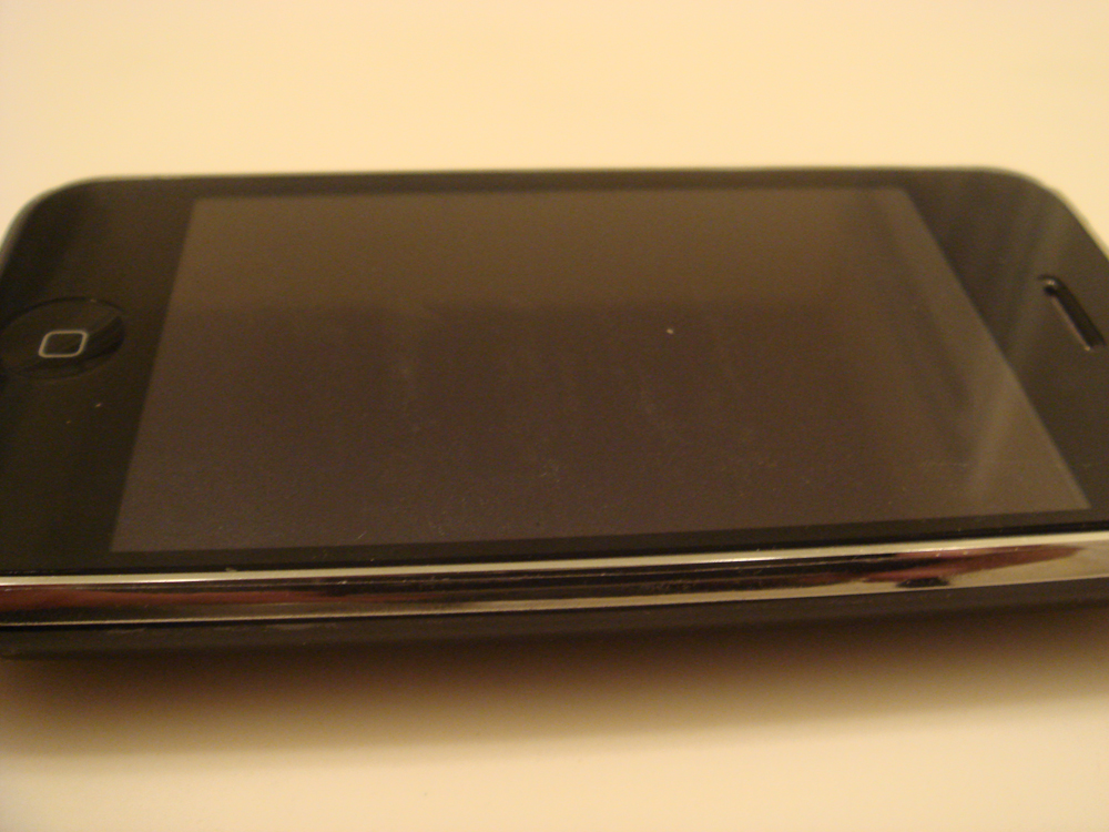

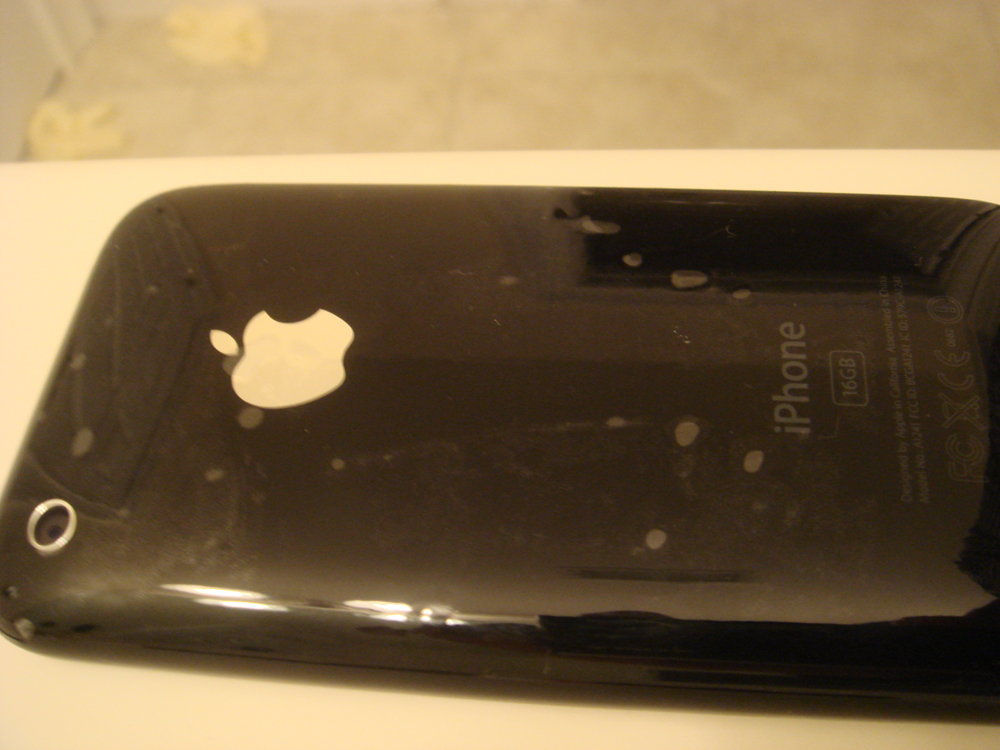

Now i DO have several air bubbles on the back and streak marks on the front so im gonna wait for this whole "curing" witchcraft to do its thing before posting pictures and going too heavy with any praise/insults.
Regards of how that works out let me say that this isnt for the feint of heart or the weak of stomach. IT will require incredible amounts of patience and incredible amounts of you spraying tons of liquid over your two to three hundred dollar iphone. If you are missing either component save yourself some money and dont do this.
One comment i can make on the whole IS vs BG is that i found the bodyguards adhearing to the phone much more quickly than the IS i installed for my brother. Even with insane amounts of spray it would almost instantly start sticking to a point and only after forcing it to slide around alot was a able to align it properly.
I didnt find the same issue to be as bad on the IS but the famous orange peel effect on the BG is next to nothing compared to the fruit my bro refers to his iphone so im still happier i went with this one.....so far.
Also make sure to triple check your front before moving on to the back. I looked mine over a million times and found no problems then after finally finishing the back and thinking i was done i looked and saw a fairly noticeable hear stuck underneath the front. Knowing myself i knew it would drive me insane so i carefully lifted up the side of the front it was under, removed it, and resparyed and reapplied that side. Didnt streach or anything so i was relived.
Ill post a couple of photos of it now and then take some more in a day or two so we can find out together if these bubbles do really disappear on their own.
Some pics, help me pray for the back to get better, front already seems better then when i finished.

Well I can say that after one night the front already looks perfect while the back is definitely making progress. Less air bubbles already and the only remaining ones are noticeably smaller.
