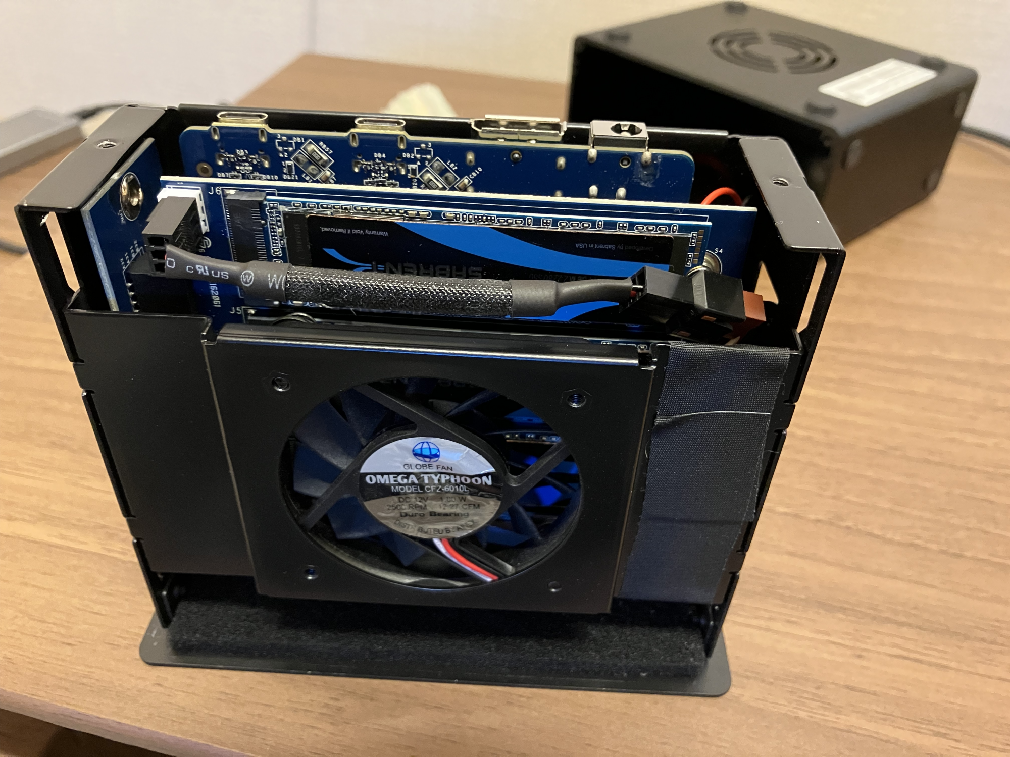

I solved that problem, actually. Yes, the connector on the mini is proprietary. I replaced the fan with a Noctua with the low noise adapter, which thus has the standard connector coming out the grille into a USB cable which is then plugged in (either to the computer or wall, depending on your preference). Sounds a bit messy, but it's just one extra cable coming out the back of the mini and solves the awful noise problem. Been running two of them like this for years.
Reactions: Traverse
Interesting. Would you be willing to post an image here or DM me? I don't have a fan handy, but I feel like if I tried to run the cable out of the back then you couldn't probably affix the fan to the back of the device - that it only screwed it in with the cable kept internal. Or did you leave off the back covers?

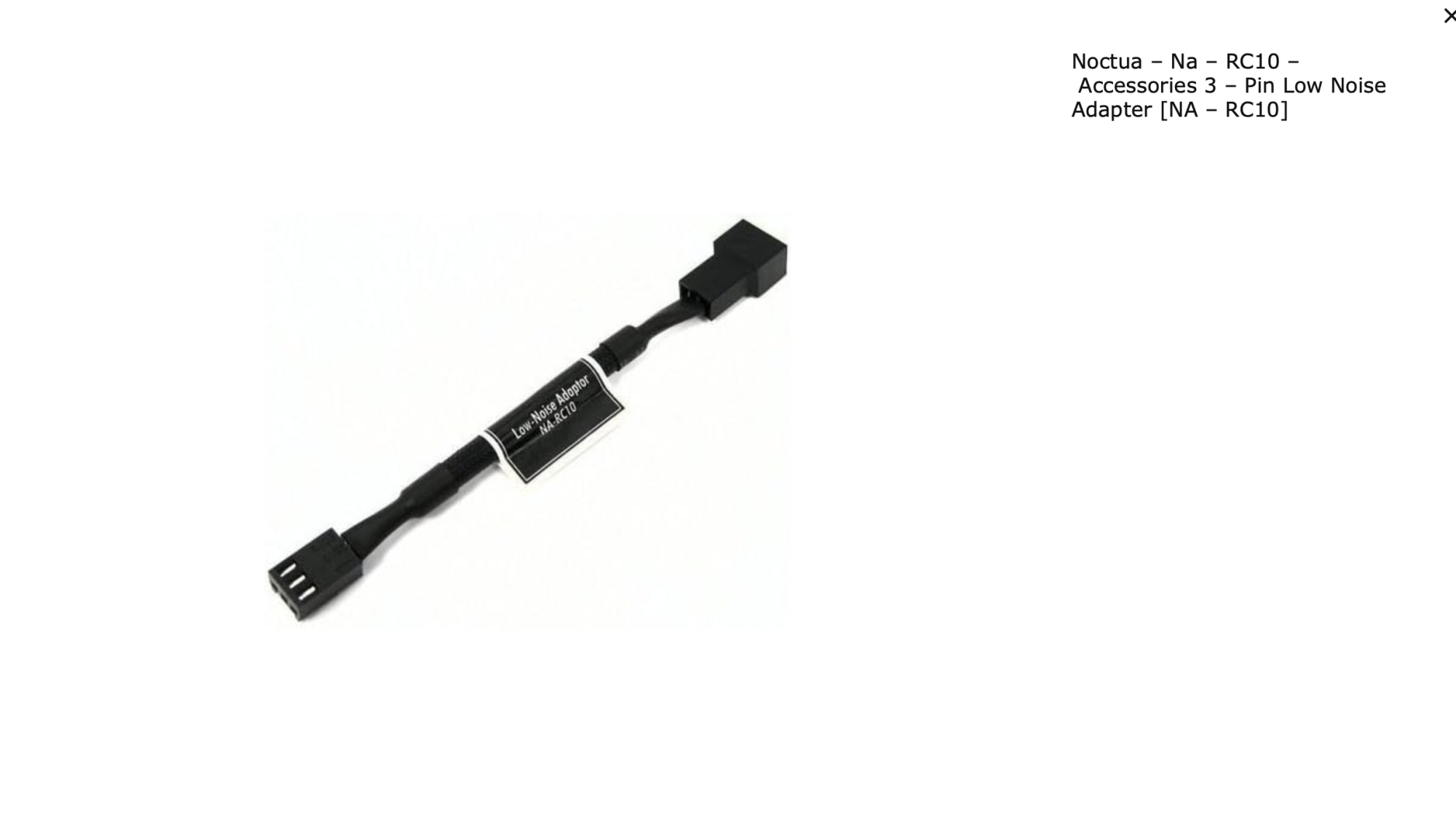

This is all you need. Cuts the fan speed down to quiet. Just slight air blowing through the unit. If you have SSDs that are generally low in heat, then this will do.
I had someone on this forum say that you really don't even need the fan, but I got this instead and cuts the jet engine fan OWC put in it down to quiet (probably they put it in to save costs). I don't see any difference in speeds or thermal throttling etc. Works great.
Noctua – Na – RC10 – Accessories 3 – Pin Low Noise Adapter [NA – RC10]
OWC use to put Nactura fans in their units, but I guess they want to make more $ profits.
(see attached picture)

It's simple. You pick up a Noctua fan with the low noise adapter, and then this cable (or whatever alternative. I use this one specifically). This supports two fans, of course, and you plug this into a dual port USB charger if using two Thunderbays or a computer etc. All you're doing is installing the Noctua fan in the exact place the original was, and then running the cable outside the case to this USB cable:
Here's the cable:
And here's the fan with the low noise adapters:
You remove the fan grille on the back of the mini (just 4 screws as I recall) so that the cable can come out through it. Then you put the grille back on. The whole process of installing should only take a couple of minutes
