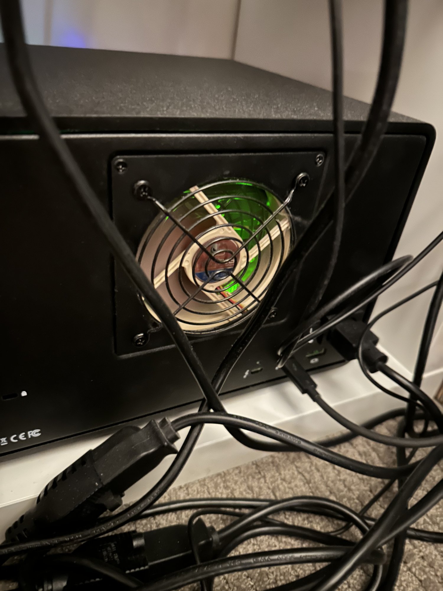

(see attached picture)
I took off the case so it can be seen that the Low Noise Adapter can fit in the enclosure. After adding the Low Noise Adapter, I put back on the Enclosure case and it is good to go as if the Low Noise Adapter came with it.

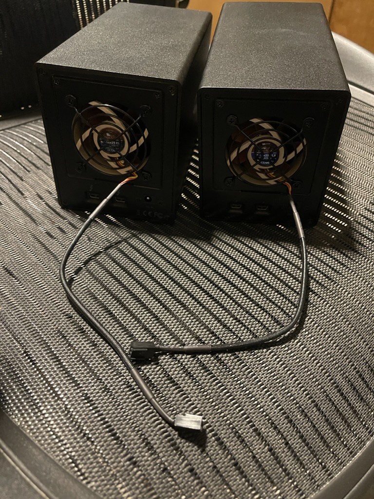

It's simple. You pick up a Noctua fan with the low noise adapter, and then this cable (or whatever alternative. I use this one specifically). This supports two fans, of course, and you plug this into a dual port USB charger if using two Thunderbays or a computer etc. All you're doing is installing the Noctua fan in the exact place the original was, and then running the cable outside the case to this USB cable:
Here's the cable:
And here's the fan with the low noise adapters:
You remove the fan grille on the back of the mini (just 4 screws as I recall) so that the cable can come out through it. Then you put the grille back on. The whole process of installing should only take a couple of minutes

That did not work for me because of the non-standard connector on my mini. Your mini is perhaps different. Anyway, the fan I linked above worked for me in both my minis, but, as mentioned, I run the connector outside the mini to a USB plug (any iPhone plug will work etc).

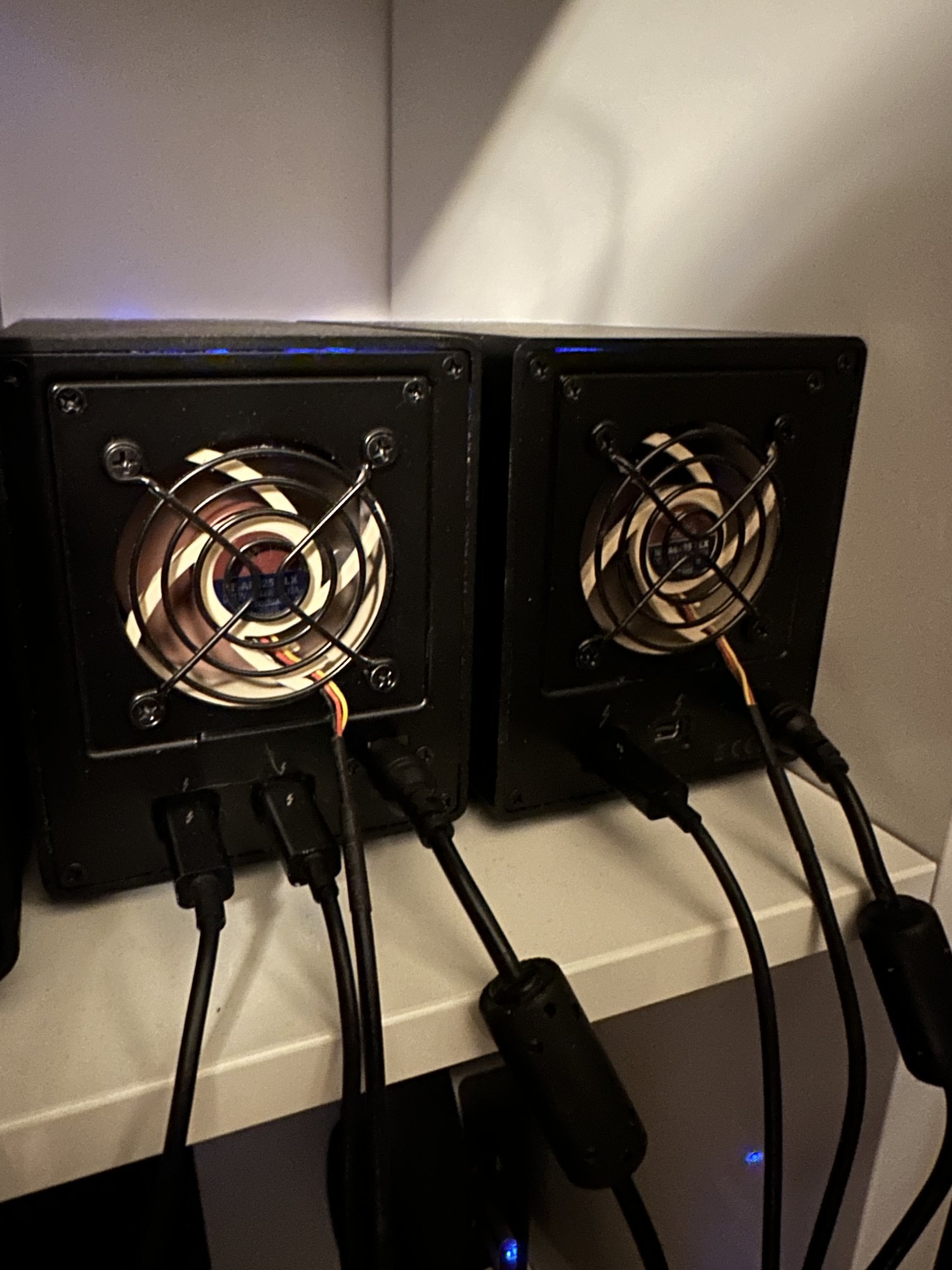

I found a picture from way back when when I set this up the first time.
I see - thank you. This is what I was picturing. I have the Noctua fan now and I tested the ultra-low noise adapter and it does indeed essentially eliminate fan noise where I'll have this and given that I was originally running the OWC with no fan this can only help. I'm putting off getting it back out (temporary moved to an OWC bus-powered dual drive) until I can get myself to pull the trigger on two more Samsung 8TB SSD which are pretty low on Amazon right now.
